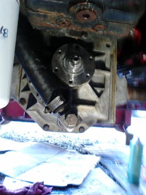

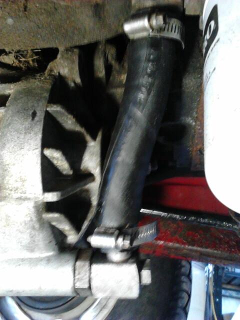

What does the hose that runs to the hydrostat filter from the drain plug, look like on your 325D's?
In the schematics, it shows a hose with a 90 degree bend. My hose is straight.
If the hose is supposed to have a 90 degree bend, it looks like they adjusted the hose barbs to install a straight hose. I have a leak, drip, in front of the drain plug. I can not tell yet if it's the fittings or if it is leaking down from the end of the hose.
I got a few pictures to show what I have. It looked to me like the correct part number was 68-9650. Part 46 on the schematic
1998 Toro Groundsmaster Model/Serial 30795-80161 325D
https://www.toro.com...tails/?id=20055

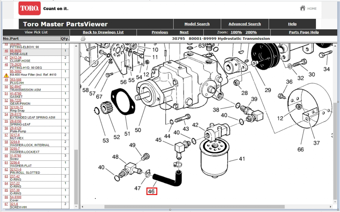

This is the same non-working link as in your other post.
Here is the parts drawing:
The hoses on mine are straight just like your picture. :thumbsup:
Thank you much. I ordered a new hose even though the hose wasn't leaking. I did not know for sure, first thing this morning. The fitting with the O Ring was not tight. After I climbed under this morning - After I ordered the part, I figured out what was leaking.
Later I decided I needed a new U joint. When I went to install the drive shaft, I got the front mounted up and then noticed a little movement in the U joint. I had one on hand so I swapped it out.
Probably from the shaft bashing around when the bi-directional clutch came off.
I am going to make some type of safety ring to mount around the driveshaft. If it ever happens again, at least it won't beat the hydraulic filter

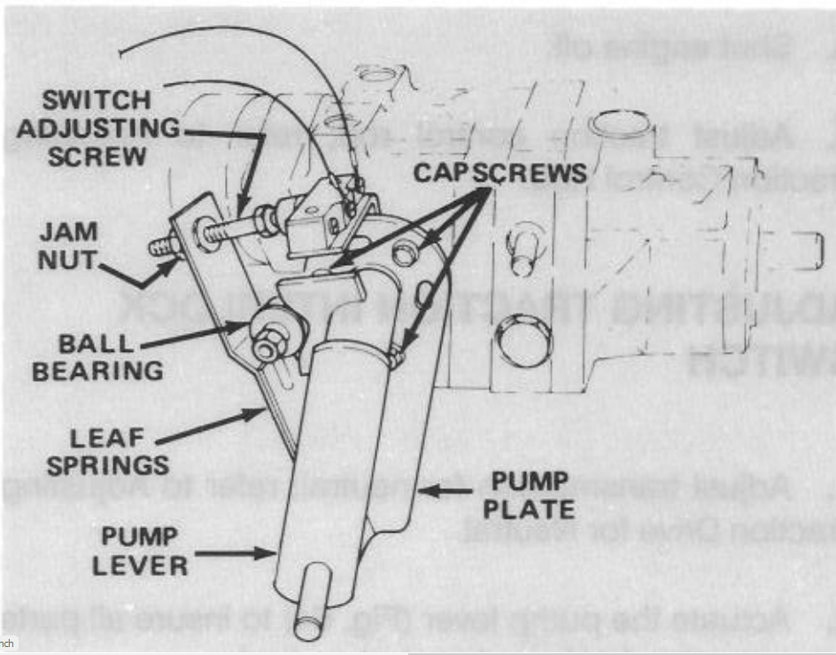

Finally figured the extra parts out, the popsicle part sets the neutral and the other part is attached to it, has a bearing that holds the actuator shaft when the pedal is released.
Tonight I pressed the roll pin out the actuator attached to the pedal, installed the parts on the housing and reattached the pedal actuator to the transmission shaft, after the roll pin was installed figured it would be close
fired it up and no creep so neutral is close but if I press pedal forward it moves a couple foot and loads up motor, release pedal it goes backwards a foot and stops, did this a couple times, at this time no switch is connected, before installing brackets it worked fine just no neutral detent
Anyone any ideas what I am missing

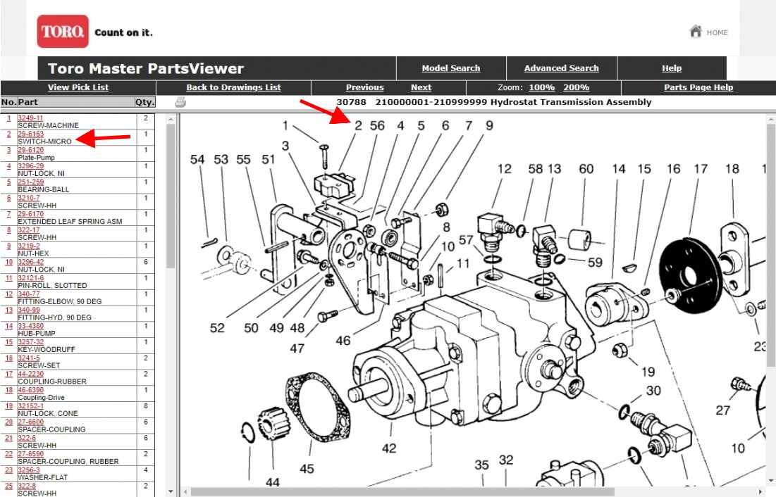

took another look at the 3 parts, a bracket, plate similar to Popsicle radial holes on the top and a micro switch, they show up in the hydro-static transmission diagram, micro switch is part 2, any idea what they do???
Popsicles must be different in Canada. :D
Here are the parts:
What happens if you keep going forward? Does the engine smooth out?

engine loads up but not move, release pedal and it goes backwards and stops, al I did was punch out the roll pin and mount the plate with radial holes to side, using marks on the plate to get it in place, put the pedal lever back on shaft and press roll pin back in.
the electrical switch the wires were cut so not reconnected them at this time
the machine worked fine without the plate mounted other than no neutral positive location, the pedal would not center by itself
