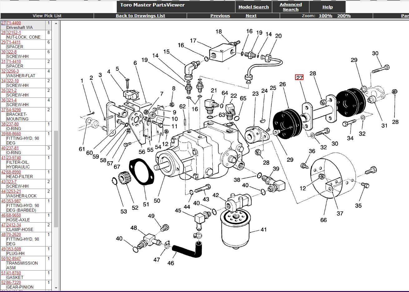

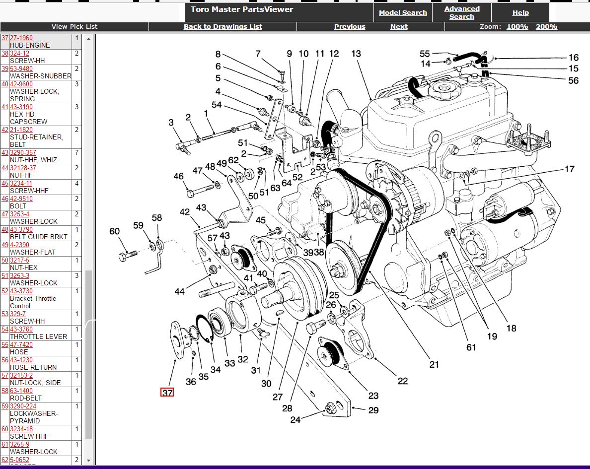

The alternator belt broke with me last night finishing up mowing on my 325d...
I've looked underneath the unit trying to figure out what part of the drive line to disconnect to replace the belt...
I've looked online and viewed several diagrams but still not clear on how to do it...
Do you have any advise?
Thanks in advance...
   / any toro groundsmaster fans on here? #446

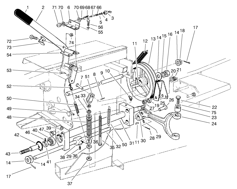

Follow the procedure in the service manual to remove the PTO belt. Start with the rubber couplings and the "drive coupling" to the transmission:

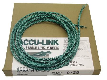

That is what I was thinking. I ordered the belt from STI. At $20 plus shipping I may just go with the linked belt option. Thanks for the help guys. I really appreciate it.
