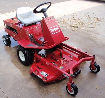

I don't have a Ground Master but I have an old Proline 118 that's still going strong....well I did replace the engine last year.
John
Looks like the same basic out front deck design as the Groundsmaster (note the "s"):
