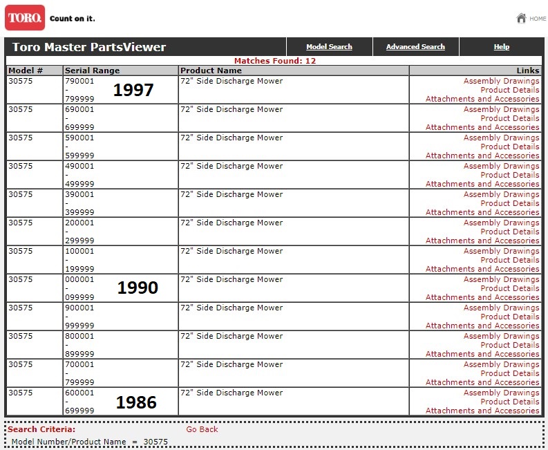

!996 223D Groundsmaster.72" side discharge Model 30575 deck.
The part of the deck tag with the serial number is gone. I have written on the manual for the deck 690001 - 699999 with a ?
I tried looking through to see if I could figure out the differences in the decks between serial #'s 590001 & 999999
I missed seeing anything.
Does anybody know any differences that would help me narrow down my Serial number range?
https://www.torodealer.com/en-us/Pa...?searchTerm=30575&BasicSearchFilter=equipment
   / any toro groundsmaster fans on here? #658
Why do you need to narrow the range?
If it is the deck that originally came with the traction unit it will also be a 1996 model, in the range of 690001 - 699999. That continuous range means no changes were made for the year. If there is a change during the year, there will be two ranges, like this:
694568 - 699999
690001 - 694567
If you need a specific part, check the parts drawings for the first year made, 1986 and the last year made, 1997 to see if the part number changed. Then look at the part to see which looks like your part.
694568 - 699999
690001 - 694567
I went through all the drawings. Where I got thrown for a loop was a person I talked to at Toro said there was no deck with that model number made in 1996. I later got an email stating that it was the 690001-69999 that I thought.
I had an old link to the proper deck schematic. Sometime between the time I saved the link and now, Toro changed their format or something and the link I used prior was no good.
I need several parts - spindles, bearings, pulleys, seals. I think I need to replace all the pulleys x 4 and bearings on 2 of the spindles.
Any ideas on a way to save some money on this?

Call some local golf courses and ask where they get Toro parts. There are many Websites that sell Toro parts, just do some searching.
The residential dealers may not be able to order parts from the commercial division.
The best place to get part numbers is here: Toro Master PartsViewer
They put the year made in order, not all jumbled up like the online store did:
