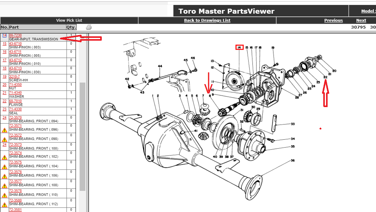

Found a picture on eBay of your 2WD axle that shows the input gear #14 where the trans bolts to the axle. The 4WD axle would have the pinion gear shaft, #8 (that goes through the input gear #14) and the driveshaft attachment flange #22 sticking out where the red arrow is:

So I should just be able to get parts #22 and #8 theoretically? And then that would allow for the addition of the drive shaft to the other axle?
   / any toro groundsmaster fans on here? #645
Yep, theoretically, plus a few more. You could compare the 2WD parts list to see what else is different.

Looks like other than the Pinion Shaft (#8) I will need #20-#23 which will be the Oil Seal, Flange, Washer and Nut... Then obviously a drive shaft and whatever mounts/ bearing is that has them. But these parts above will yield 4x4 PTO...
Just to clarify... That Flange is what couples the internal pinion and the exterior 4x4 drive shaft with use of that large washer and nut as well as the bolts that are driven into the flange from the drive shaft? Sound about right?

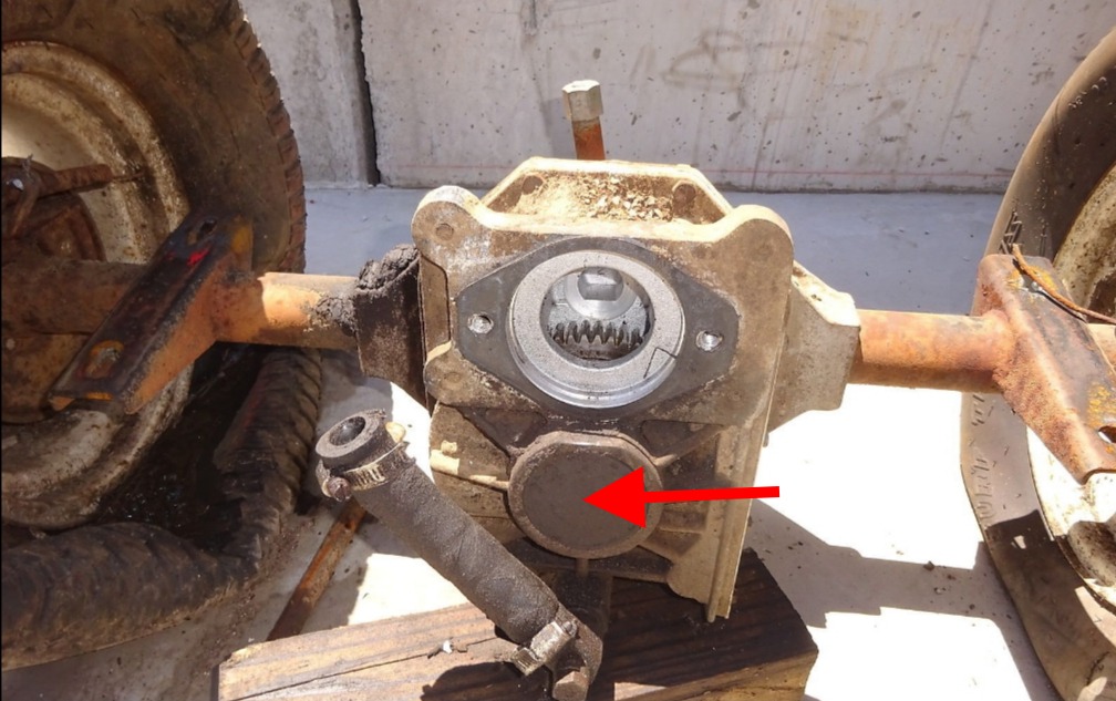

Right, But I'm concerned that the seal might not fit where the cap is on your housing, since the 4x4 housing is a different part number.
Also you didn't mention #24, the shims, so I don't think you have ever setup a ring and pinion or have the tools to do it. Although probably not as critical on this low speed differential.
Also, I'm checking and it seems most of the 4x4 if not all don't have a part number for the pinion shaft from the 4x4 assembly?
Andrew
That is because it is matched to the ring gear and is sold as a pair.

No, I have never set up a ring and pinion gear. So if I also include the shim from a 4x4 axle that would be ideal. correct?
No , it isn't "the shim". Look at the parts list again. There are several thicknesses.
Or will that need to be a test and fit type of situation?
Yes.
