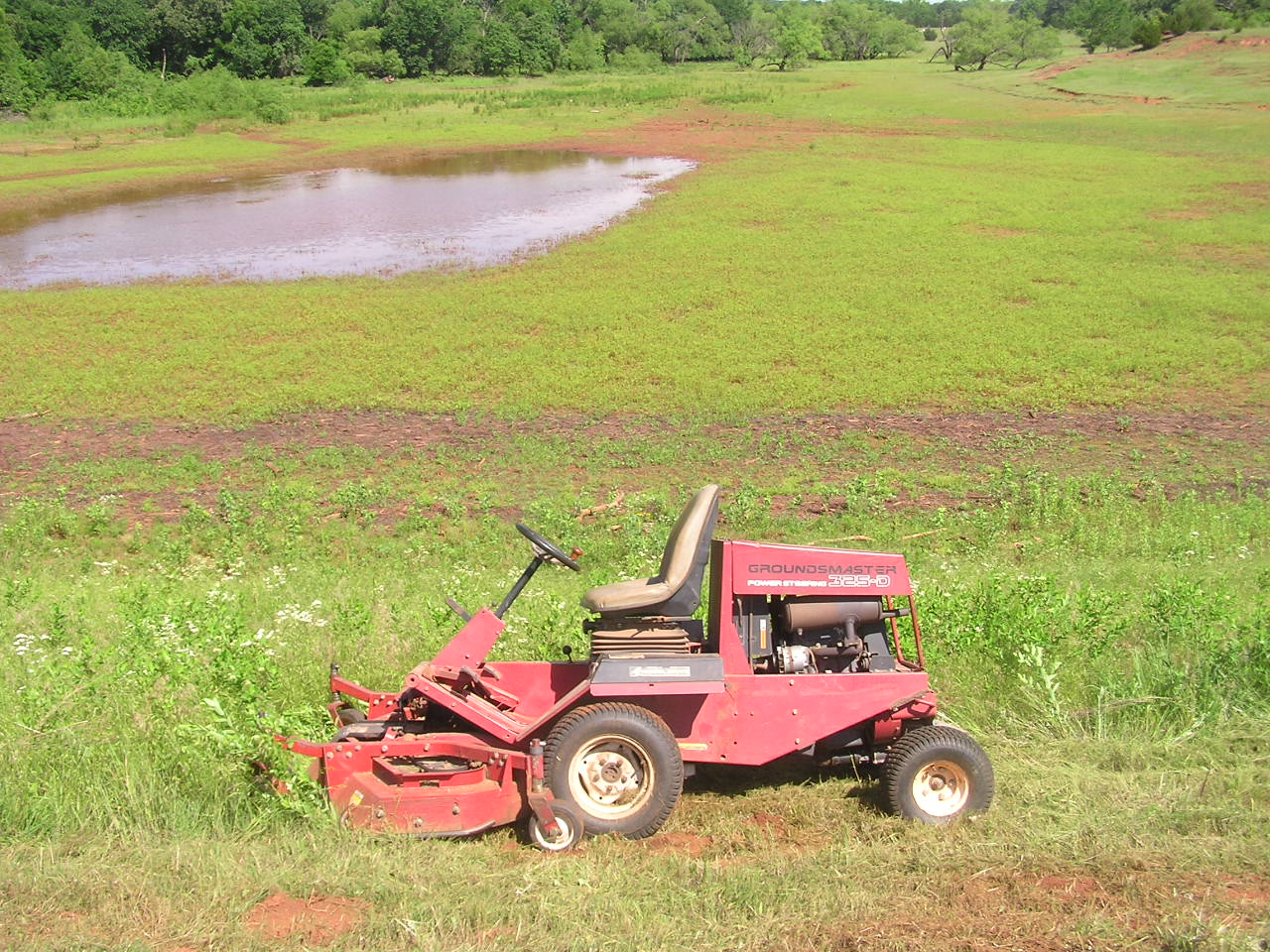

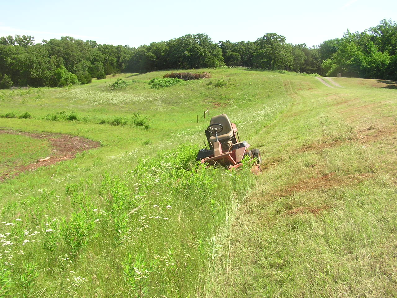

As a side note, has anyone else had problems with their Groundsmaster 300 series climbing hills?
If I have to go slow for any length of time, slopes are all but impossible. My tranny stays unbelievably hot, and hydraulic lift becomes slow. I thought it was the hydraulic filter, but the tranny and hydraulics run off two separate circuits.
Yes my 1996 325D does not climb well, I back off of the go pedal to get the best power, but it just stalls and whines.
I haven't noticed any transmission heat when mowing heavy stuff.
It will not climb this 18 degree slope:
   / any toro groundsmaster fans on here? #78
I can't even touch my trans/pump head... even just mowing the yard.
   / any toro groundsmaster fans on here? #79
Just got off the phone with Dana/Spicer...
They are checking on a higher ratio for the axle.
I'm hoping it's cheaper than the price difference of a new mower.
   / any toro groundsmaster fans on here? #80
You might check the TORO parts list for the 328D, model 30627. see if it uses the same part number axle and differential.
My 328D easily climbs the steeper than 18 degree end, where the brush pile is, that can be seen in the picture
