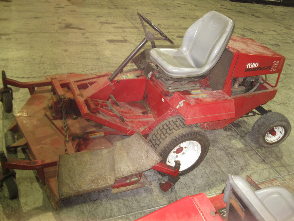

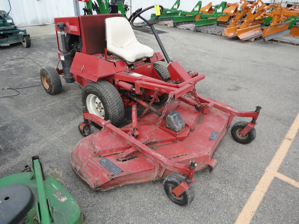

For those that don't know what a Groundsmaster 72 is, pictures from an image search:
I still mow with the GM72, Time to patch my deck again and I have to get my engine parts from Germany because it has the Continental R Renault engine in it. I have had it on Propane for many years, propane unit off of a floor burnisher and a 20 pound grill tank. Always starts ,I am fat enough to make the spring ride seat work well. Bought it used about 17 years ago it is a 1979 with a cab and snowblower, It came with the manuals and original receipt showing it was $18000 when bought new. I also have a zero turn but my first choice is the Toro GM72 with the offset deck, it goes under the bushes a few feet .

So the real key is the front deck?

Yes and that it is 6 foot wide so that it has the 2 foot of deck sticking out past the wheel. That part also makes it easier to trim around small trees, I can trim a tree as small as a pop can with out much effort. So yes any out front mower with the offset would make me happy, next time it will have power steering, this GM72 does not and after a 4 hours you start to feel it. This has the 28 HP Continental R engine (750 cc Renault Car Engine and is plenty of power for mowing 6 inch tall grass but is short on power for the 48 inch two stage snow blower even when I am running on Gasoline.

I too, have a 72" offset deck. You're correct with the offset. It allows me to mow beneath my fencelines VERY well. On fencelines with access to both sides, I need only touch up around the posts with a string trimmer... this saves HUGE amounts of time.
On the flip side, mine is the 325D with 4wd and power steering. The only drawback to the power steering is the cost of maintenance. As with most other pre-3000 series Groundsmasters, the steering cylinder is no longer available. Upon inspection, mine had a nick in the rod... requiring polishing as part of the rebuild. This ran repair cost up from $160 to $275.
The steering cylinders are an odd size (7.15 stroke), and cannot be replaced with off-the-shelf cylinders unless you modify the rear axle linkage to accept an 8" stroke unit (not advisable).
