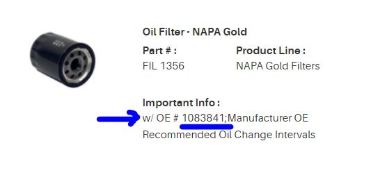

Any suggestions for getting the oil filter off my 328... or at least a NAPA part number for it?

NAPA has Toro in the Website: https://www.napaonline.com/en/farm-tractor-parts/toro_mower/groundsmaster_328-d/filters
My 2004 328D is Toro 108-3841, NAPA:

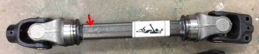

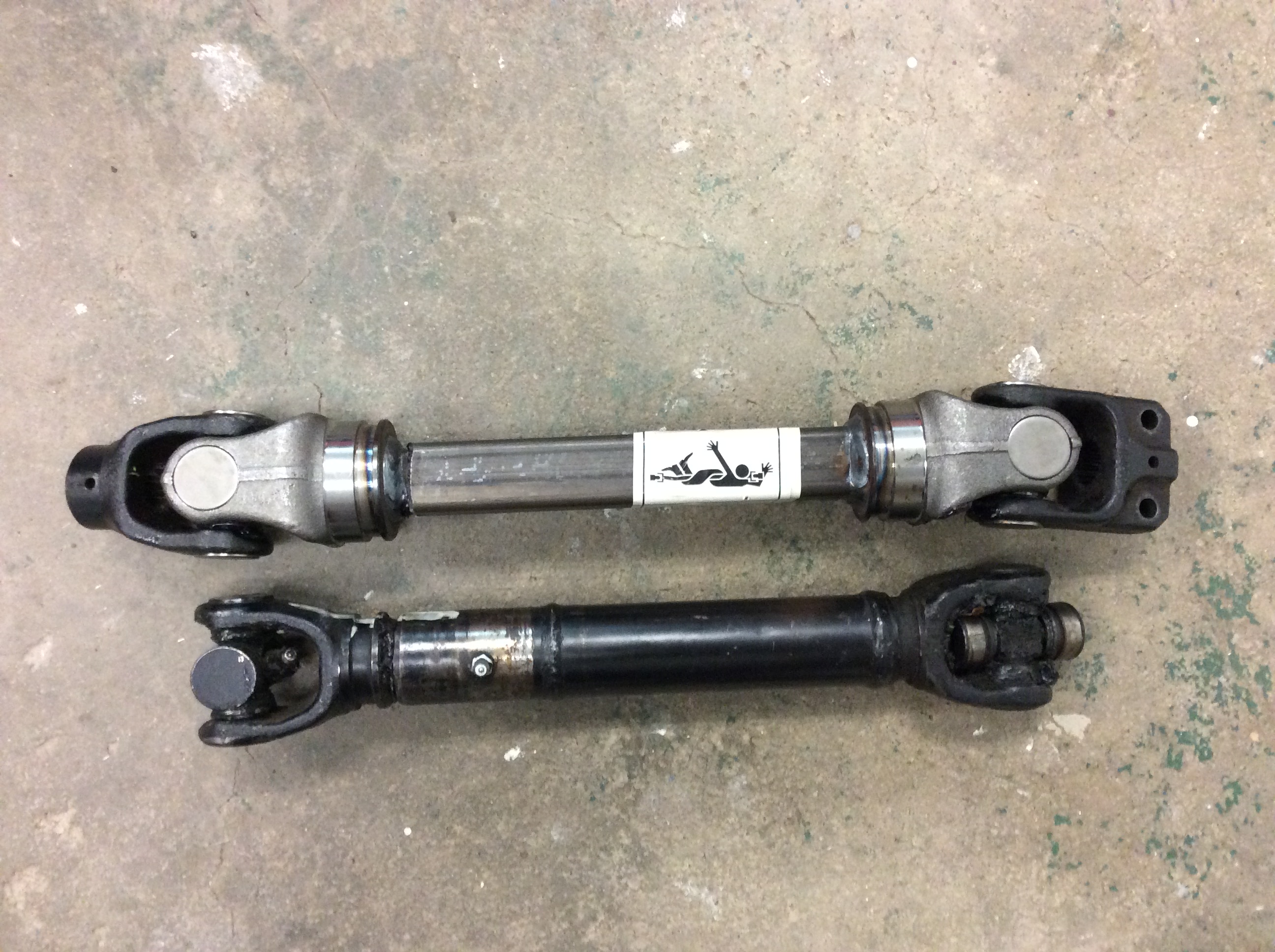

Had the driveshaft for my guardian deck rebuilt. The old one had worn splines and was bent .750” and would wobble pretty good. New shaft, new U joints and we are back in business. New shaft from Toro is $550, to rebuild mine was $240.

Can't tell from your picture, is the new shaft rectangular or square?
If square, it could be put on with the u joints out of phase causing it to vibrate.

It’s square, I’ll be careful with the phasing. The driveline shop couldn’t get the correct splined shaft for a replacement. They also couldn’t find aftermarket ends that would fit. New ones from Toro were $180 each. I ended up reusing the old ones.

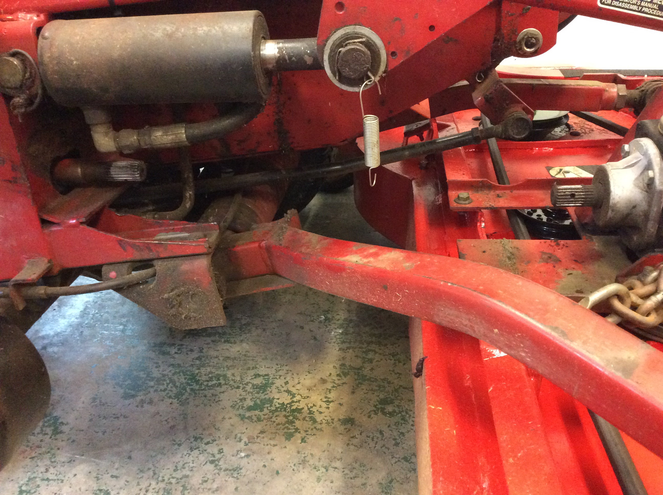

Installed the rebuilt pto shaft today. Still have some vibration, but much less than before. It appears to be coming from the tractor side of the shaft. Gearbox side tracks straight and true, tractor side has some wobble. When installing the shaft I noticed the tractor side coupling was slightly loose in the spot where it is pinned and usually runs. But, if I slid it one inch out or in on the splined shaft it would get tight again. Obviously that one spot on the shaft is worn. Question is, can I I slide the coupling down and drill a new hole for the roll pin without destroying the main pto shaft?
