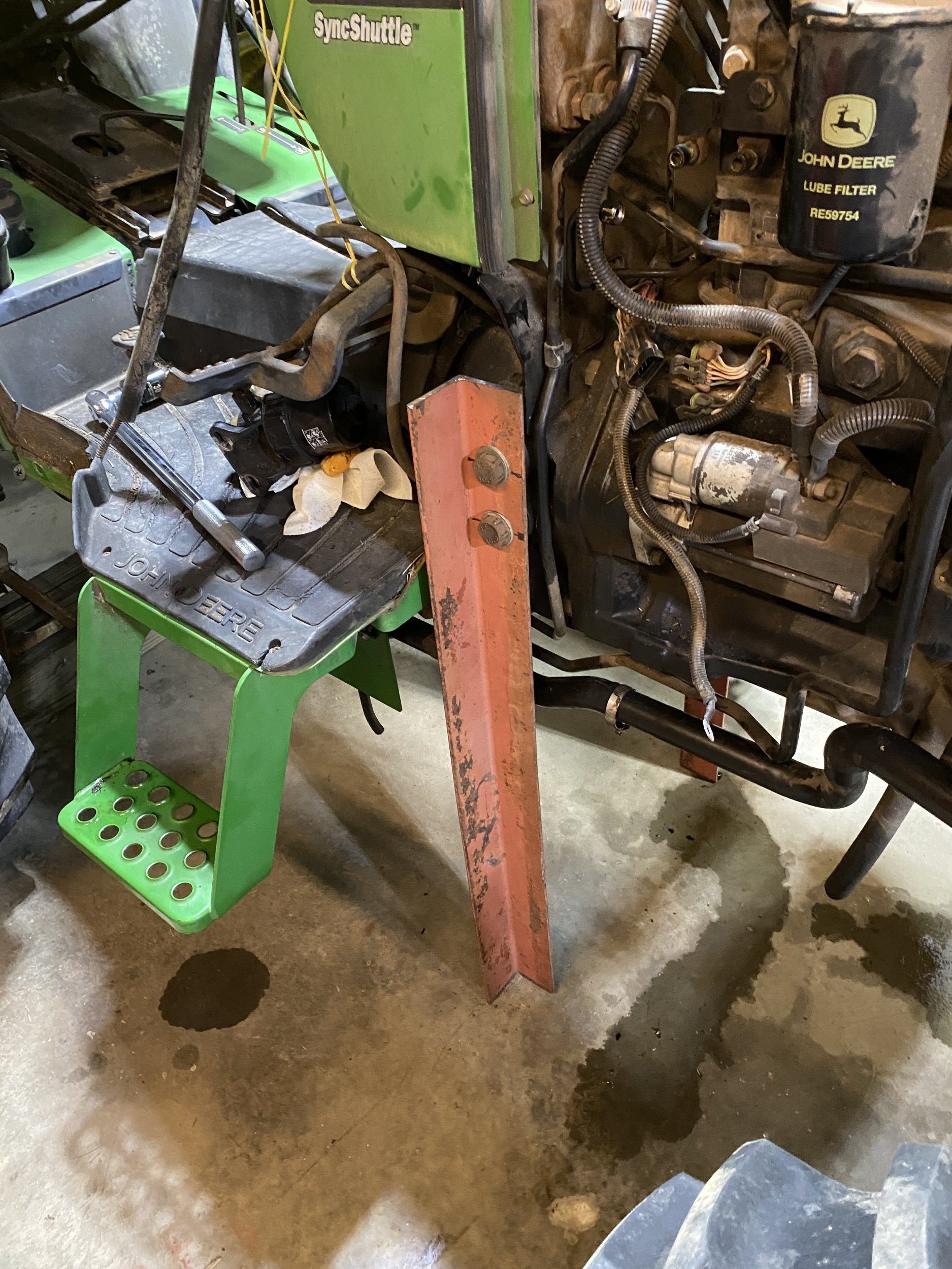

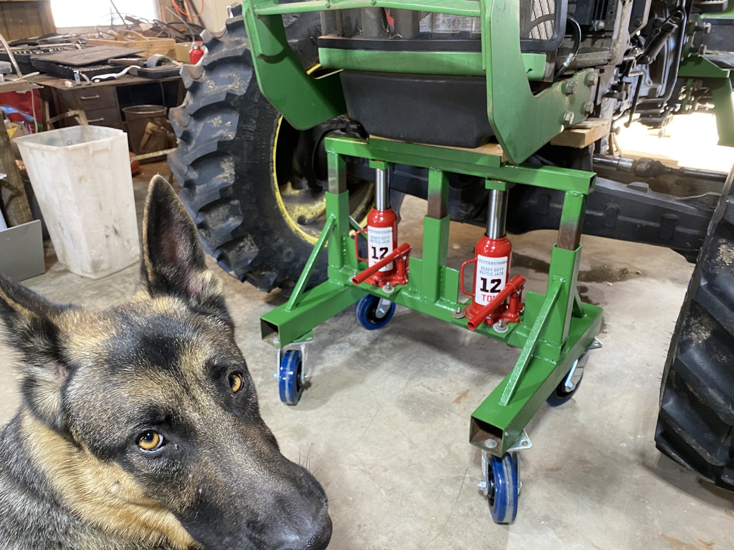

I built a stand based on the Western Truck and Tractor Repair guy's stand on YouTube. For the rear I am using two pieces of angle iron. Here the rolling jack is being tested, obviously it will be placed under the clutch housing. And yes, safety stand everywhere.

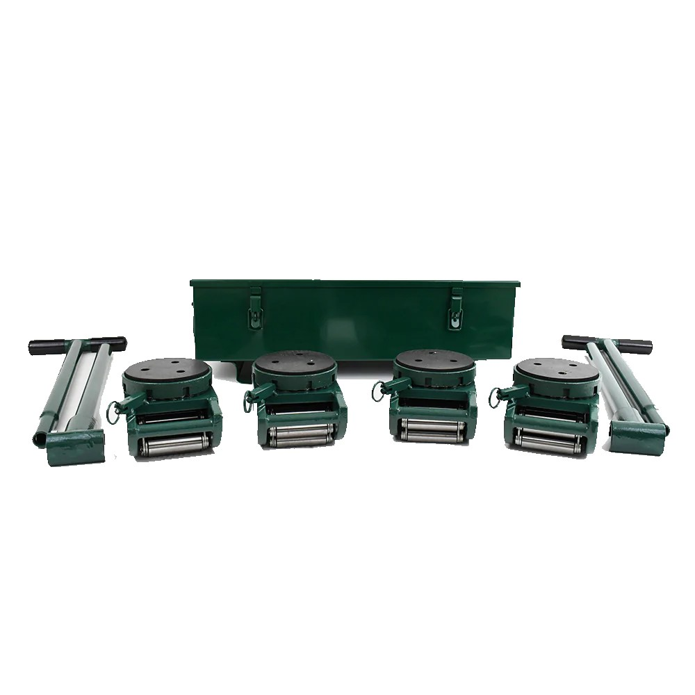

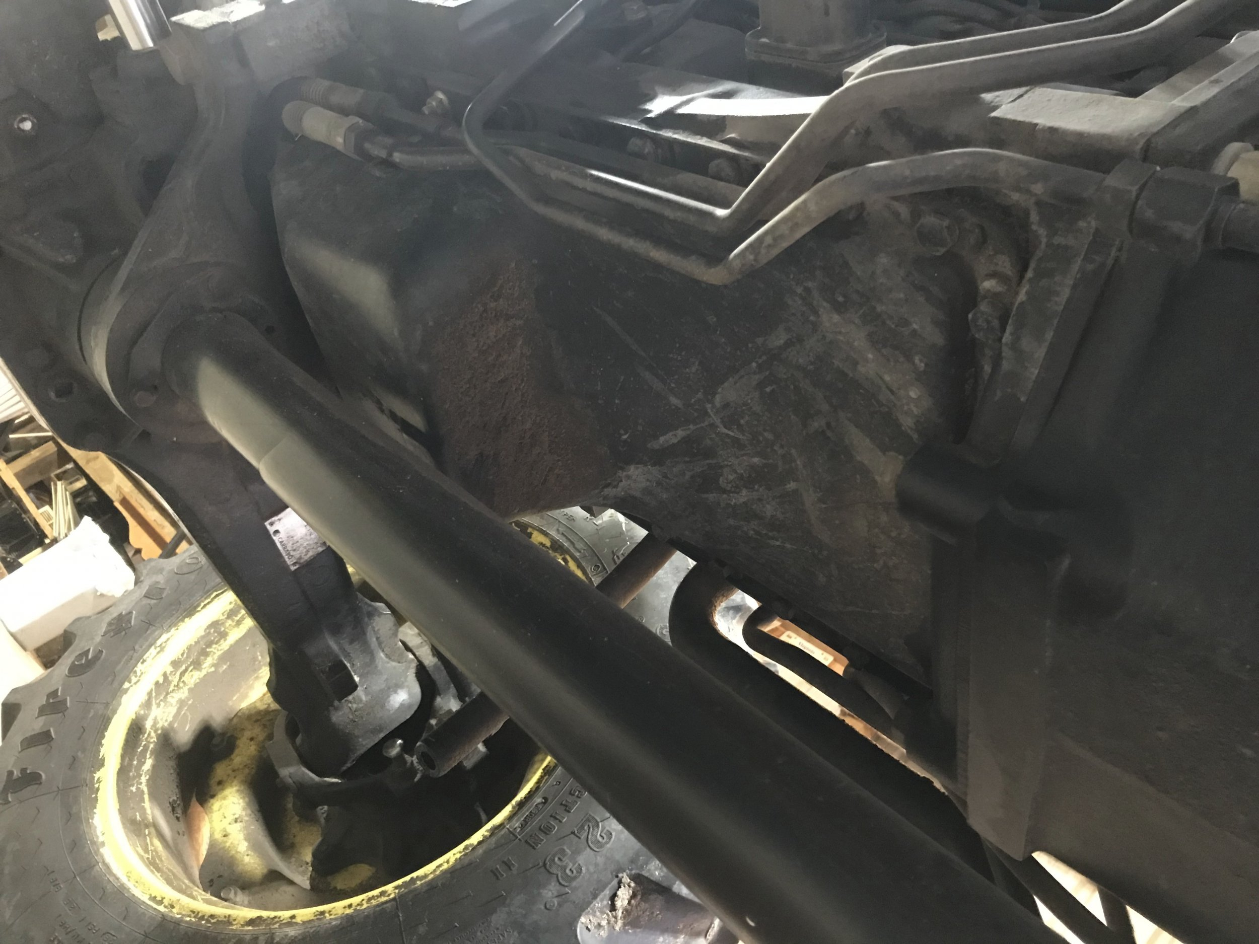

I recently split a 5220 which is the same tractor minus one cylinder. I fabbed a rolling stand using 20k machine skates and attached a bottle jack with a saddle and attached 4x4 block of wood. I picked up the front half with the 4x4 on the back edge of the oil pan up against that lip on the block that bolts to the clutch housing. Worked great zero damage to oil pan.
The Deere shop manual specifies a gantry crane/sliding shuttle/chainfall setup using a nylon lifting strap.
I have a set of Hilman rollers that I use for other equipment. The swivel tops come off and I bolted them to a steel frame for the rolling stand. Worked fantastic. They're high dollar but I understand there's chicom knock offs available now for cheap

Got everything apart and the friction disk was down to the rivets with a warped pressure plate. Jack system worked like a charm. Thanks for the replies!
