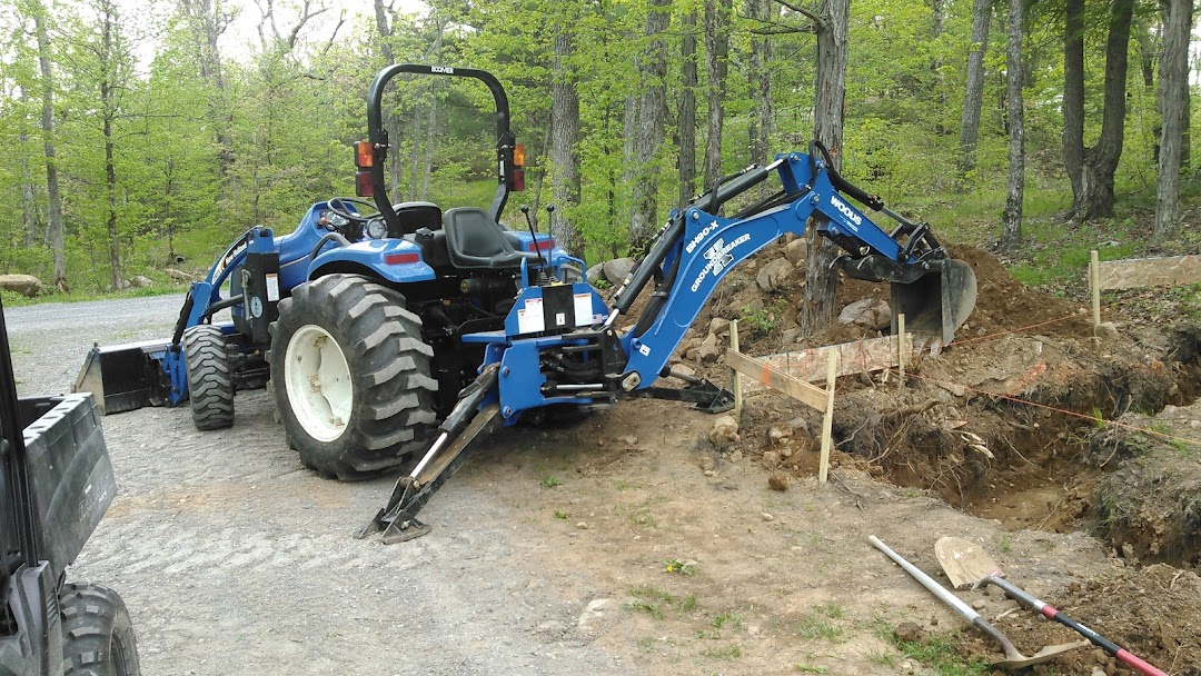

I use a woods bh90x, with sub frame, on a nh t2310. Would need an excavator if I didnt have it.
Only issue is putting it back on sometimes.
