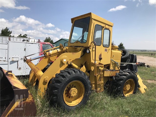

Today I chased the Hough Payloader home. Now comes the hard part: fixing it.
   / Anybody know about International Pay Loaders? #39
Fond memories for me Eric. I worked at my dad's garage in the late 70's early 80's and the construction company we serviced had a few Hough 60 and 70 models. My dad owned a 60 and used it to plow snow for the city for quite a few years. It always ran great with very little upkeep to the engine and trans. Brakes never worked for crap as I recall.
#40
We've got a new medical provider moving into a big box store in a town near me and as soon as I know I have brakes, wiper, and a heater working in this thing, I'm calling their corporate office to bid on plowing over the winter as I've watched one contractor go from clapped out loader and skid loader to new loader and skid loader doing just the local Walmart lot and I want "in" on that action. Plus I've done commercial plowing in the past as well.
Anyway, now that the Hough has reached the Tinkerage, I've been looking it over while trying to find out stuff in the parts and service books. I was able to purchase a new diaphragm for the power cluster reservoir (the separate fluid reservoir that feeds both master cylinders, but Hough calls them "power clusters" LOL because they can) on eBay. I see the airhorn valve may need rebuilding or replacing. I'm trying to chase down two mystery airlines that have been terminated improperly. I notice that both front and rear wipers are air operated and I don't think either is hooked up.
What I did see is that this machine appears to be the final version of the H-80B model as it has disk brakes. Here is the right rear.
The disk spec is 11mm or 7/16" and both rear disks appear to be in good shape. The fronts are a little harder for me to get at. I need to get some cynder blocks to hold the bucket up off of the ground for better access to the front axle.
Here is the double caliper right front. I can see that at least the two bleeder screws on the bottom are sheered off and the disk looks heavily grooved. I wasn't able to get a wrench on it to check it because of clearance issues (I'm fat).
I also see I've got a leak from somewhere in the primary or secondary pump area. It is so messy right now I cannot tell where any of it is coming from but getting the brakes working is my primary goal so all of the air leaks must get squared away before I can look at the hydraulic braking since the system is air over hydraulic for the brakes.
One other thing: This Hough has a what looks like a quick-release system for the bucket (the third function hoses are sitting there on the end of the loader), but the quick release is lacking any automated provision for pulling the bottom pins. Does anybody know what is going on here?
Thanks for any and all help or encouragement.
