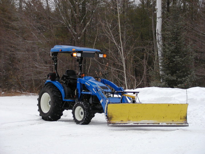

   / Anybody know how to build a snow pusher box? #14
I know several folks have adapted these for their tractors, I'd sure like to some day.
Thats how I did mine. It wasn't hard or expensive. I think I have around $500 invested in mine That includes buying the used plow, the quick tach plate from Bobcat and paying the welder to put it together.

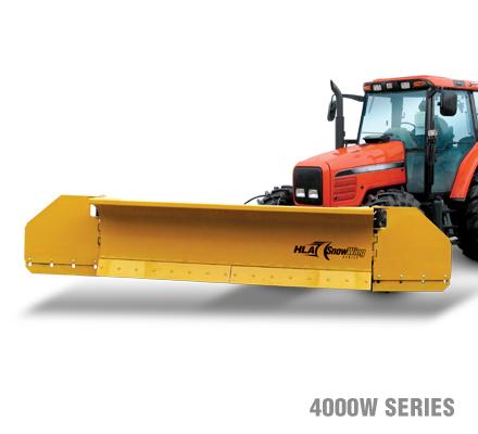

Here is a neat snow pusher. Seems like you could adapt a box blade to push snow. Add some pucks to the back, to set the height, and run it in float mode. The second picture has wings and is a box bld front and back.
Wow, looks like you even used the head gear from Fisher! I have never seen that on the end of loader arms before.
   / Anybody know how to build a snow pusher box? #18
It took me a few minutes but I found the original thread from 2003 when I had the plow built. There you will find a few pictures showing the plow setup being fabricated by the welder.
http://www.tractorbynet.com/forums/attachments/31311-how-sweeeet.html
The old thread was enough to jog my memory and I now remember that I was given the Fisher head gear by the local JD dealer who also was a Fisher dealer. The head gear came off a truck that had been in an accident. The truck got a new plow frame and head gear and I salvaged the old head gear from their scrap pile.
The plow blade was purchased from a local man who had it sitting around for years. The quick tach plate, as I mentioned came from the local Bobcat dealer.
I gave all 3 componants to the welder and he did the rest.
