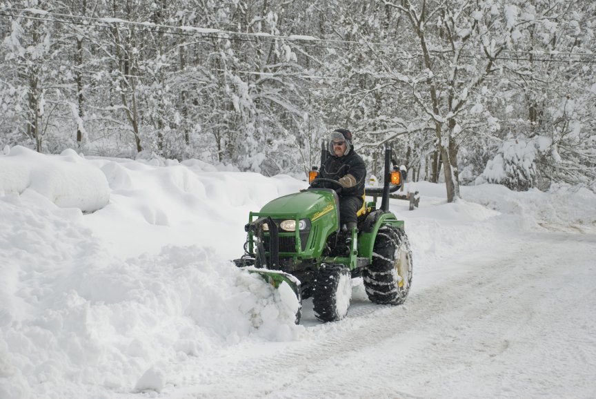

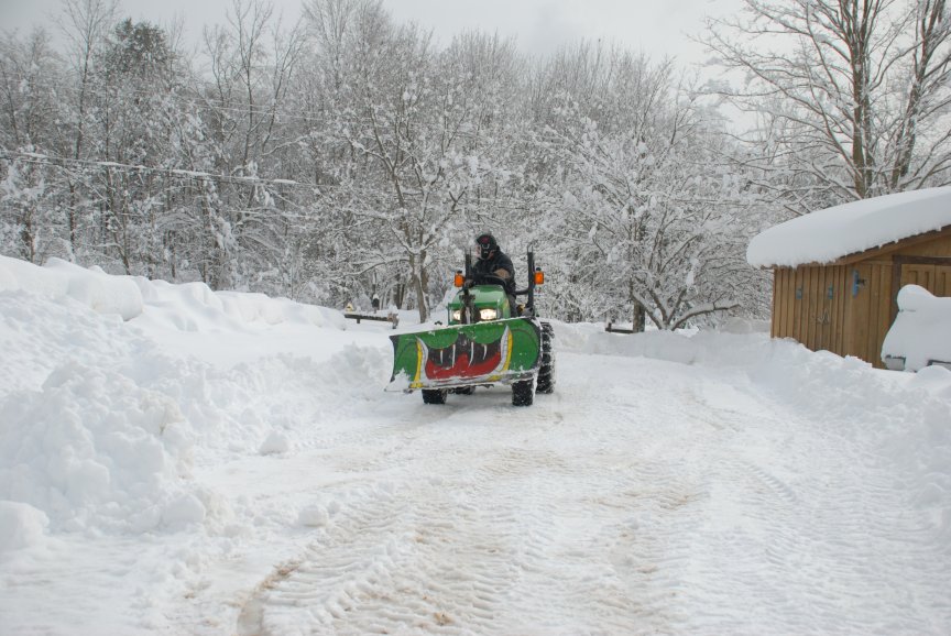

Nope not so, 22 years with R4's (and chains) never ever a problem pushing snow. Last year with the 2320...
View attachment 190676 View attachment 190677
Brrrrrr! You guys out clearing snow without a cab make me cold just looking at the pictures! I bring a coat just in case I have to get out, but I don't do any snow clearing jobs if they require me to get out of my cab. :)

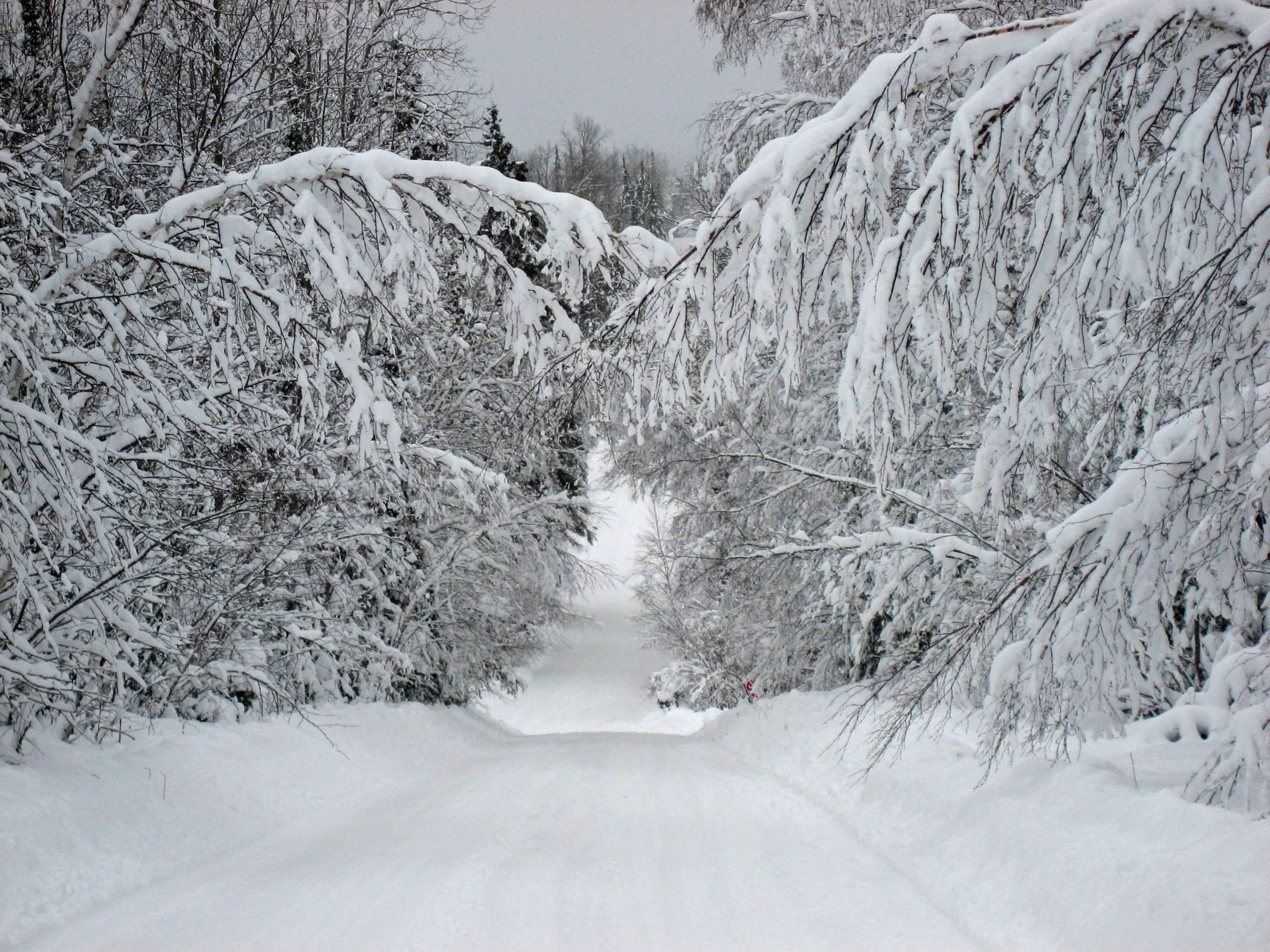

I plow one mile of private road with my current tractor a JD 4400 with R1 tires on it. The attached photo (if I did it correctly) shows the rather steep hill at the beginning of that road. With light snow I can plow up and down the hill but with heavier snow I can only plow down due to tire slippage. The tires are not loaded. I have a Land Pride back blade on the tractor as well as a Curtis blade on the FEL. I have a JD3720 on order that will come with large R4 tires that will be loaded. It will be a great chance to evaluate the two on this hill.

I have ALL of those various conditions during the course of 6 months of below freezing temperatures in my area of Alaska. And I've lived up here for nearly 34 years...
Chains and more chains! All four tires - please - with V-bars on the front wheels for steering control.
Chuck on lake - does that STOP sign at the bottom of the hill - really mean stop... or can you just kinda glide thru it? :D
AKfish
AKfish
Good eyes!!!
Jeez!! I don't think I'd want to plow down that slope!
