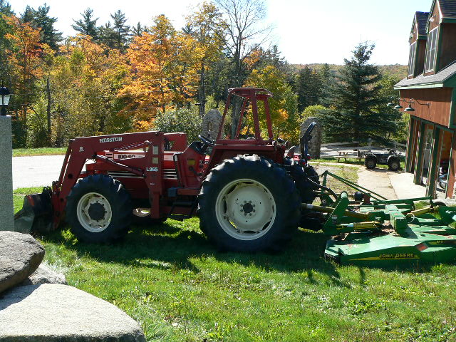

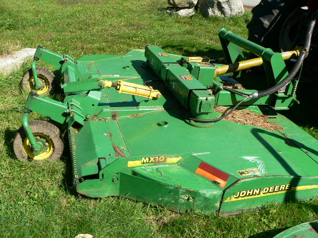

I have a slewing MX 10. I am able to mount it to a Hesston 100 90 DT without any help. Attaching the PTO shaft is not really any trouble, especially if I leave the mower centered on its slewing axis. The tractor's lower links extend, and that makes hooking the mower up pretty easy. Extend the links, attach them and back up till they lock up.
I have no complaints about the mower, it has been good to me and I have abused it, unintentionally, but that is what it took for me to find all the rocks in my orchard over the years.
If you have specific questions, ask away.
