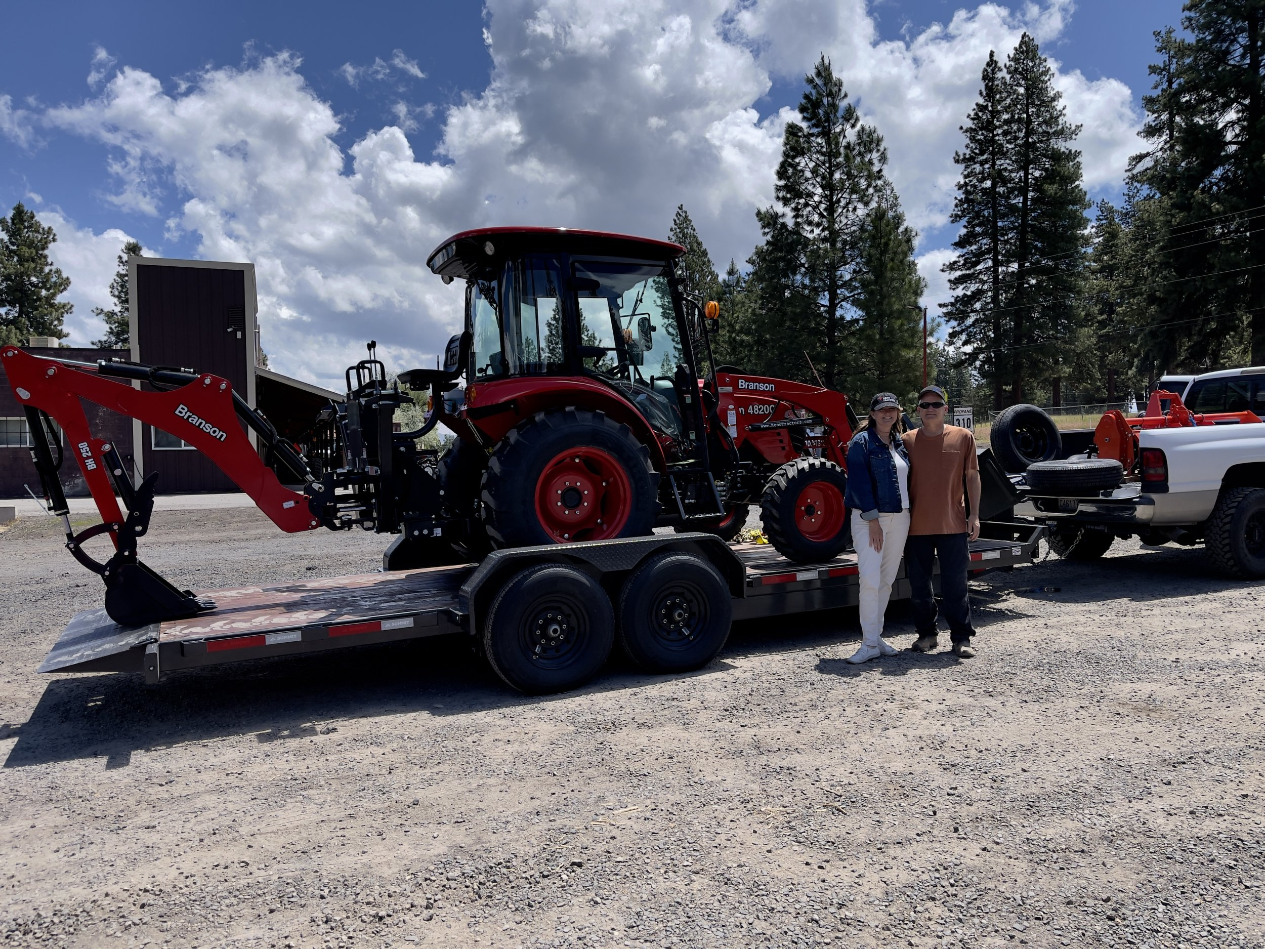

I picked up a Branson 4820C with a BH250 backhoe early last spring. The BH option was not cheap, and likely not worth the expense. That said, I wouldn’t have it any other way. For my use and purposes the backhoe is adequate to the task. I don’t have much rock on my place, and this will add longevity to the hoe. These are nothing like the Case you are accustomed to though. Breakout strength, digging depth, swing radius, loading height, and build quality are all very much less than what you are used to, and they are not designed to be used to pick up/move the tractor. Most of the manufacturers say to not pick up the machine with the BH and loader as it puts excess stress on the machine. Rolling forward from the BH seat might be possible, but only if you can reach the loader hydraulics from that seat. Hard to do with most setups, and impossible with a cab. One could probably MacGyver up some rudimentary FEL controls that would work from the BH seat, but if you need a BH that often to justify the effort then you should consider keeping what you have, or trading the Case for a mini-x like others have suggested. All of these CUT hoes are for light-duty purposes only, and won’t stand up to hard use. I understood all this when I got mine, and rationalized that it would serve my purposes adequately. So far I have been very happy with the decision, and the hoe.
