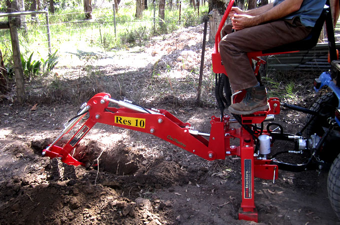

I think one of these would be suitable to start a frame-mount project.
Note 4 ft is about the maximum practical depth without moving the tractor for every foot advancing the trench.
And a caution: I looked at the Del Morino mini-backhoe thinking that would fit my smaller YM186D. I discovered the US dealer was lying, he advertised 6 ft dig depth while the manufacturer said something like 4.1 ft straight down and a lot less for a continual trench. Avoid.
res10-del-morino-backhoe-jpg.614910
