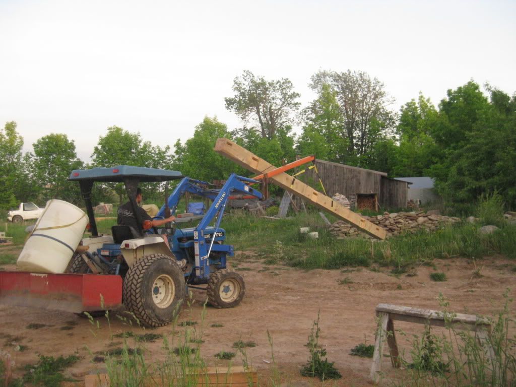

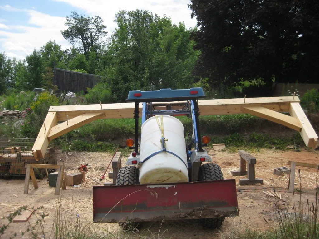

this simple drum set up has kept me out of a lot of trouble this summer:laughing::laughing:
10' boom carryin a 10x10 22' chunk of green hemlock...rubber side down:D
Any more pictures of the post and beam project?:cool2:
