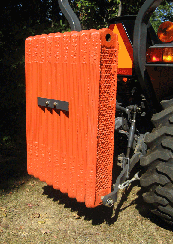

Cast iron radiator. 475 pounds with hardware. Combined with loaded tires, it does the trick for my L3400. It's great in tight spaces.
Hook some hoses up to that thing and make it look like a cooler for your hydraulics. Good conversation starter for city folk that want to comment on your tractor...:laughing:
