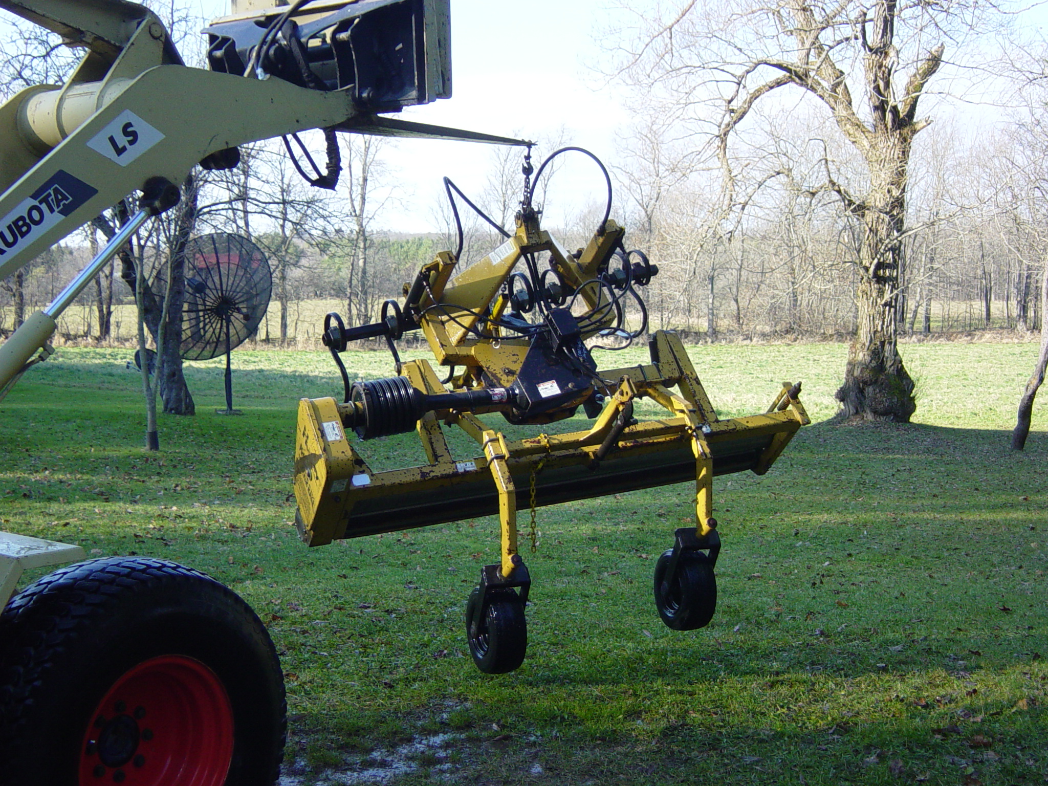

MANY of the forks available around here for a couple hundred bucks were condemned and not allowed in service because of the hole in the end. Same for drawing weld lines across the tips so things don't slip off as easy.
Anyway, for us, it's great. I also carry an eye bolt, forged, maybe 5/8 with a grab hook and a wing nut so I can attach it quickly.
Here is a picture of the hook.
Not sure I would want to drill a hole much larger than 5/8 though.

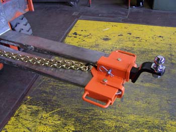

I will suggest that you make a box/tube to slip over the end of the fork with the ball on the end.
Then drill a 3/8" hole through it and the fork to pin it to the fork but make it easy to remove.
You can drill the fork but it takes a lot of pressure, slow speed, good bit and start with small bit. A drill press would help.
Also a fork with a hole is not acceptable with OSHA or any inspecting agency.
   / Anyone drilled a hole in the end of a pallet fork #9
Several places around here have a rectangular tubes for each fork. A couple cross braces connect them tighter at the standard fork width for their operations. The crosspieces have a ball welded to it on one end. The other end that the forks slides into has a short chain and hood on the cross piece that they use to hook to the fork carriage to keep the assembly from sliding off. That way no modifications are done to the forks.
