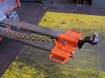

No wrench needed:

A lot of better ideas: trailer ball for forks - Google Search
No wrench needed:
I made almost the same style, fits over both fork and has tube for stinger. Slide it on for the strength of both forks, chain to back plate and uses lever style load binder. On or off in a minute and very secure. The hardest chore for the setup is moving the forks into position.
Moving heavy loads using one fork IMO would tweak the fork.

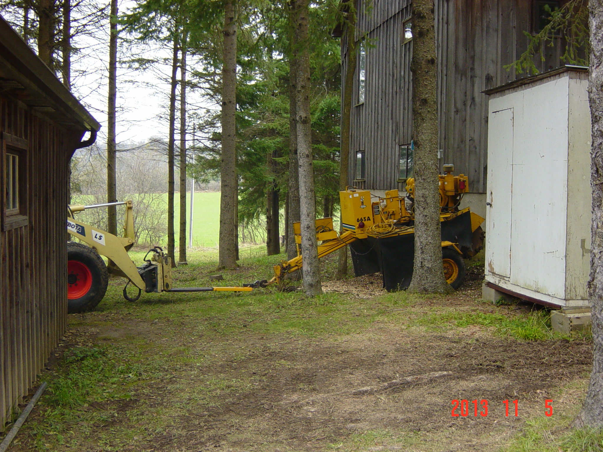

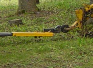

Oh, she's got more than that! And I am always mindful of fatique and possible failure at any time. As it sits, I have been doing that for about fifteen years with no sign of trouble.
I built the sleeve for the fork end with a 2" receiver. It's kind of sloppy despite adjustment bolts. A two fork thingie would be MUCH better. Depending on what you are pushing or pulling around, the single fork thingie is hard on the fork carrier.
THIS is a bit much for a single fork receiver.
