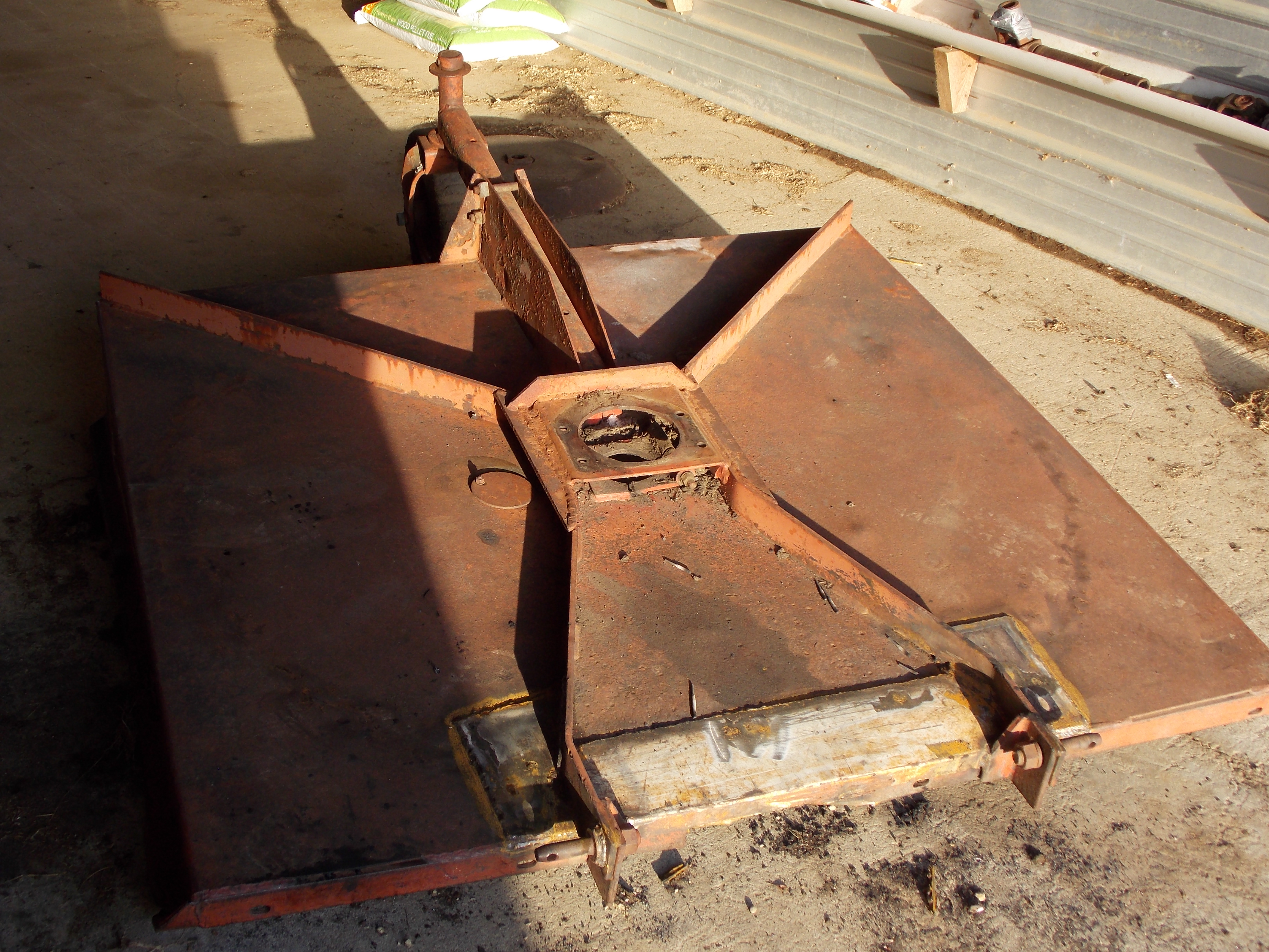

It is the same with my bushog. Being a bushog, they are simple, so in 45 minutes I had it torn down to the individual parts, and out of boredom started to weld it back, and yet have not taken one picture of it. It is always nice to get a before and after picture.
I am trying to keep the bushog decent looking, without looking like it was patched all to heck, however when the output part of the gearbox snapped in half, it sent the bushog into a pretty big wobble that drove the knives up through the top of the deck. It is pretty hard not to patch that and make it look like you did not patch it! I got it welded up though. It is a lot stronger than it was. Another part that is worn out is underneath the bushog here it can ride along the ground on high spots. Fifty-five years of doing that has worn out the wear bar I welded on it twenty years ago. So I need some flat bar to resurface the resurfaced wear bar.
I was thinking of adding some stiffener bars to the gear box too where it broke, I got to put strong backs in anyway so as I weld the collar, it stays in alignment, so if I keep them on, it will provide a lot of strength for the intense flexing those bearings/gear box gets. I will have to notch out for them in the mounting frame, but that is not too bad, and being the output shaft, it is not like anyone is going to see it. At this point, anything I do that is cheap and stronger is worth doing. I will do all I can to keep ye ole mower...mowing, but if it craps out, then I will just replace it, but most likely with a flail mower.

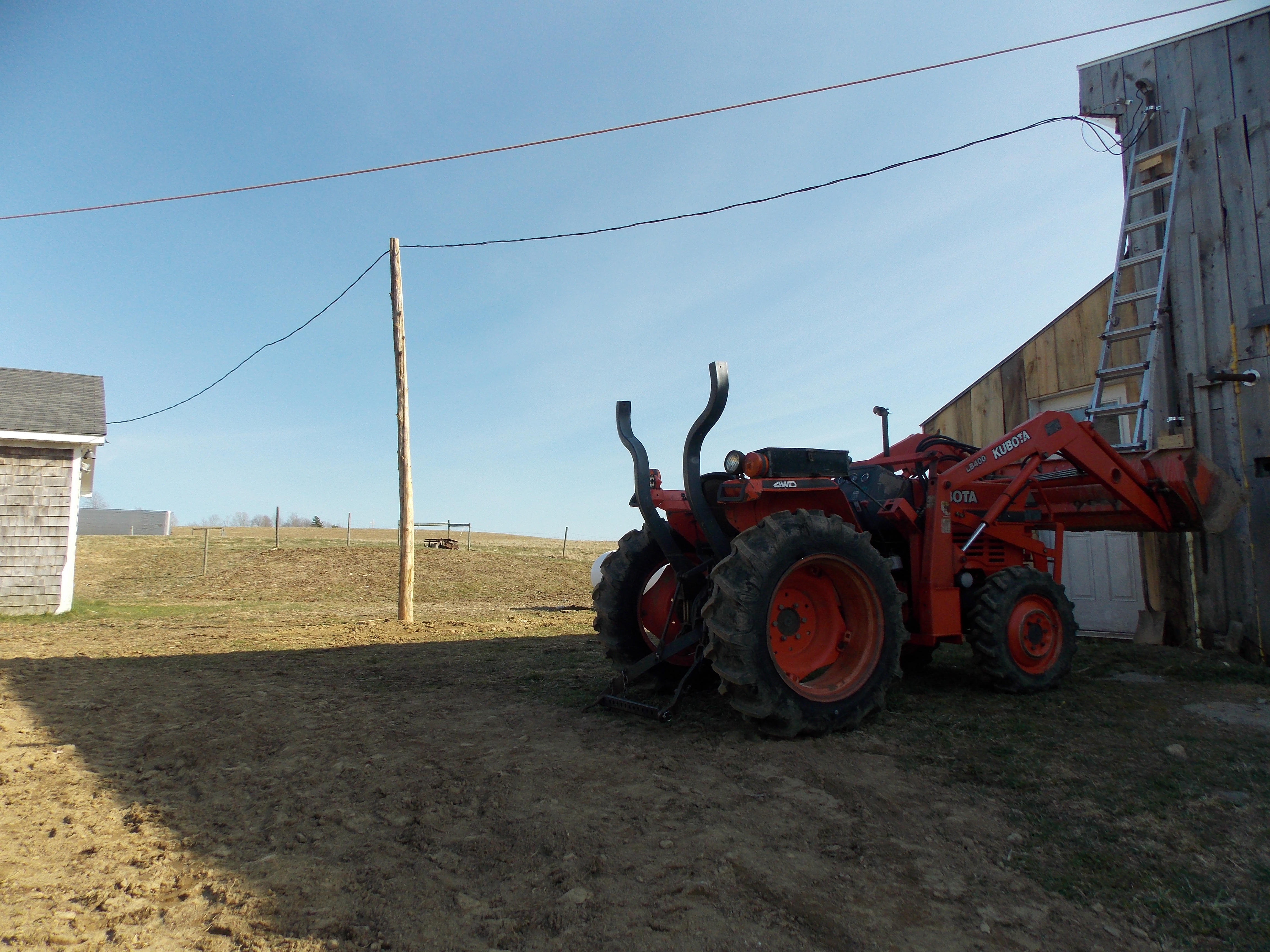

My oldest daughter is reaching that age at 15 years old, where she is learning just what it takes to get things done. A week or so ago, I ran the power from the house to the generator shed. Now this is 100 amps, so pretty big wire, and while it took me all day, I was able to run the power from a load panel halfway into the house, up and through the attic, then outside where it ran to some entrance cable, over 100 feet to the generator shed, down through a mast, and then into the generator's load box. In writing that, it seems pretty simple, but all I had was 2-2-4 entrance cable with bare neutral so I had some pretty good connections to make on each end of the masts going into the generator shed/house.
I also put up a utility pole half way across, so that meant going into the woods, cutting the tree, hauling it home, debarking it, then securing a insulator to it, digging its hole, raising it up, then back filling it. That alone took over an hour.
So it was doing all that transmission line work that day, that my oldest daughter saw just what it takes to keep this place improving. But it can be frustrating because when you are asked what you did that day, "oh I put up some wires from the house to the generator shed", boy; that just does not account for all the work that went into that day! But it was nice to see that she was impressed with what gets done. Hopefully when she gets married, she finds a go-getter type husband, and not some "gamer" or, "is not really into work."

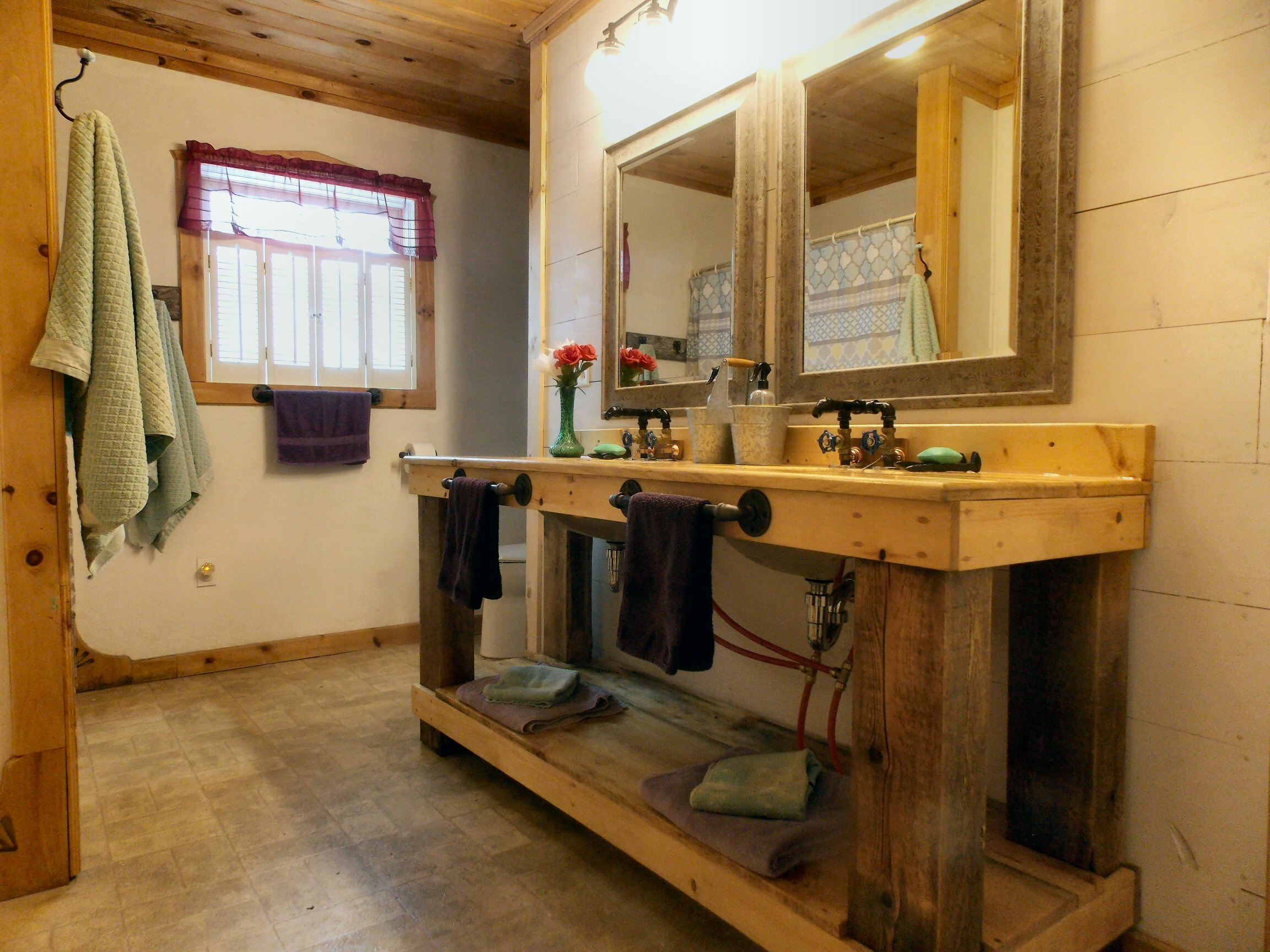

2. Then it was off to putting in a new double vanity in our main bathroom. It was not too complex of a project, just redoing a wall with shiplap lumber instead of drywall, redoing some drains, and then making the new vanity. Interestingly, this was made from a dying pine tree on our own land, so from stump, to sawmill, to bathroom vanity. (Completed)

4. Then knowing I will bushog in a few months, I wanted to get that rebuilt, so I started on that last week. This is not a huge project so I needed other things to do while waiting for parts and stuff. (Still in process)

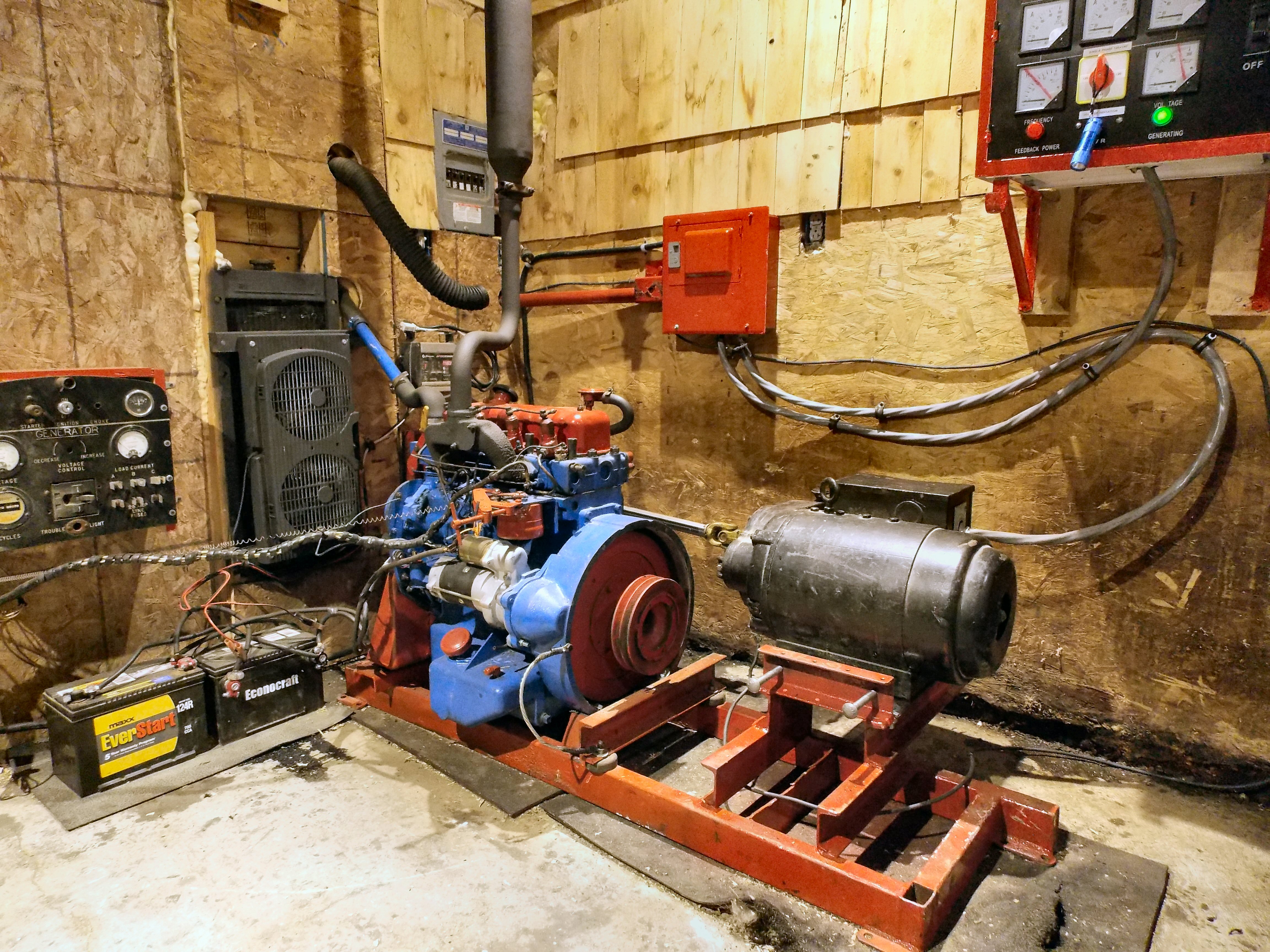

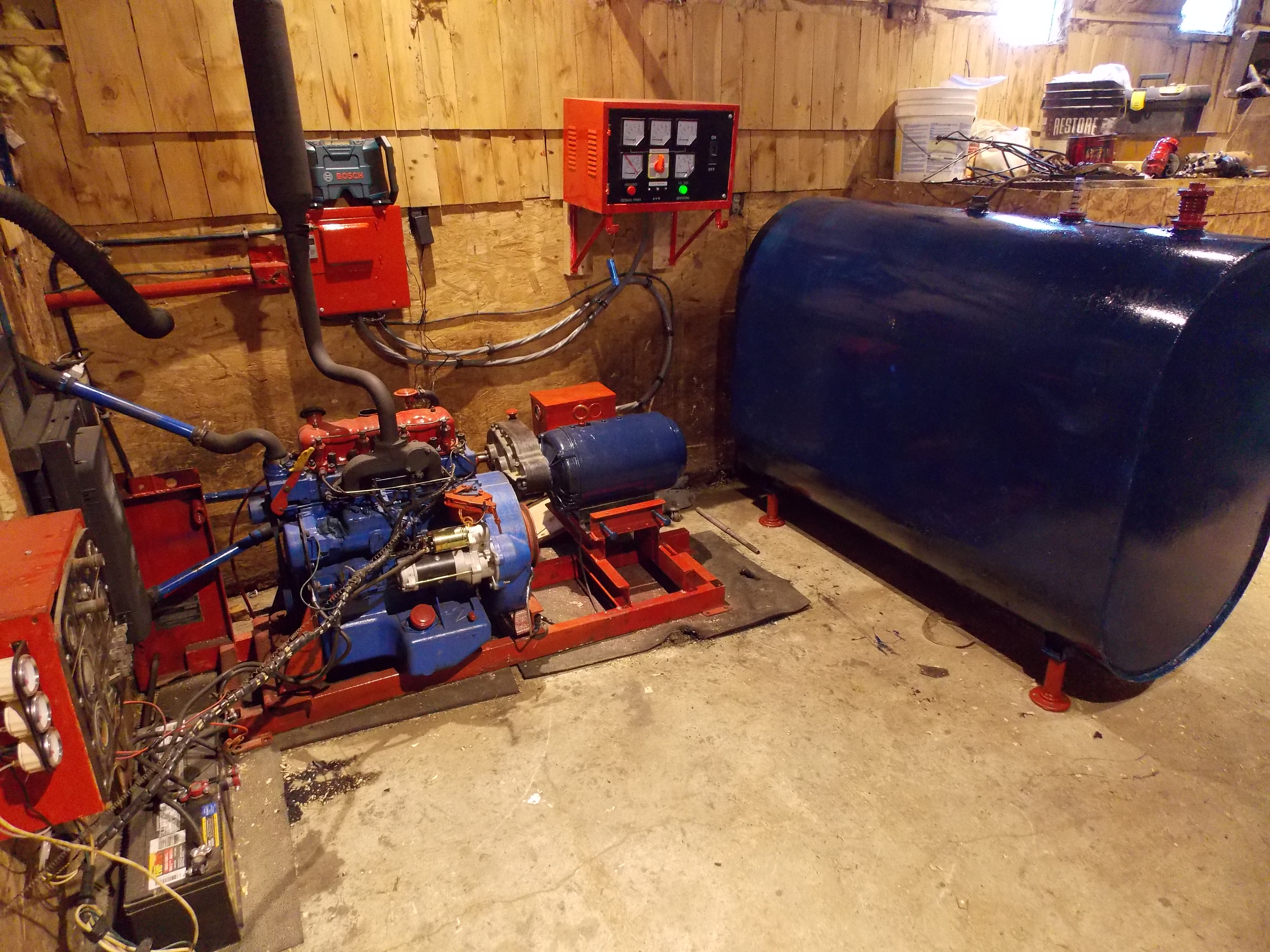

6. I have been working on my back up generator for awhile, but really have got a lot done these last few months. It is a very long-term project, but is coming along nicely. We are a lot better off now then when we were a few weeks ago, so I am very pleased with how this job is turning out.

That backup generator setup looks great, as well as all your other projects, you are a very busy man. It's good that your daughter is able to be involved and helpful too.

The generator came out better than what I thought it would. Of course, had I known what it would take for work at the start, I would have never even started. But it is working out well. I just got a few small things to do on the engine, like get oil, coolant, and then fuel to it, and it should go. The fuel system will be the hardest part as it is a nightmare of different fittings.
Once that is done, and the engine is running, I need to belt the generator and the engine together. The pulley sizes are not right however. It has a double v-belt sheave on the engine now, but it is 7.5 inches, and I need a 18 inch pulley on the generator end, and only have a 15 inch pulley off an old sawmill, so I might need to machine my own pulley. The only other thing I can do is put a 3 inch pulley on the engine and go to the 15 inch pulley; that might work too.
