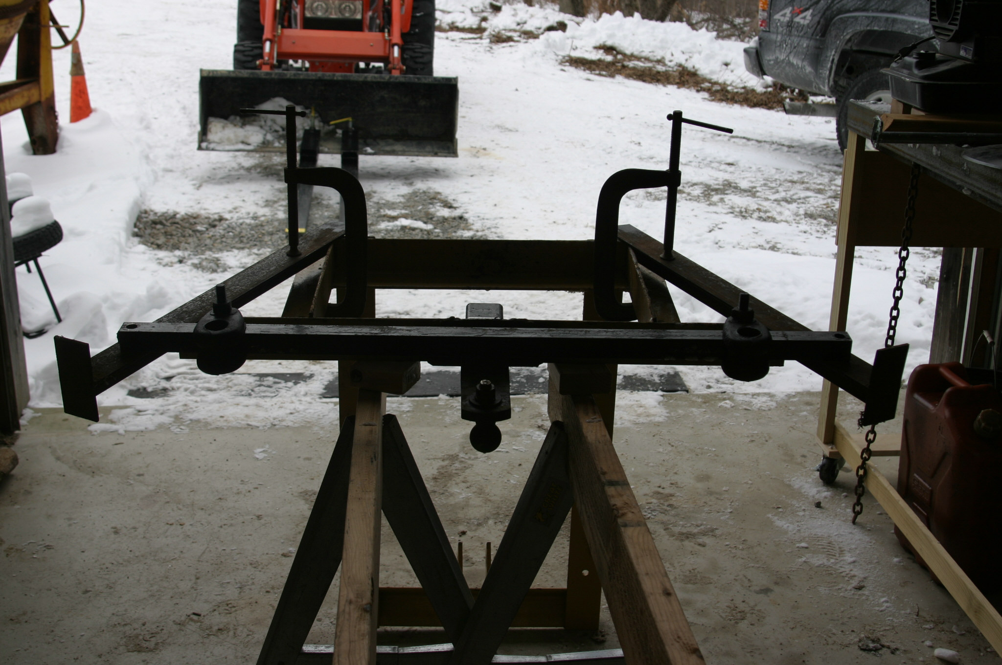

I dot have a tool bar. I have 3pt hay spike that I never use that I could use.
The toolbar that comes with the attachment I bought is 1 1/4" solid square bar stock. When you use it with the wedge-clamps it allows width adjustments.

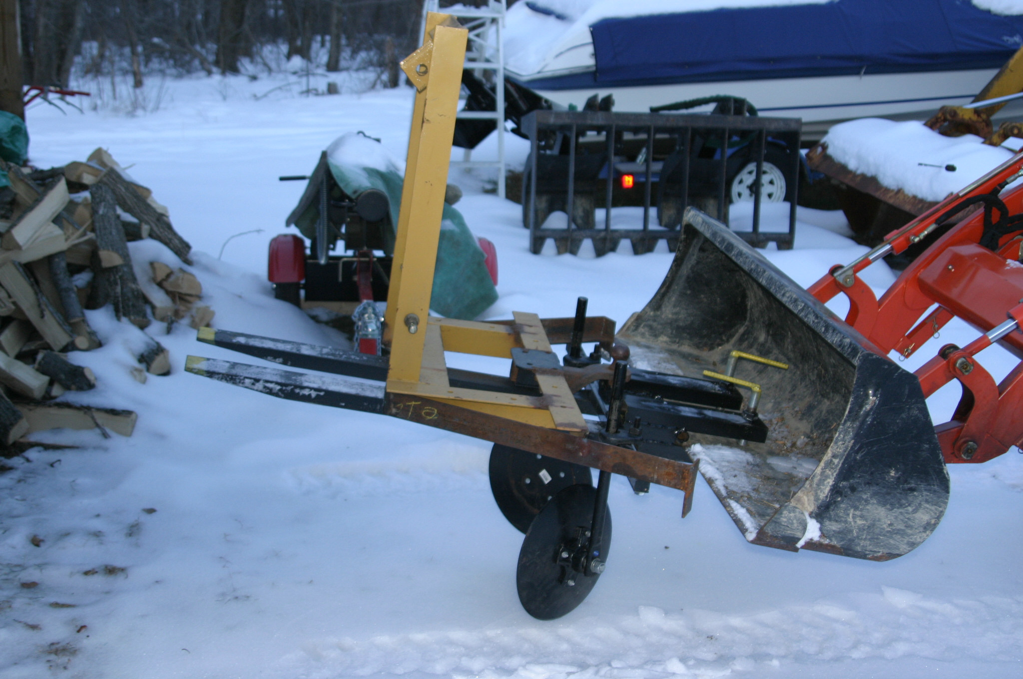

I built one with about 15' of 3" angle iron, three pieces of flat steel and about two feet of channel. The most significant costs were the discs and one cost I did not see coming was the extra long top link. The pins were about $20. Got the paint yesterday but am thinking about adding a trailer hitch first.

That looks sturdy, and adaptable to other stuff in the future.
Here's mine, can't wait to try it out..
