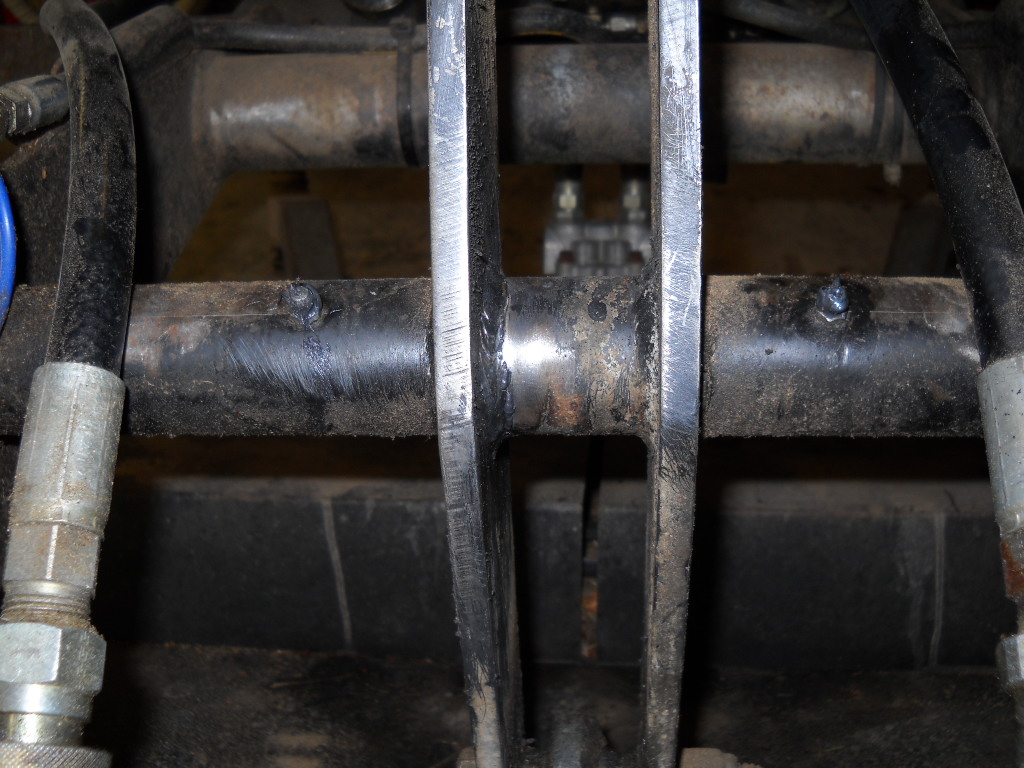

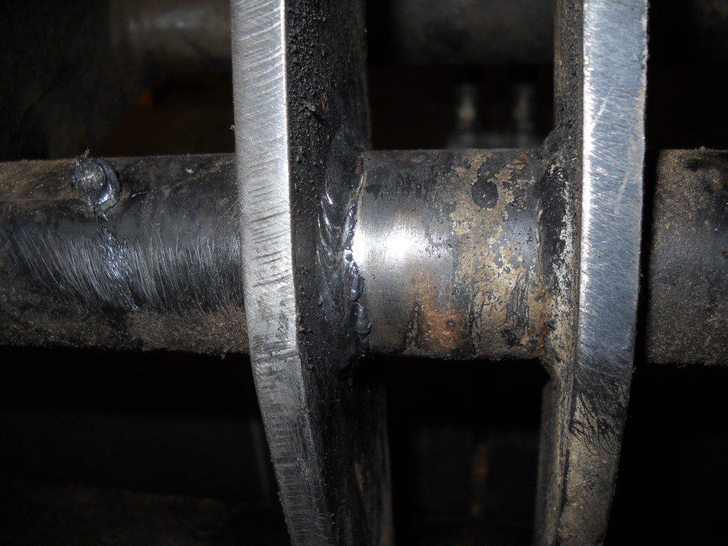

When I was greasing my rollover arms today, I noticed grease coming out between the rollover arms just inside the weld. Looks like the tube is cracked. The outside welds look good. Should I.
1. Continue to enjoy and use the PT and wait for it to fully fail.
2. Put in a new rollover arm assembly.
3. Weld some plates between the arms to strengthen it.
4. Something else.
   / Anyone have problems with the Rollover Link #48
Can you get a picture, Bob?
Can't find the camera, but borrowed nephews. See attached. The break is on the left side between the two arms. You can see a little grease oozing out. It looks like I could weld a plate between the two arms and strengthen this.

   / Anyone have problems with the Rollover Link #49
Bob,
It remember someone else replaced their rollover link with a newer assembly, that was had a thicker center and wall thickness.
   / Anyone have problems with the Rollover Link #50
Bob,
That would be best, I am sure. It looks like you have to do a lot of grinding of welds to remove it. Is this correct?
