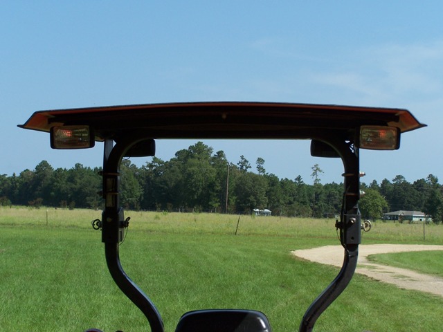

This is my setup, the lights work a lot better mounted to a canopy because of the angle in relation to the loader

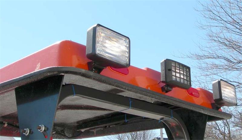

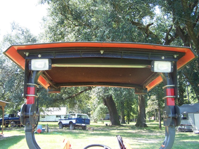

I used 2 trapezoid 55w on the front and 2 flood 55w on the rear. The lights are wired to 2 switches mounted on the dash (1 front and 1 rear) that operate two 30A relays with primary power directly from the battery and trigger voltage from the key switch. The switches are simple SPST with marine type screw-on rubber boots to protect them from the elements.
I am very happy with this set-up.
