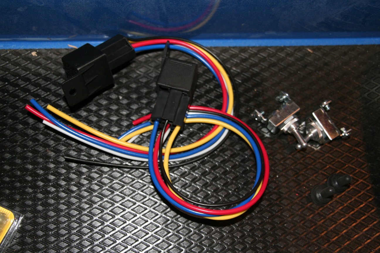

- I added a new 30 fuse on a 10G wire I ran right from the battery terminal to power two worklight circuits (rear and front).
- I used two automotive 30A relays ($5.99 each at Princess Auto).
- I used two toggle switches with marine rubber boots - purchased at NAPA. I don't have the invoice in front of me but the switches were about $9 each and the boots were $13 each!. I was not able to source them locally elsewhere for cheaper so I just bit the bullet even though I'm pretty sure I way overpaid.
- I ran two 14 guage wires from the relays to the rear of the tractor to power my worklights.
- I used the factory worklight ciruit as the trigger voltage for the relays.
- I used a lot for information from this thread including bjcsc's modified wiring diagram (original posted by bigballer). While in my setup, the switches are rated at 20A anyway, I decided to get the to control the trigger voltage reaching the relays rather than using bigballer's original diagram which had the relays close as soon as the key swtich was turned on.

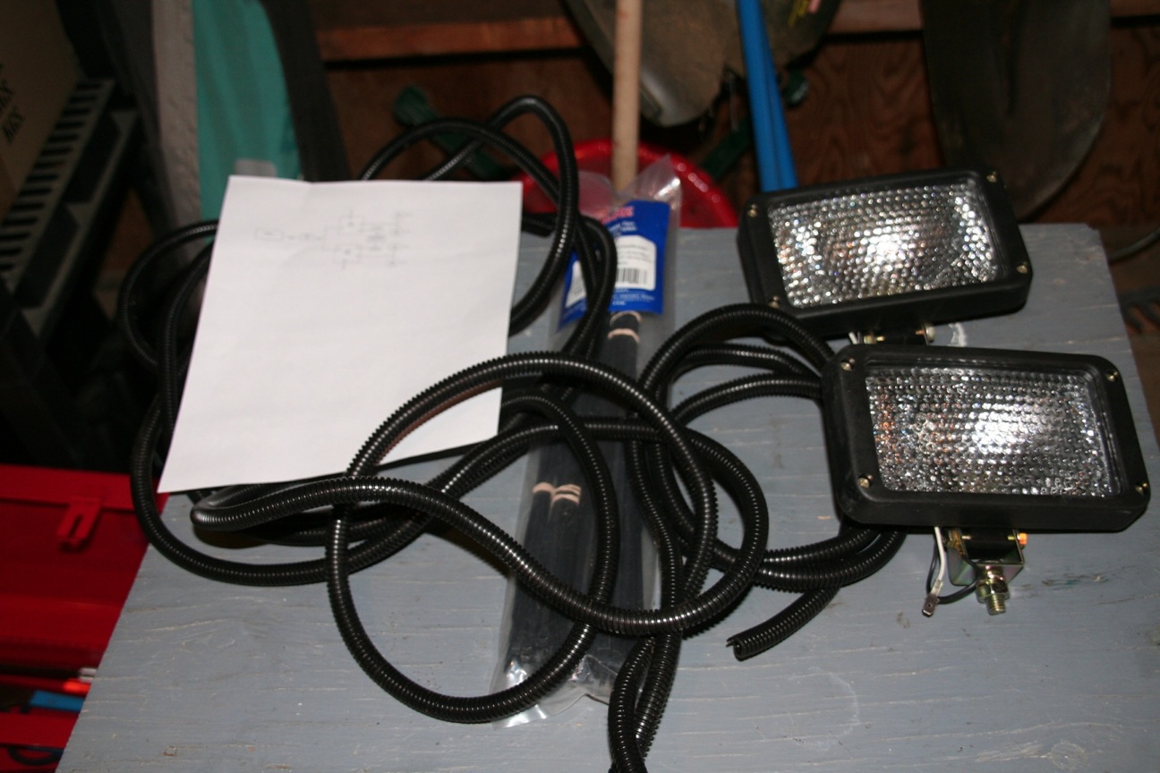

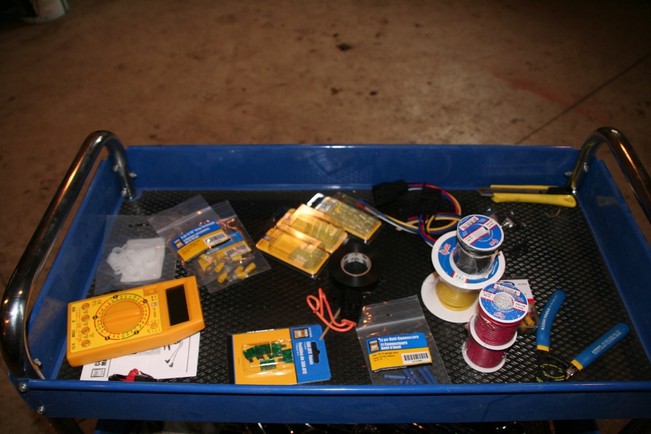

Worklights1: Most of the components. Two relays, two switches, various connectors, 10G wire, 14G wire etc.
Worklights2: 2 floodlights and plastic automotive housing.
Worklights3: Relays, switches and marine boots.

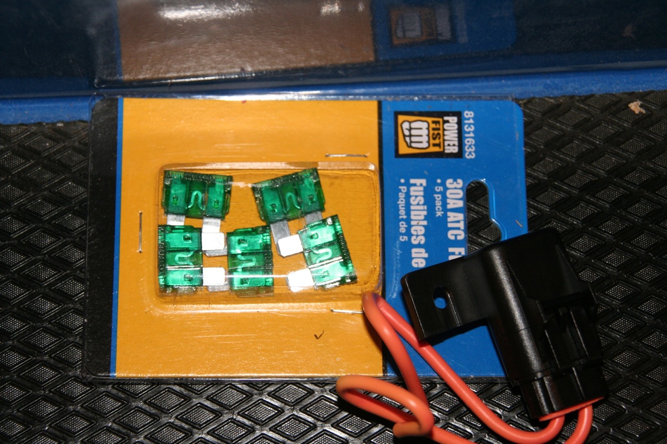

Worklights4: 30A ATC fuses and weather proof fuse box.

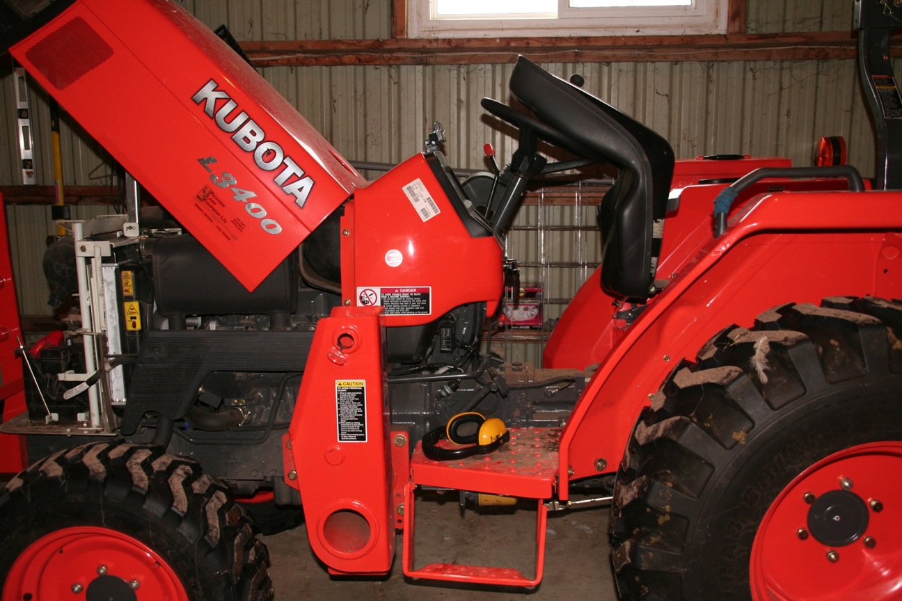

Worklights5: Tractor with loader and center hump cover removed and ready for work.
Worklights5.5: Close up of center hump with cover removed - this is a before picture for reference.

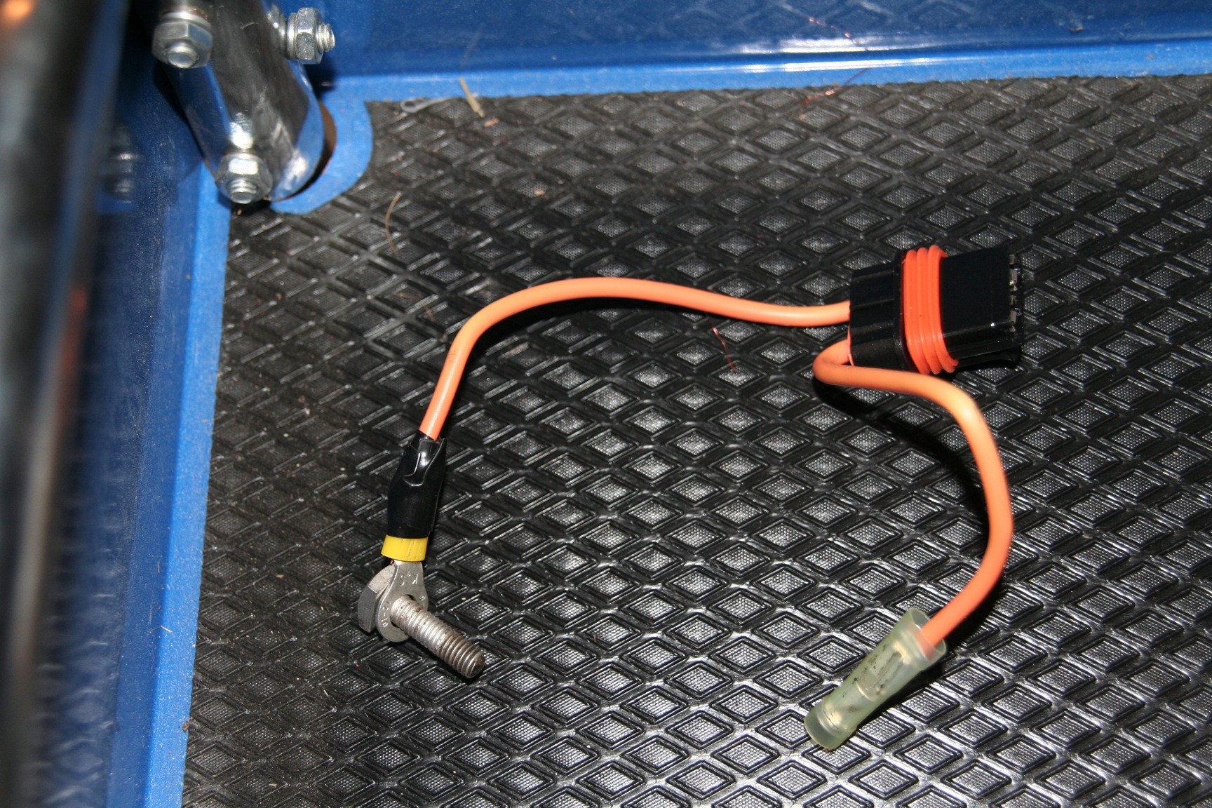

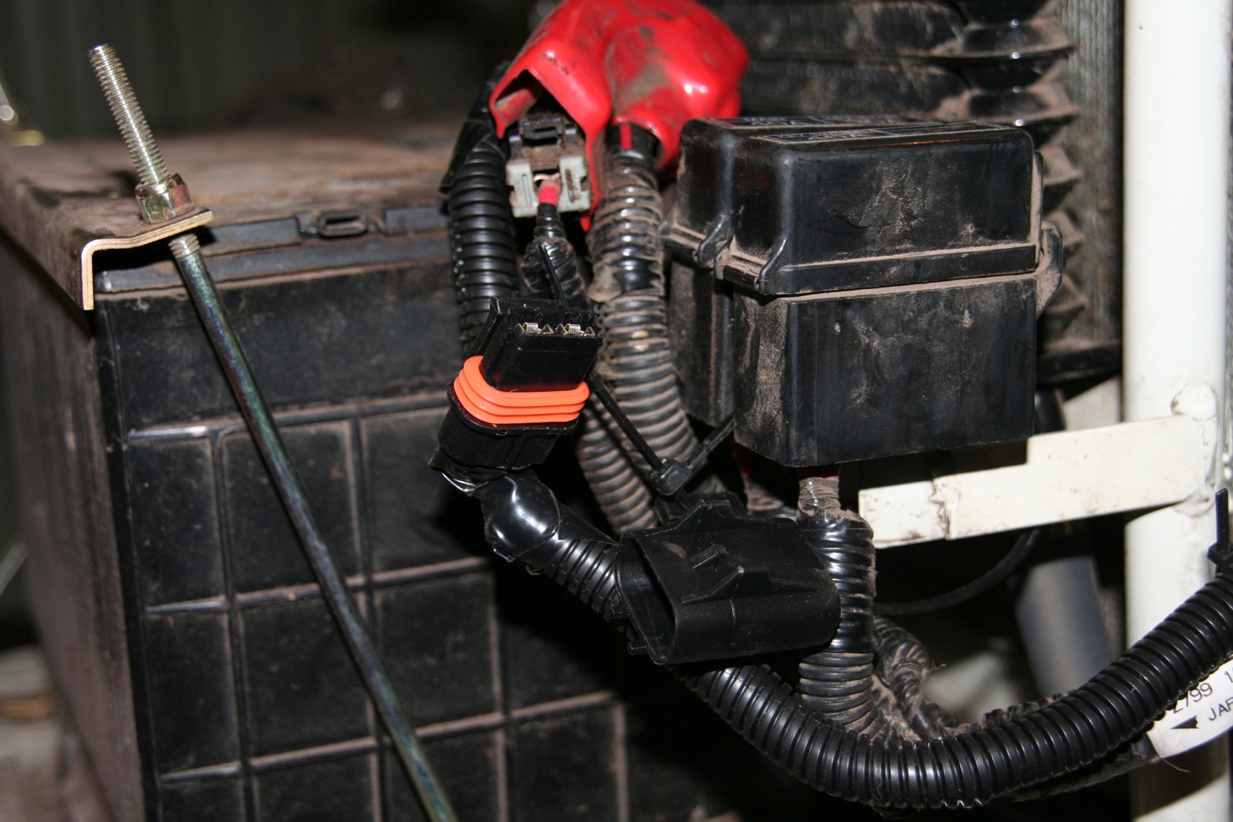

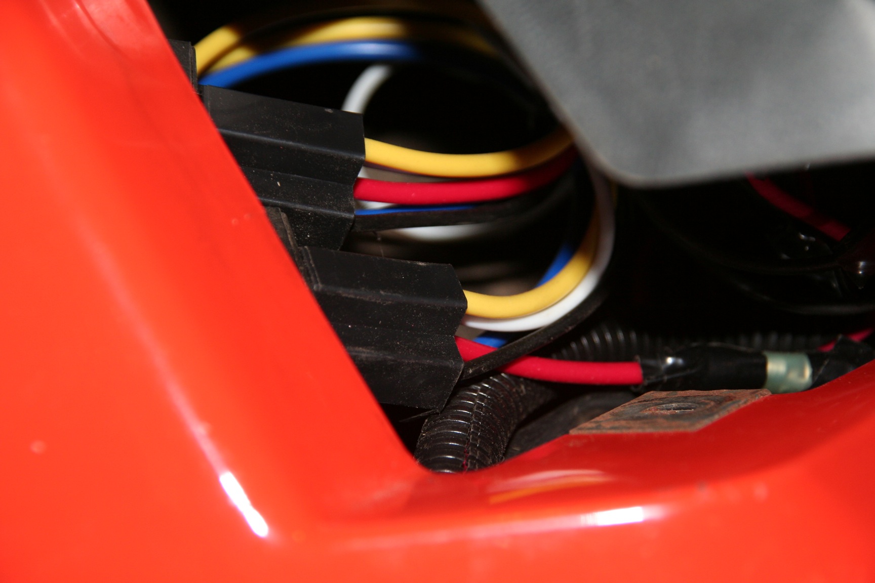

Worklights6: Fuse holder terminated with ring connector which fits the nut from the +ve terminal.
Worklights7: Fuse holder connected to +ve terminal. 10G main wire hooked up to fuse. Plastic housing in place around fuse holder and 10G wire.

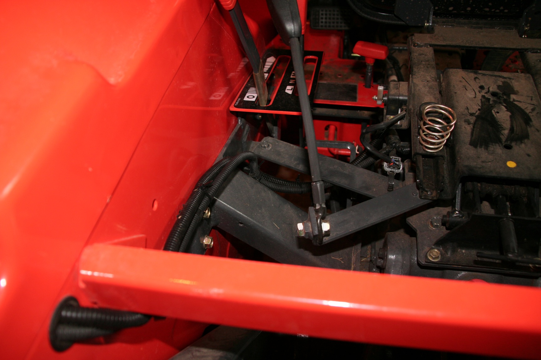

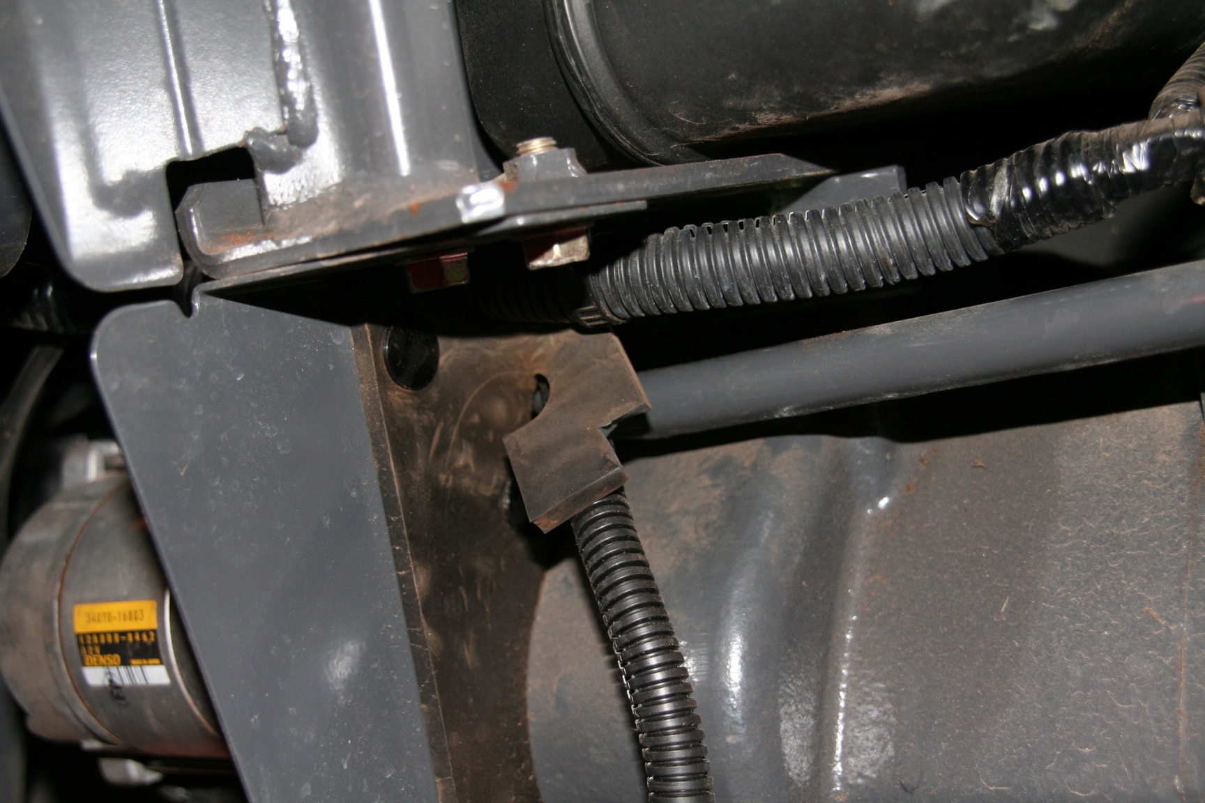

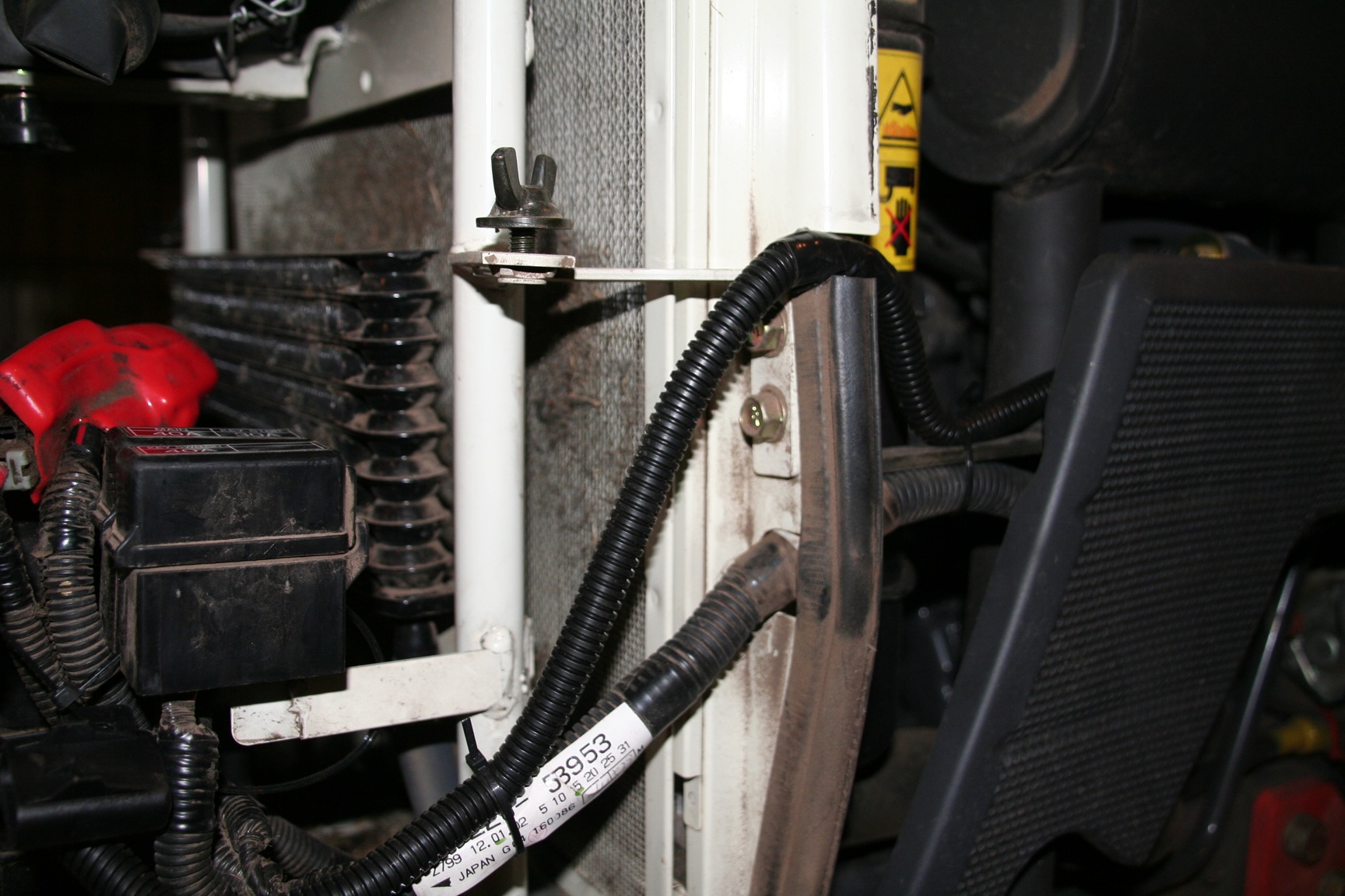

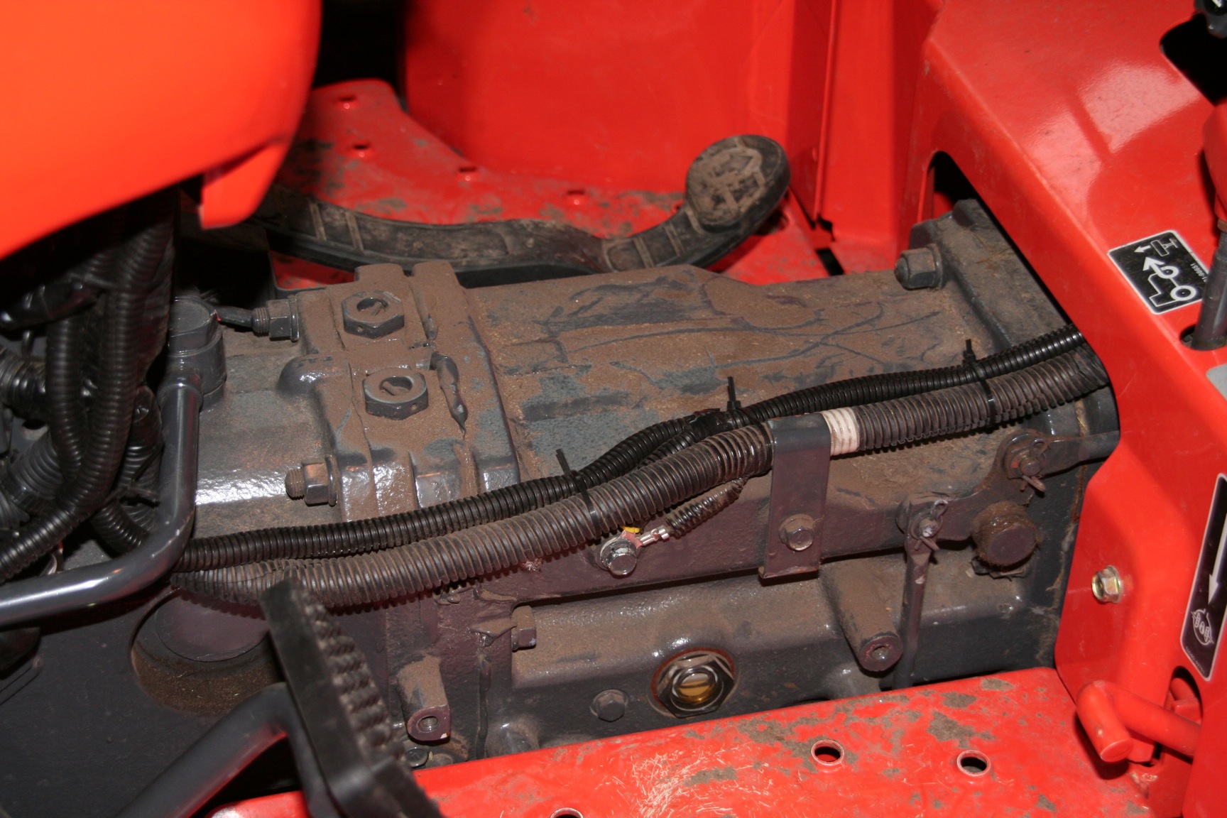

Worklights8: Routed 10G wire towards rear of tractor.
Worklights9: Found room near existing factory wiring to route new housing through. I cut out a little corner of the rubber to get the new housing through.

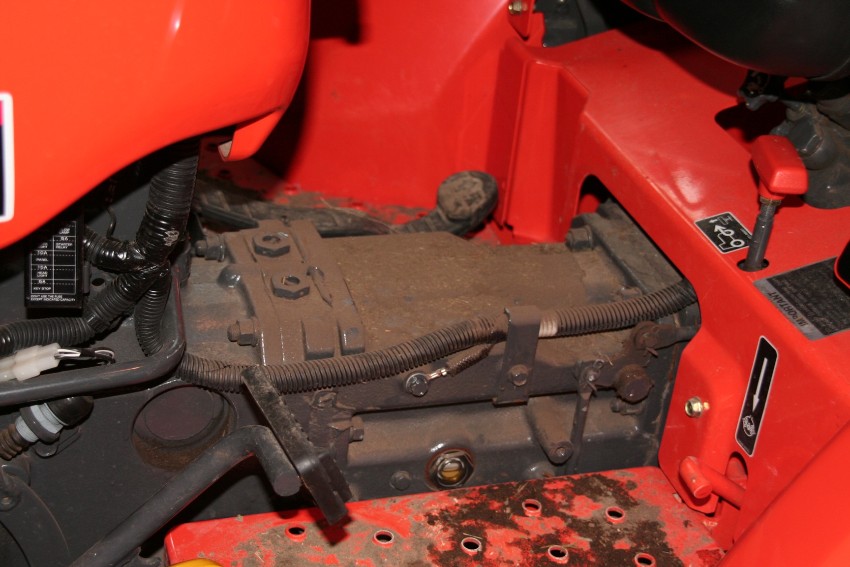

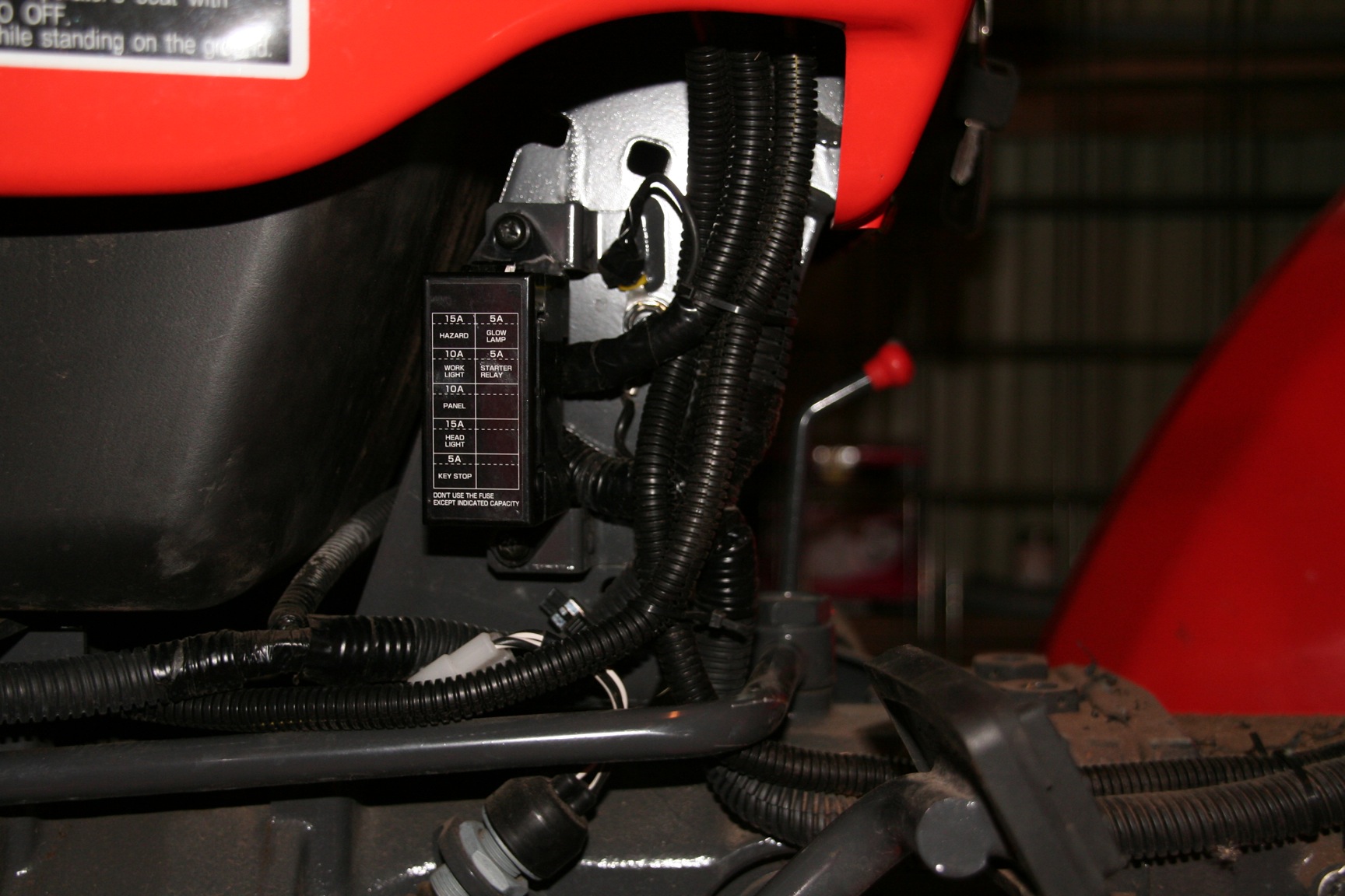

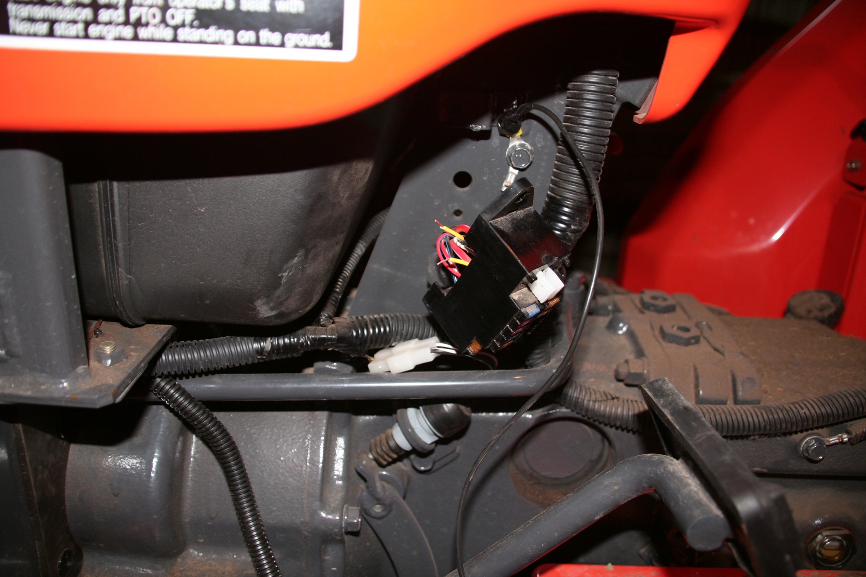

Worklights10: Factory fusebox detached and yellow worklight circuit wire cut to tap into for the trigger voltage for the relays. As a newbie I cut too cut too close to the fusebox and had to struggle a bit when connecting up the wires to take the trigger voltage upto the dash. When I hooked everything up, it didn't initially work. When I debugged it, i found that the connection to the trigger voltage had come off. Made moe worry about my crimping skills. I double checked all the other butt connectors. Hopefully they will hold up.
Worklights11: By the fuseblock there was a bolt that was being used for another ground wire. I decided to run a new ground from here my me to use in the dash for the relays. You can see that in the previous picture I have already hooked up a black wire with a ring connector to this bolt.

Worklights14: Cleaned up new wiring and housing around fusebox. I think I've got three new plastic housings going there. One for the 10G wire from terminal. Two for the trigger voltage wires from fusebox and new ground, and one to return the two wires that will power the worklight circuits. I was only using 3/8 plastic housing. The housings have been zip tied neatly so that the fusebox is still accessible.

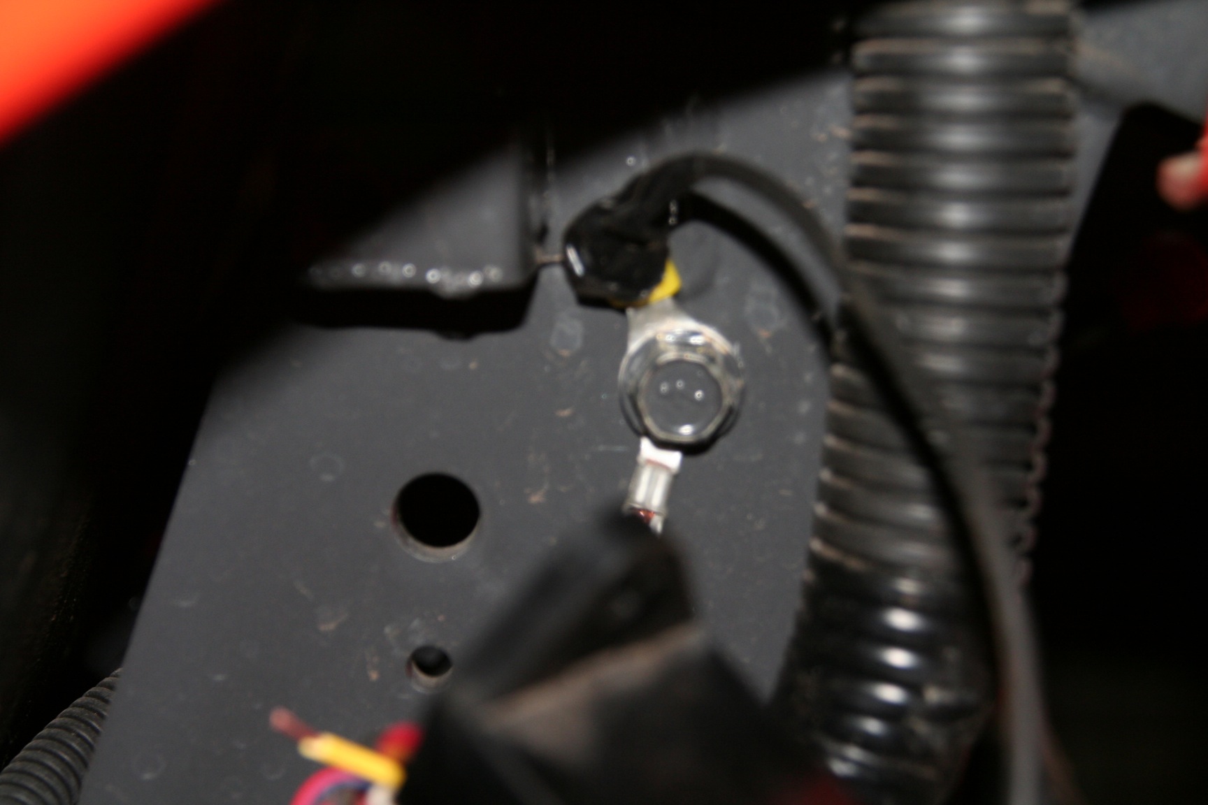

Worklights 17: Towards the middle of the housing there was another bolt that was used as place for ground - a wire from the factory housing tapped in here for ground. I decided to also run a ground wire from here in my new housing to the rear in my new housing - for use as ground.
Worklights 18: New wiring is secured with zip ties to existing factory wiring and taken to the rear left fender.

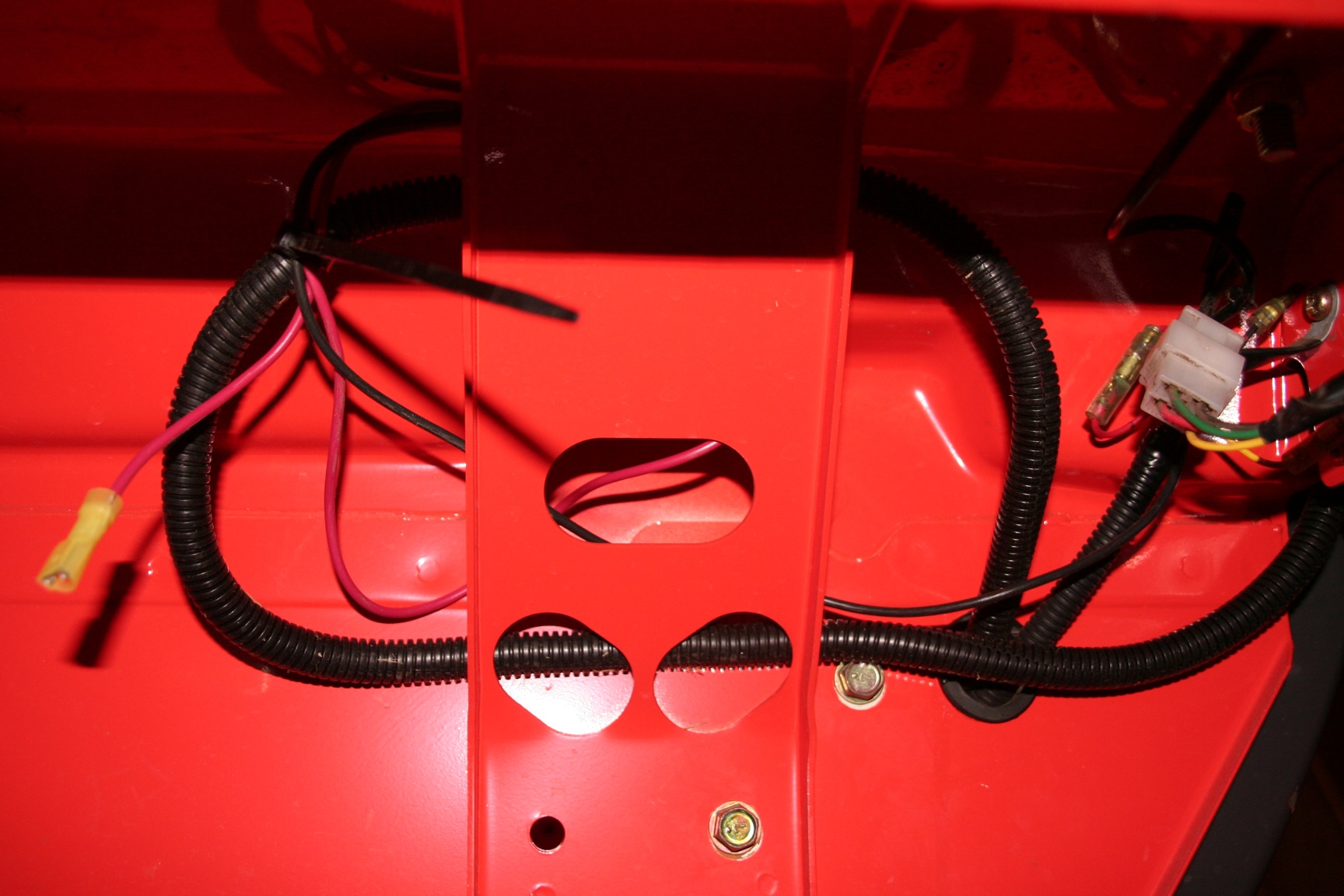

Worklights 19: I am only using one lighting circuit for a single temporary flood. I have secured the rest of the wiring under the fender with a zip tie.

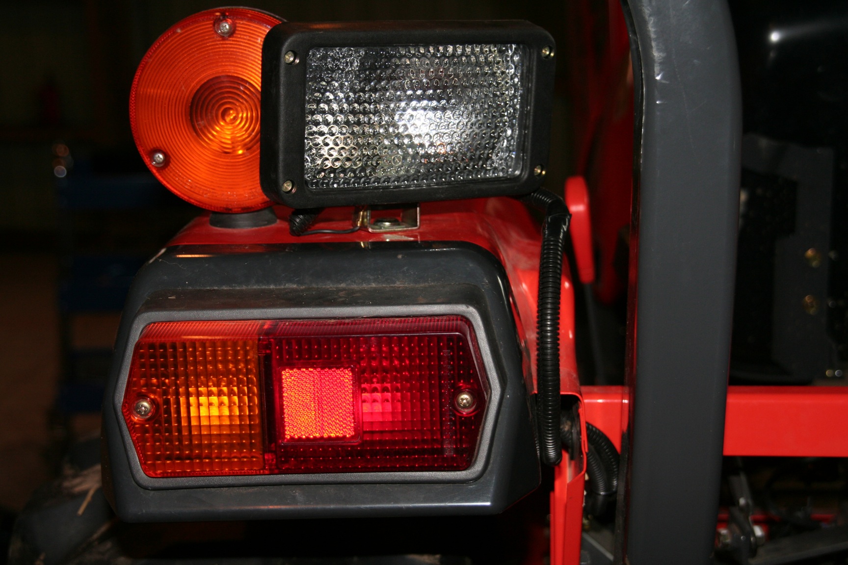

Worklight 20: One flood light attached at rear to pre-existing hole in the fender. If someone is looking for only rear floods, this is a pretty sweet spot to mount an oval flood. Each fender has these holes. A 4x6 is not a good permanent setup here as it covers part of the flasher. This will work for now for a bit of snow blowing in the night until my sunshade gets delivered.
