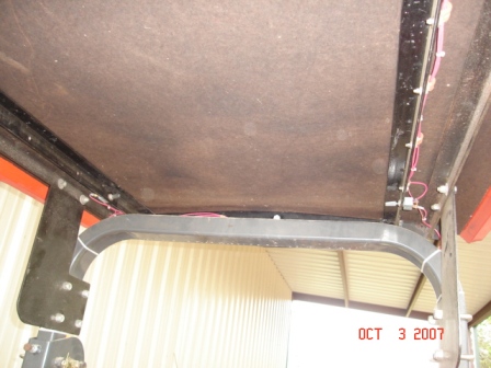

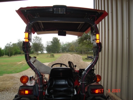

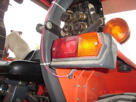

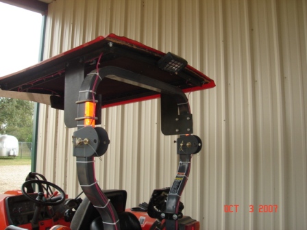

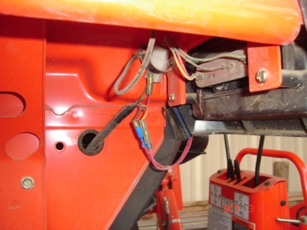

I Just took some pictures of my Light install.
The key only has to be on to supply power to the lights.

That looks like what I want to do. But, I'm still confused (I'm easily confused). It looks like you are wired right into those leads under the fenders, one to each light. I did not see an additional switch, so how do you turn them on and off? Do they come on every time you turn the key to on?

The key must be in the on position (the tractor does not have to be running) for the work light to work. You still have to flip the switch on the work light, but it is independent of the headlight switch.
I am wired to the wires right under the fenders, the r/h side for the rear light and l/h for the ft.
Look at picture 33 there is a switch on on each side under the canopy.
