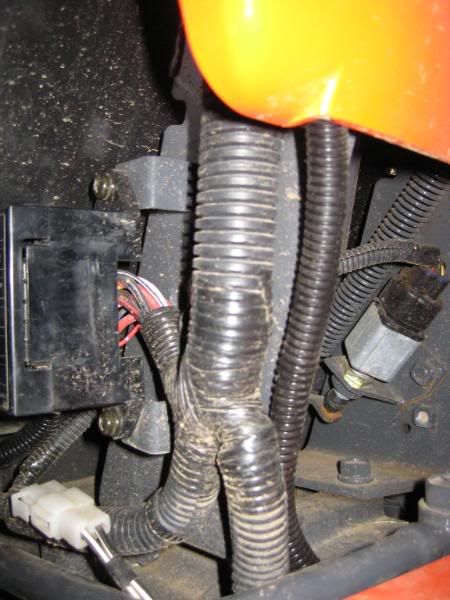

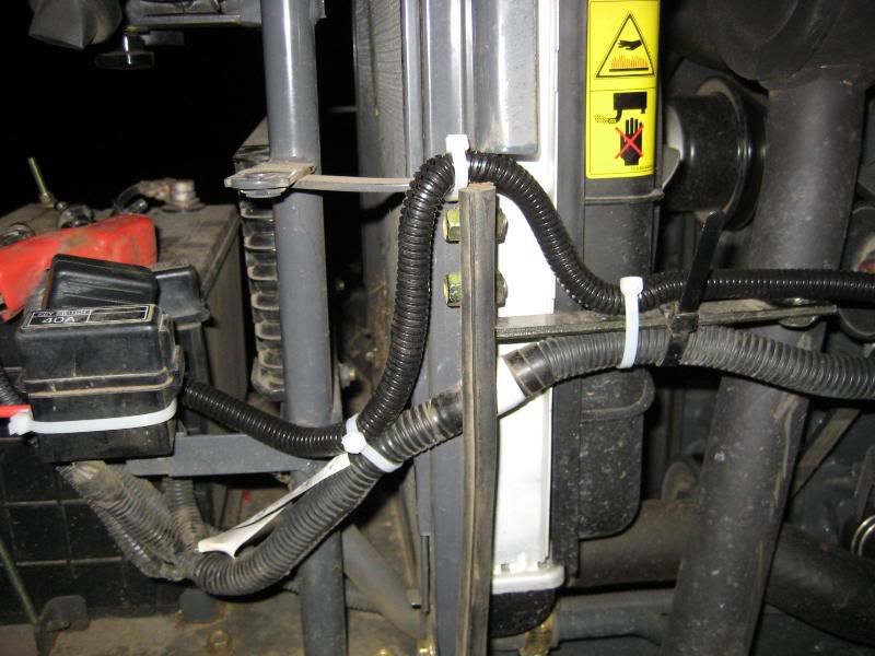

Here are some pics of my wiring off the battery - 10gauge wrapped in split loom, you can see it's the darker, newer looking loom. i wanted to run it in the same loom that's already in place but would have required cutting electrical tape, etc so i just ran a new one along side it.
   / Anyone have worklights installed on their L2800/L3400? #39

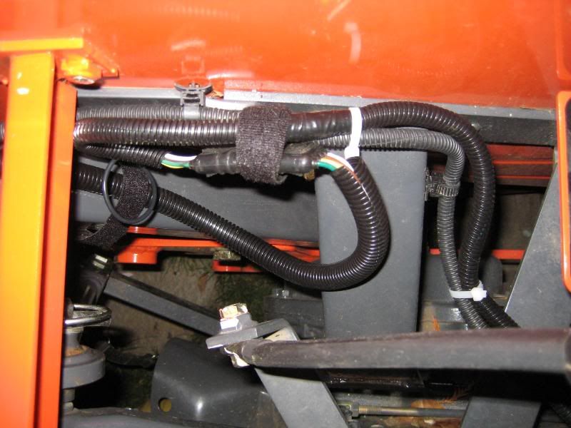

the wiring that runs from the relay (which i mounted behind the dashboard) is housed inside the loom as well. this runs from behind the panel, down alongside the fusebox, then under the middle floor cover (which I removed to run the wiring), then it follows along the seat to the left hand side where it terminates at a 4 wire trailer hookup.
down from dashboard to the floorboard:
coming out the other end of the floorboard:
trailer hookup held in place with industrial velcro wrap, this allows for easy removal of the lightbar (seen later), if needed:

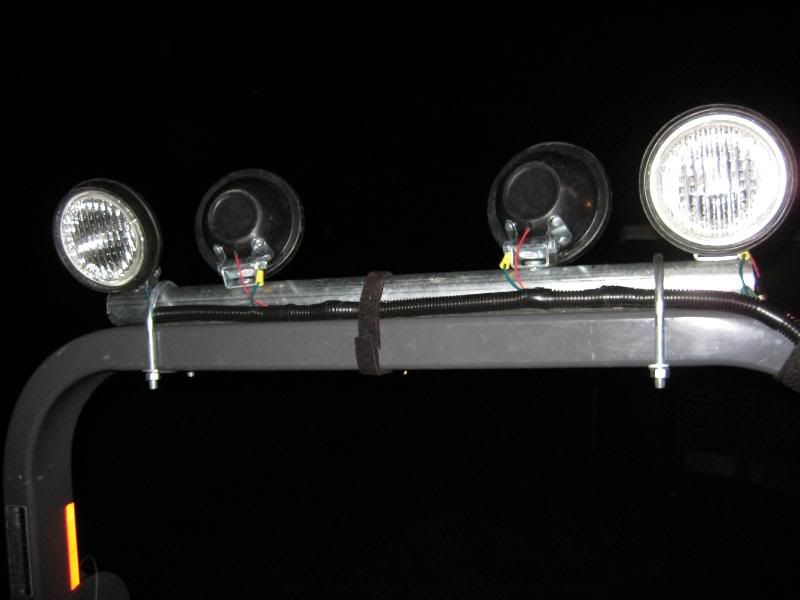

Lightbar, mind you this is Version 1.0 - i don't like the bar and am now looking at changing this out to a unistrut. it works i just don't like the looks of it. all wiring runs through the loom and connects to the trailer hookup.
down the side of the rops:
