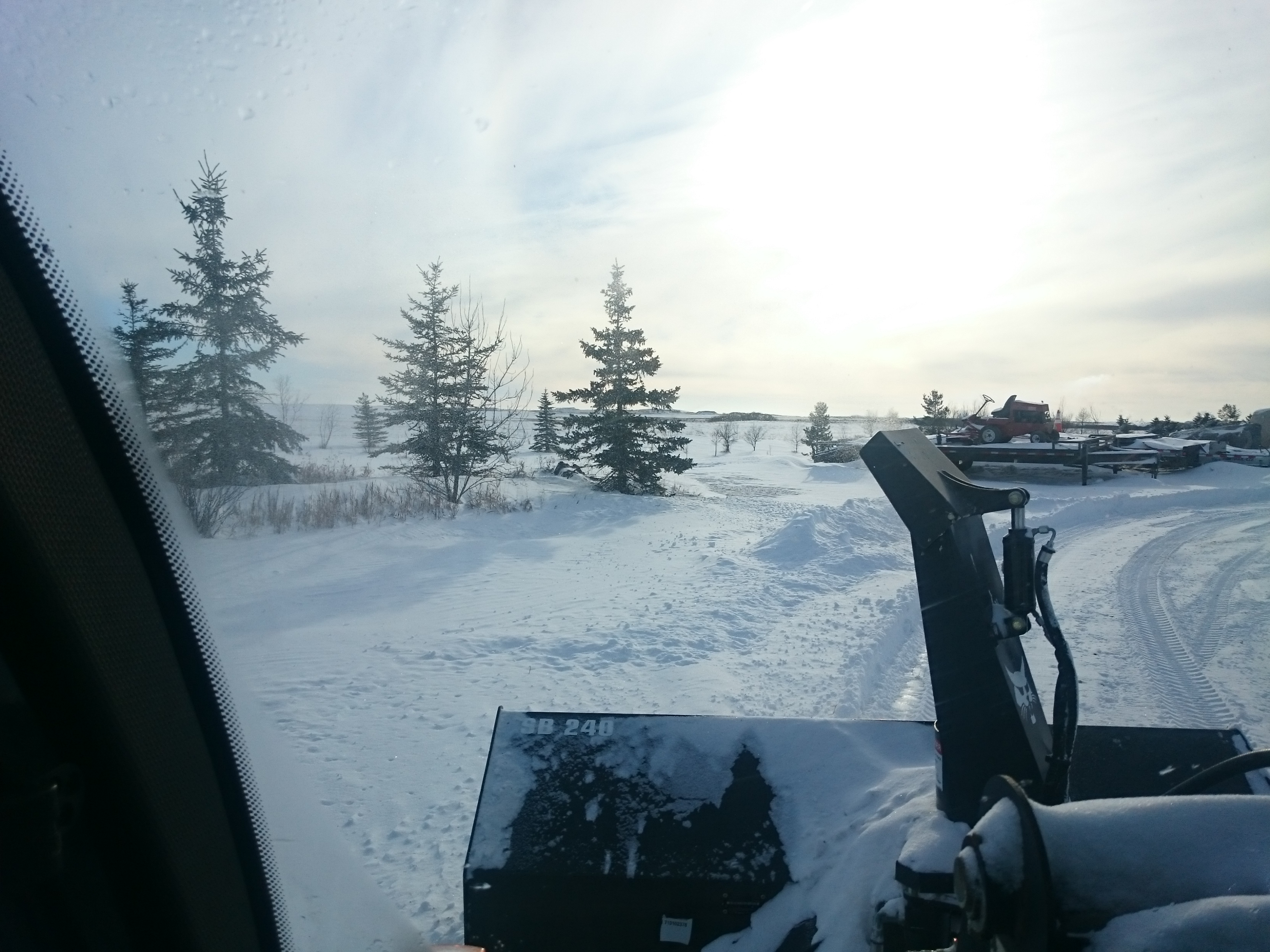

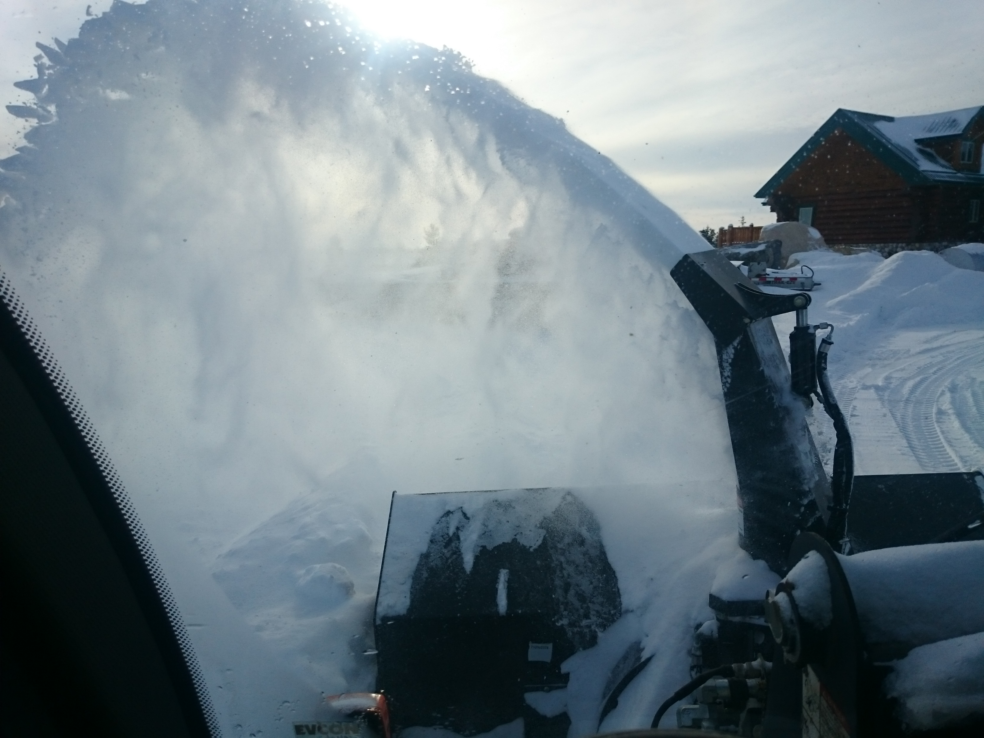

quick update, today we had 6 inches of snow, got the Toolcat going and played with the blower, its throwing is decent considering the blower is high flow and Toolcat is standard flow, going thro drifts of 2 feet the throw was 30 feet and down to 20 feet if I pushed it, not sure I like the 2 toggle switches in the center console to control the blower but its how the kit arrived.
all in all the kit was worth the price and nothing better than blowing snow in a comfy cab

here is the result
