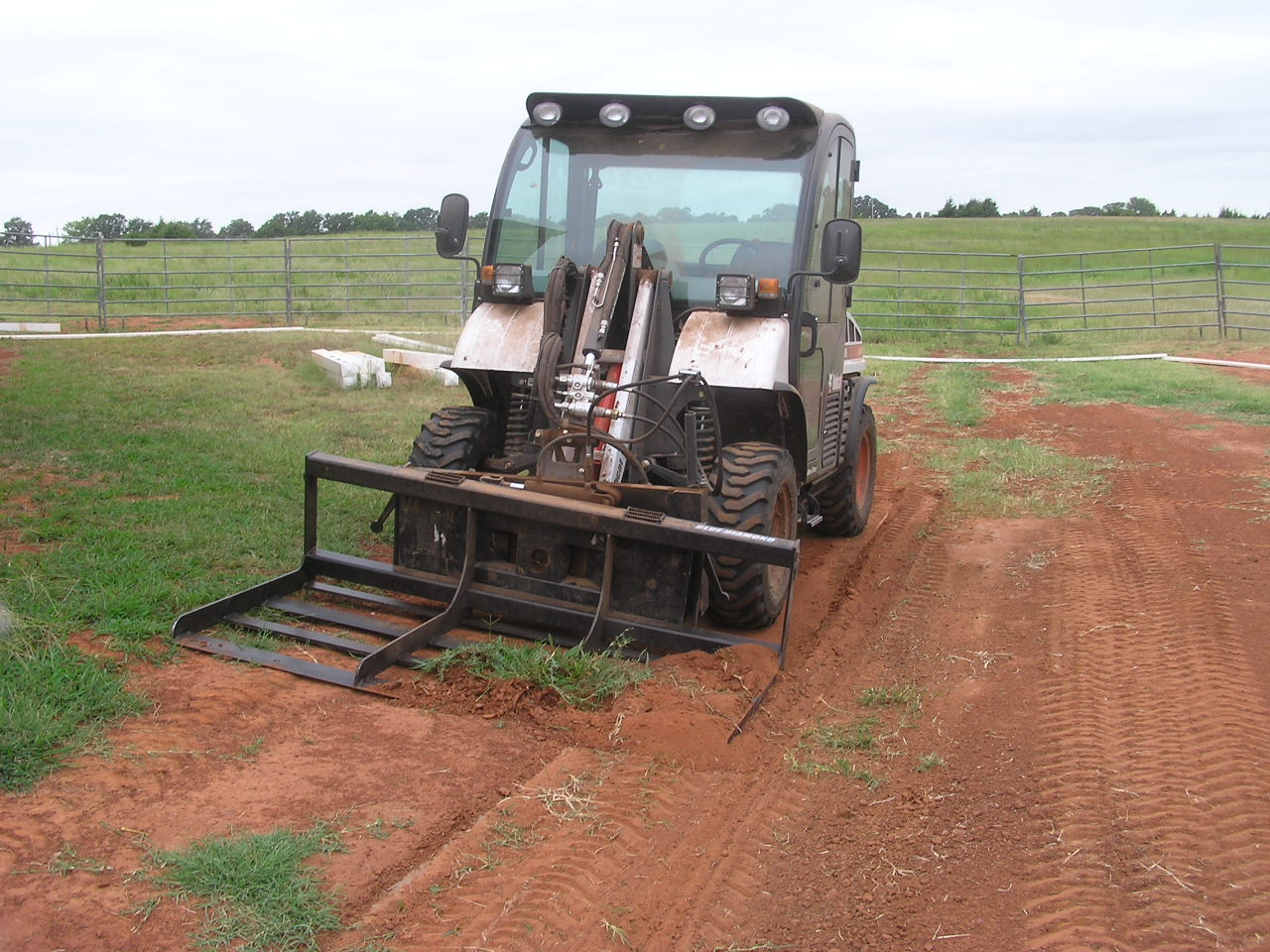

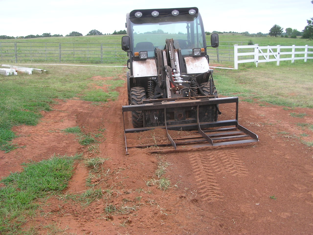

I have a skid steer style 6 foot wide land plane on the front of the 5 foot wide Toolcat. Works gooder-un in the clay.
Have not used it much on gravel yet, but I need to.

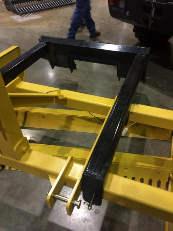

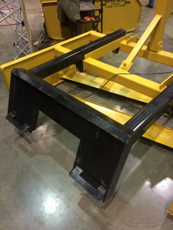

Here is one way to convert a 3 point land plane or box blade for light duty work:

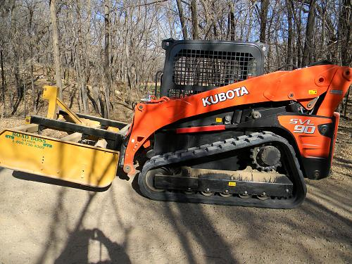

I have a roadboss like xfaxman posted and have pushed it literally hundreds of miles with skid steers and it works great. I have never connected it to a tractor. As others have said I don’t think tractor loader arms would handle the stress.
