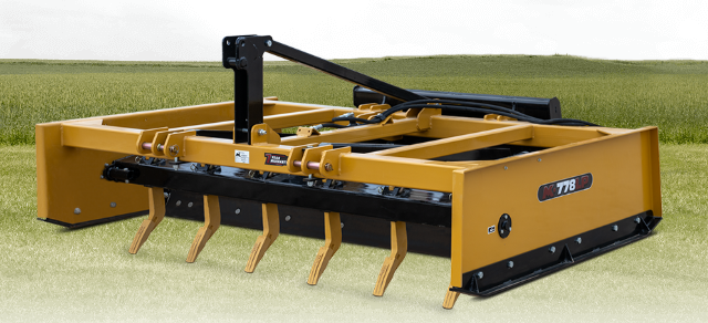

I'm looking for a HEAVY duty land plane. Several years ago, I purchased the largest version EA had, and it was great. I sold that farm a few years ago along with all implements. I just purchased a new farm, and along with the massive sticker shock of equipment these days, I was equally unprepared to find that EA was defunct. I would have ordered another land plane immediately, as the last was great.
Anyone have a good heavy alternative for an 84-96" landplane? I'd prefer one with scarifier shanks as well, if possible.
I have not done the research for a 8' land plane. However for a 7' The heaviest are the following
MK Martin LP778, 1240 lbs, has hydraulic scarifiers. Land Plane
Road Runner CH7, 1200 lbs, no scarifiers has hydraulic blade height adjust. https://roadrunnerblade.com/equipment-attachments/tractor-grading-blade/
Road Boss Commercial 7, 1100 lbs, no scarifiers Road Boss Commercial Graders - Road Boss Grader
Bush Hog CG84, 988 lbs, has hydraulic blade height adjust. CG84 Series Road Grader - Bush Hog
Cammond GSI7, 935 lbs - no scarifiers BUILT TO LAST Made in the USA
The EA plane was 786 lbs. The ones listed above are much heavier duty.
Never seen one with retractable scarifiers. That would be a nice feature.
MK Martin makes one. It is the only one I know of.
MK Martin makes a nice unit with retractable hydraulic scarifiers. Land Plane
