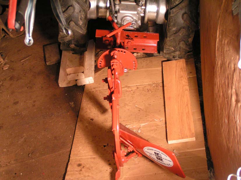

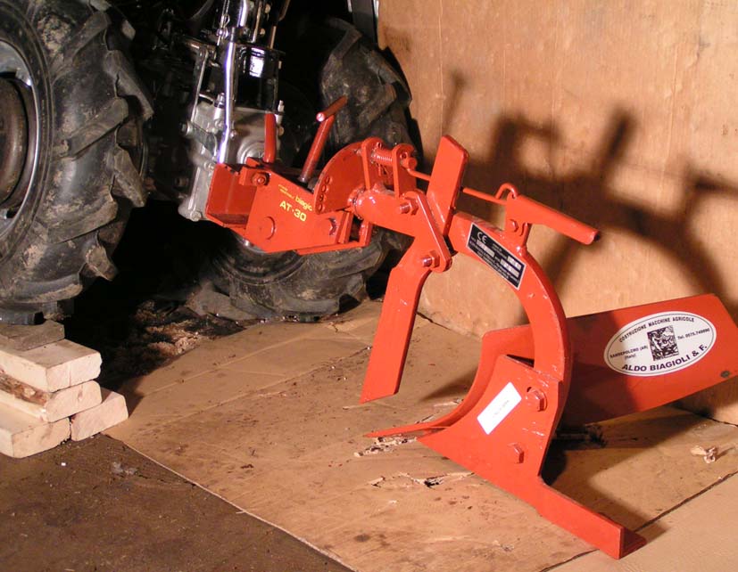

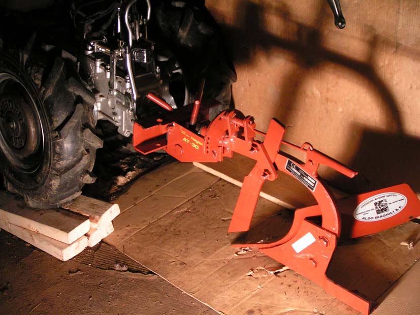

Hi! I have now my new moldboardplow. Thanks to ALDO BIAGIOLI&FIGLI the maker very wellmake . I like the fully adjustable hitch (A NEED). I look for setting and possibility with my GRILLO 107d. I find I need 15-16 in. (40cm) between or inside wheels. For possibility May be 6-7 in. (18cm) in. max width and 5-6 in. (15cm) max. depth This could be OK for me. I could try this Plough next spring. I am working on new steel wheels.Good luck ! Oldmech
