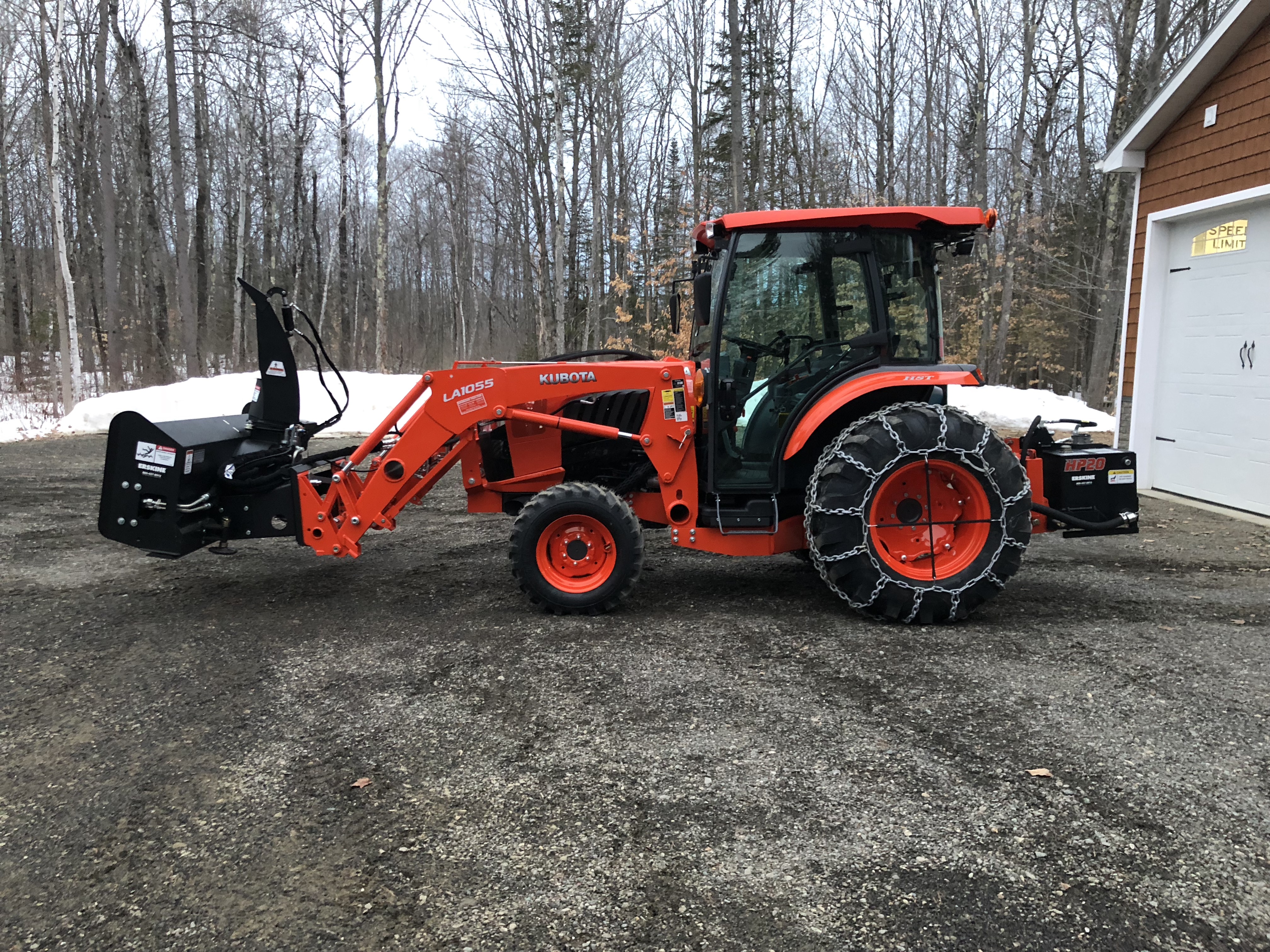

I have a Kubota Grand L6060 with a erskine 79" hydraulic snowblower and I find it has plenty of power to blow away all my snow. Can I bog it down? Of coarse, but with a little common sense I can move a whole snow bank with it. A snowblower can require a lot of horse power if you believe you have to go as fast as when plowing. A plow will move the snow faster, but can leave a very large snow bank by the end of the snow season. Resulting in a much smaller driveway or parking lot. A snow blower will be a little slower but at the end of the season your parking lot space is the same. A statement that a 60 hp tractor don't have the balls to run a 84" blower sounds like a knee jerk answer or inexperience.

I have an 8' Fisher plow up front and a WoodMaxx SB-84 on the back of my Mahindra 2655 HST Cab with 44 PTO HP and have no issues. You need to look at the snowblower and consider how much volume it is capable of moving. A large diameter impeller with throw the snow further but will also require more power to do so. A deeper impeller throws more volume of snow. You need the right balance. The SB-84 has a 24" impeller and it's 7" deep. You don't want one with a 26" or 28" or bigger diameter and 9" deep or you'll definitely need a lot more HP to run it, the HP curve required is not linear. Be reasonable in what you're trying to do and you'll be fine. I don't know why more people aren't buying the WoodMaxx than all of the more expensive brands. It's built better than others I looked at and it's under $3k new delivered with full hydraulic or electric chute and deflector controls.

I totally disagree that 53 pto hp can't run a 80" blower
Had a great long reply typed and it disappeared so you get a short version
I run a 74 inch rear pull with 35 pto hp and can go max speed b range in up to about 5 inches ,uphill speed does drop a bit. There are many commercial services using an l6060 with good results, usually they are going to that size for congested areas.
In my experience i get a better result in less time than with a rear blade ( front blade would be better than rear but i don't have one)
The difference comes in the lack of spill , slumpage back into the cleared area and the eliminating of moving the snow more than once. Oddly shaped and congested areas really favor the blower as they are tough to blade and the piles take up space etc.
I believe that there may be significant differences in efficiency in both the blower itself and the drivetrain which may explain the difference in perception
in my case plow only would be a pain as we rarely get huge snows but normally get many days of small to moderate snowfall. the blower saves time in eliminating the need to move back piles over my .6 mile road and 5 associated drives and pullouts
