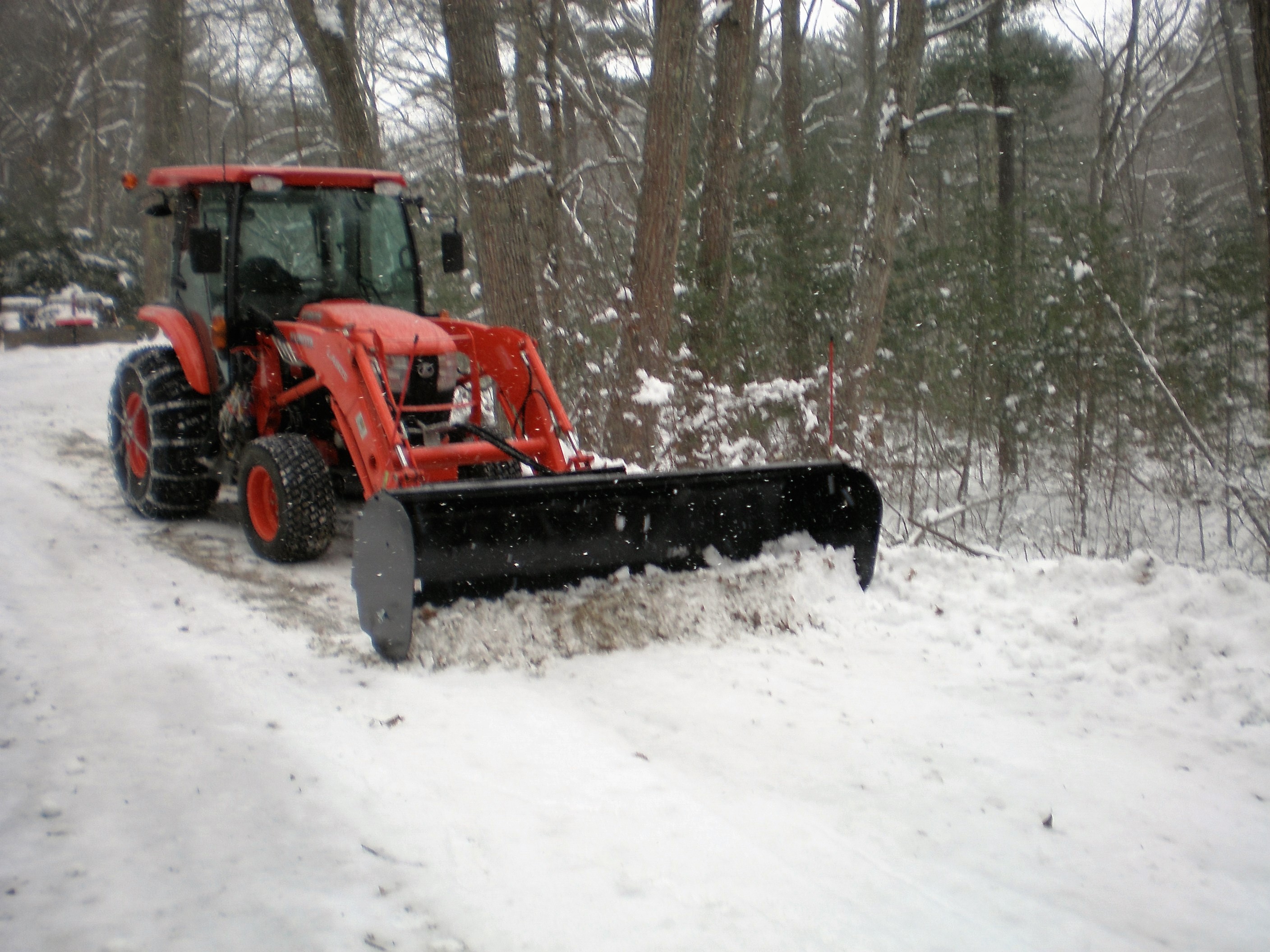

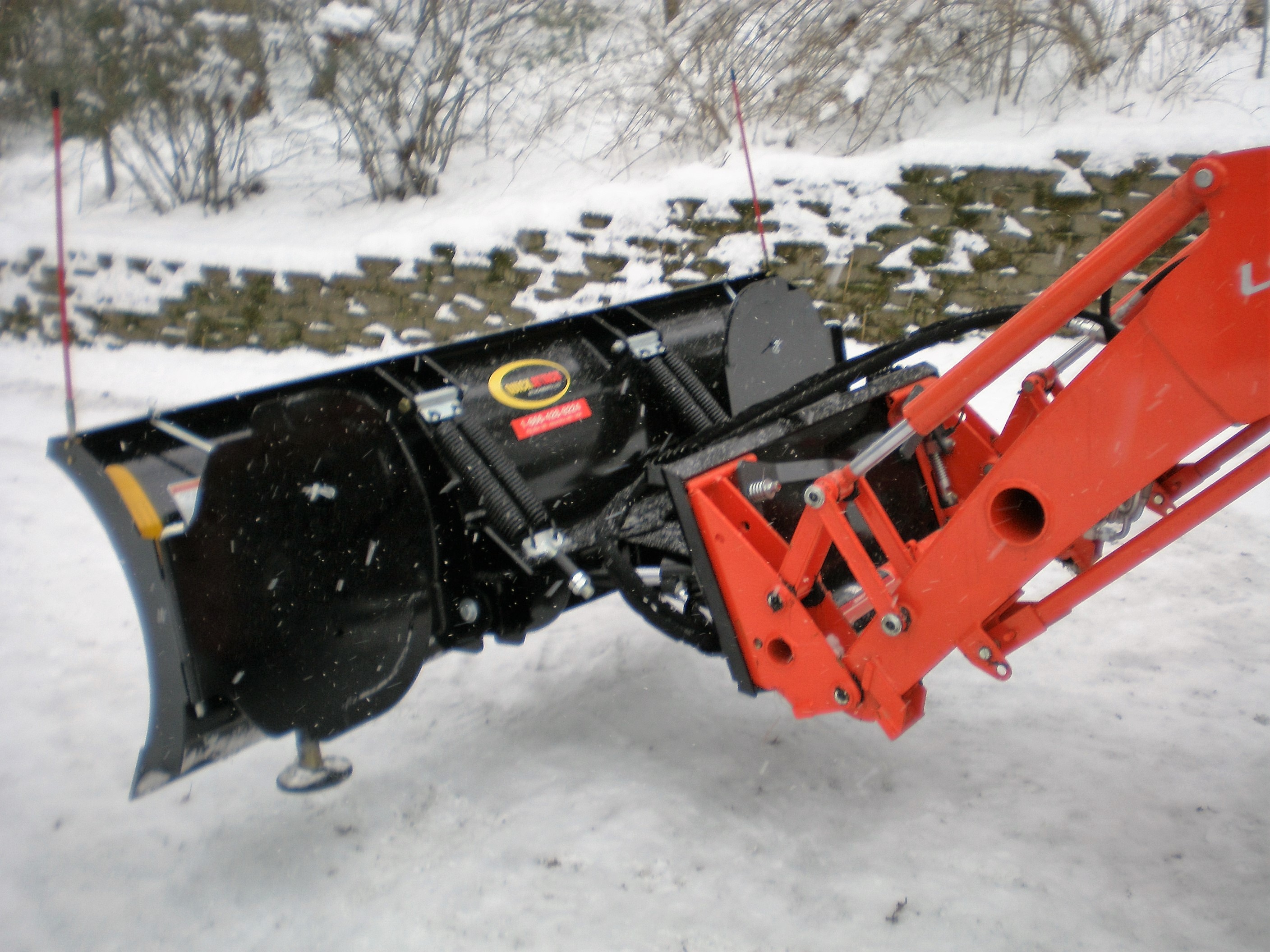

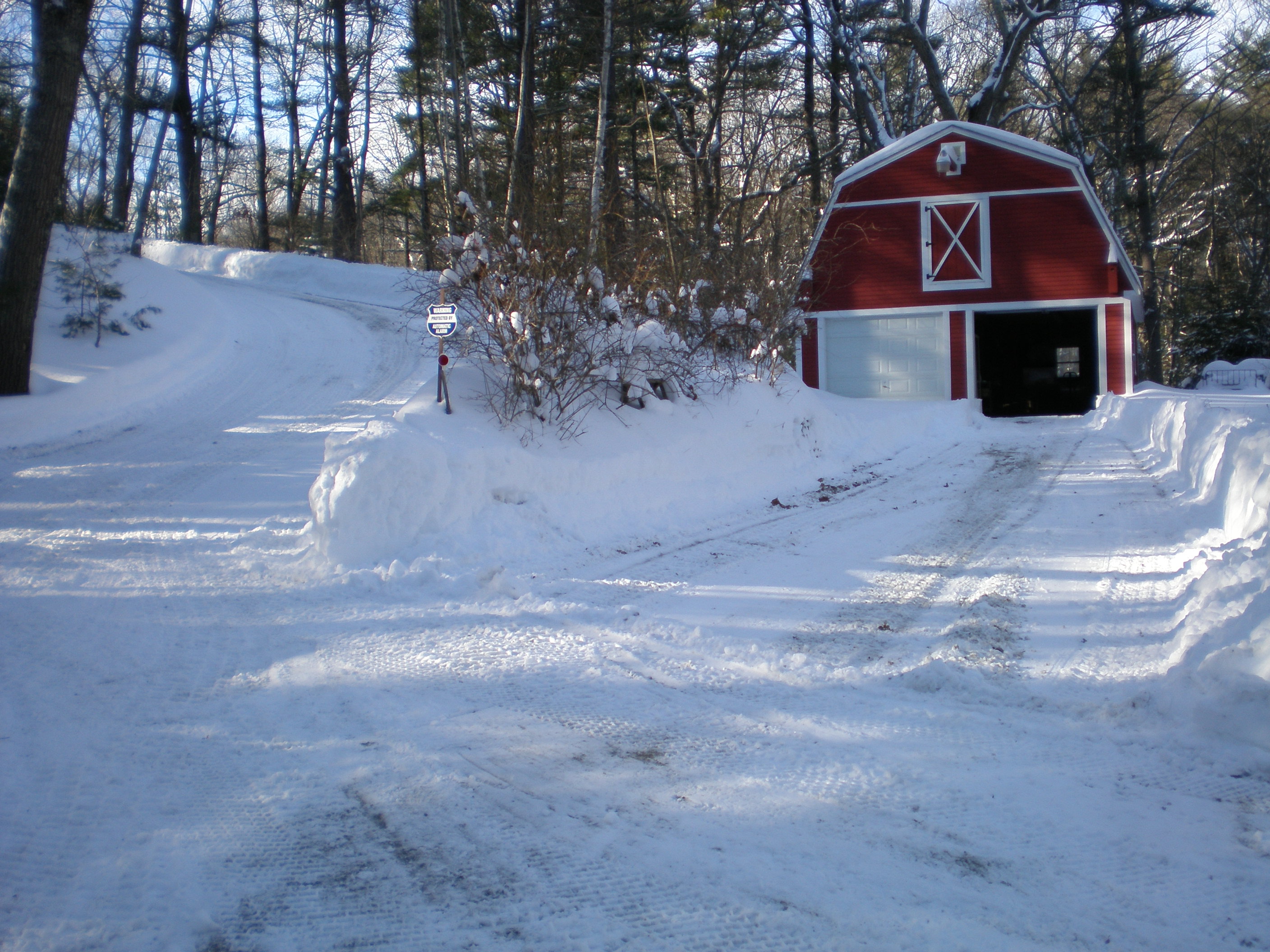

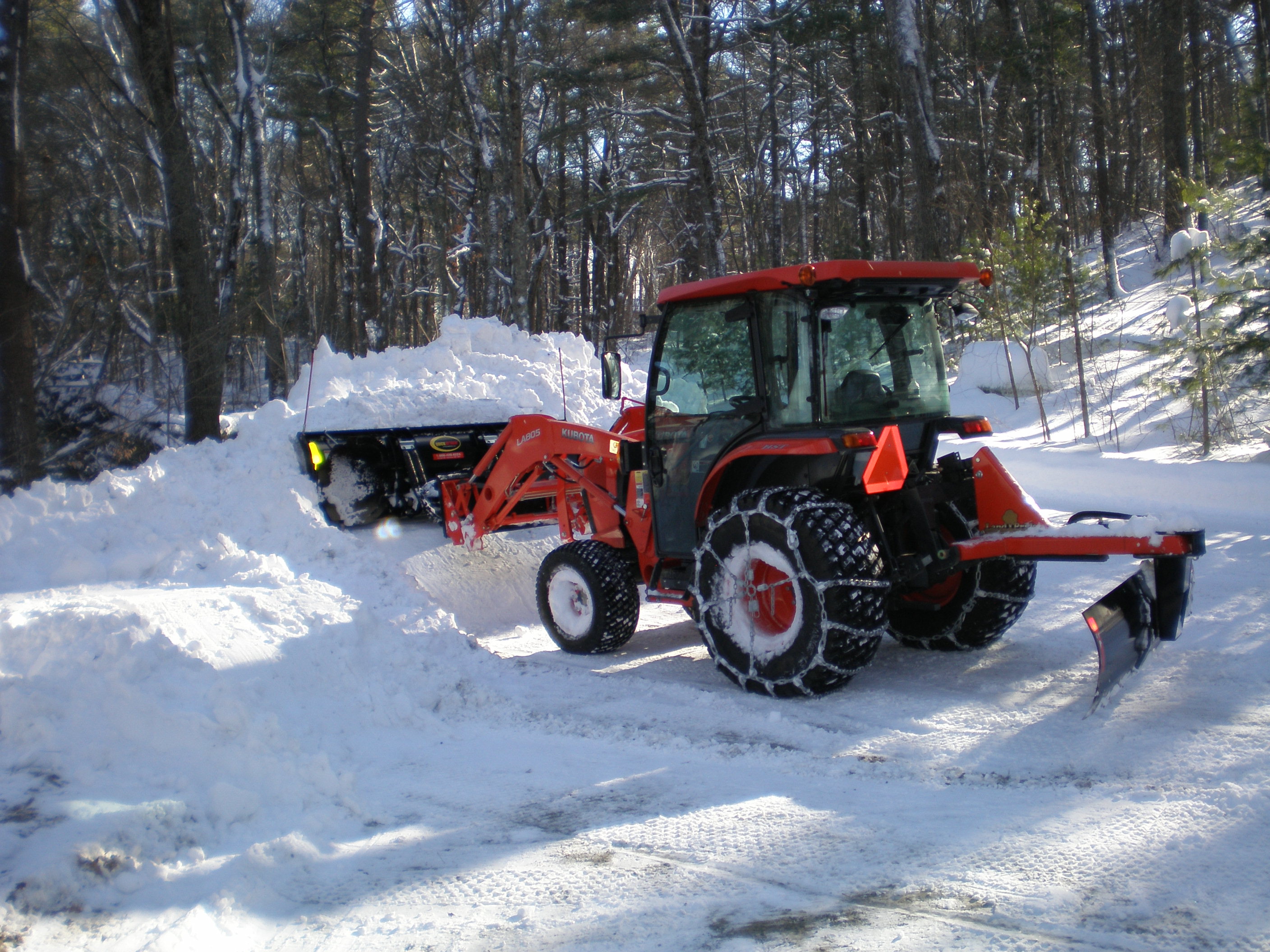

Katahdin, what kind of road do you have? I have a 1000' drive that is gravel and a big hill that curls up to the house at the end. I have a front mounted plow and rear grader as well as a sander for the tractor. My neighbor had a blower on his Bobcat and hated it and finally sold it and told me not to buy a blower, I'd be sorry, jamming up with rocks from the drive and other problems. Still thinking about it, the wife says get what I need, just want to be sure before I bite the bullet. Here's what I have now. P1280012.JPGP1280013.JPGP1260005 (4).JPGP1260001 (3).JPG

Katahdin, what kind of road do you have? I have a 1000' drive that is gravel and a big hill that curls up to the house at the end. I have a front unted plow and rear grader as well as a sander for the tractor. My neighbor had a blower on his Bobcat and hated it and finally sold it and told me not to buy a blower, I'd be sorry, jamming up with rocks from the drive and other problems.
My driveway is gravel and crushed concrete. To minimize scraping up the aggregate, I installed a slit-2 inch steel pipe around the cutting edge of the snow plow, and a 1.5-inch pipe around the cutting edge of the snowblower. You still get some gravel and crushed rock into the auger, but its minimal. To clean up the bits of gravel that gets shot onto the lawn I use a power broom attachment, on a husqvarna string trimmer, in the spring.
