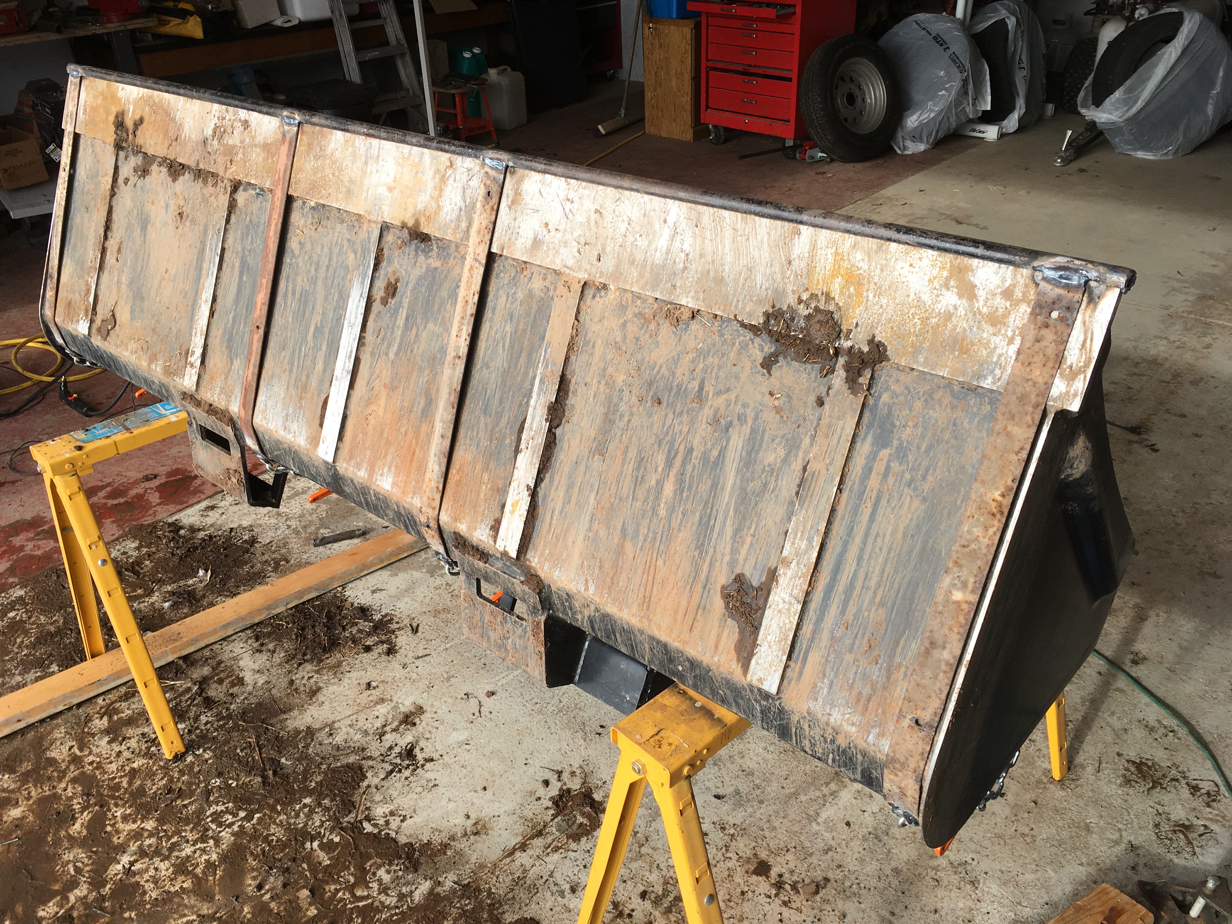

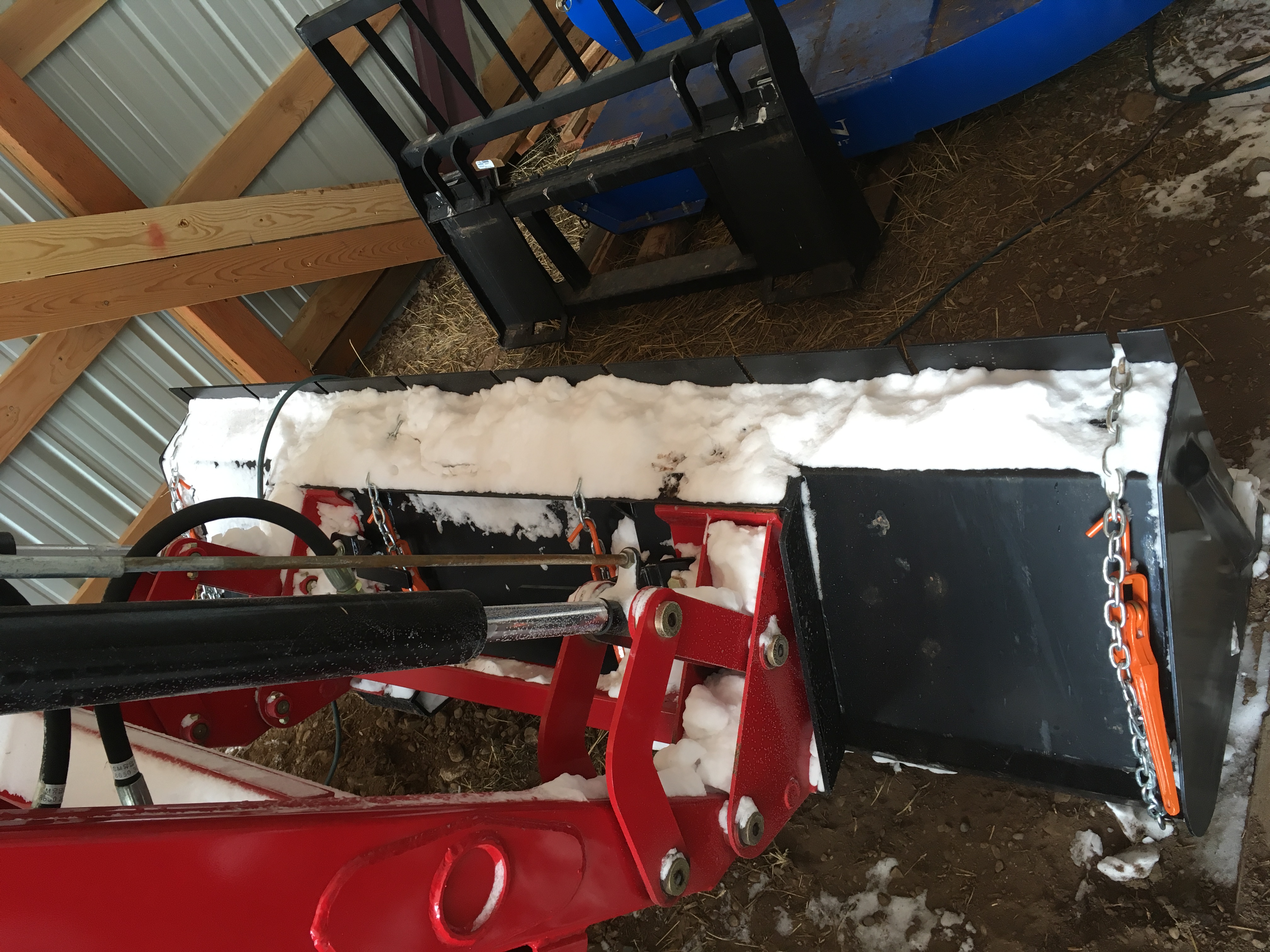

Saturday we got our first real snowfall, about 10" to 12" so it was the first time using my tractor as I just bought it last summer. Every thing worked as it should. I was especially happy with the protective edge I mounted on the bucket to protect the lawn. As others have done, I used a plasma cutter to cut out a half inch strip of pipe then welded 1/8"x1-1/2" strap underneath the bucket. Then welded chain to the straps and attached it to an angle I welded on top of the bucket. Binders are used to tighten the chains/straps and make for a quick removal of the protective edge when needed.

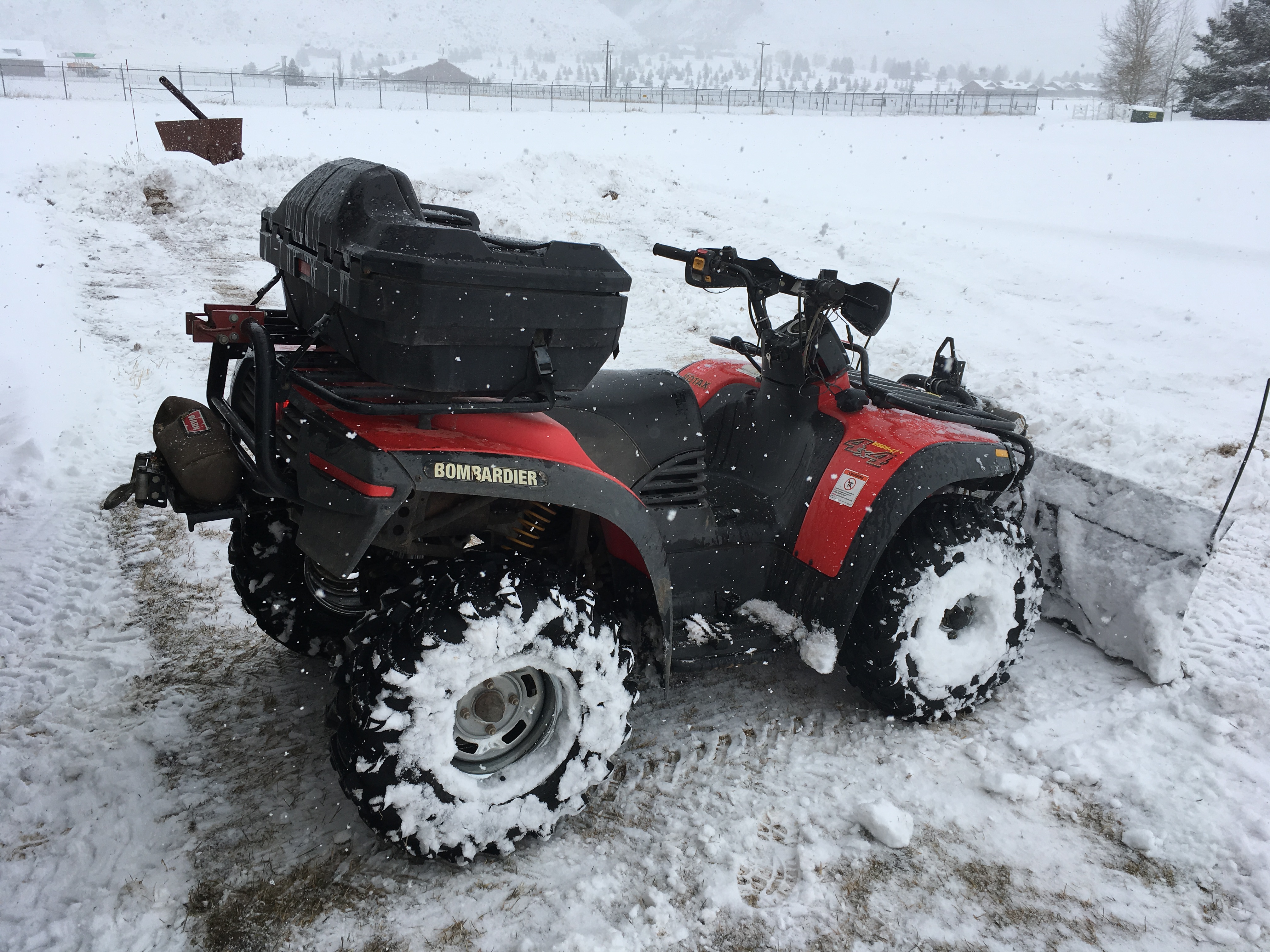

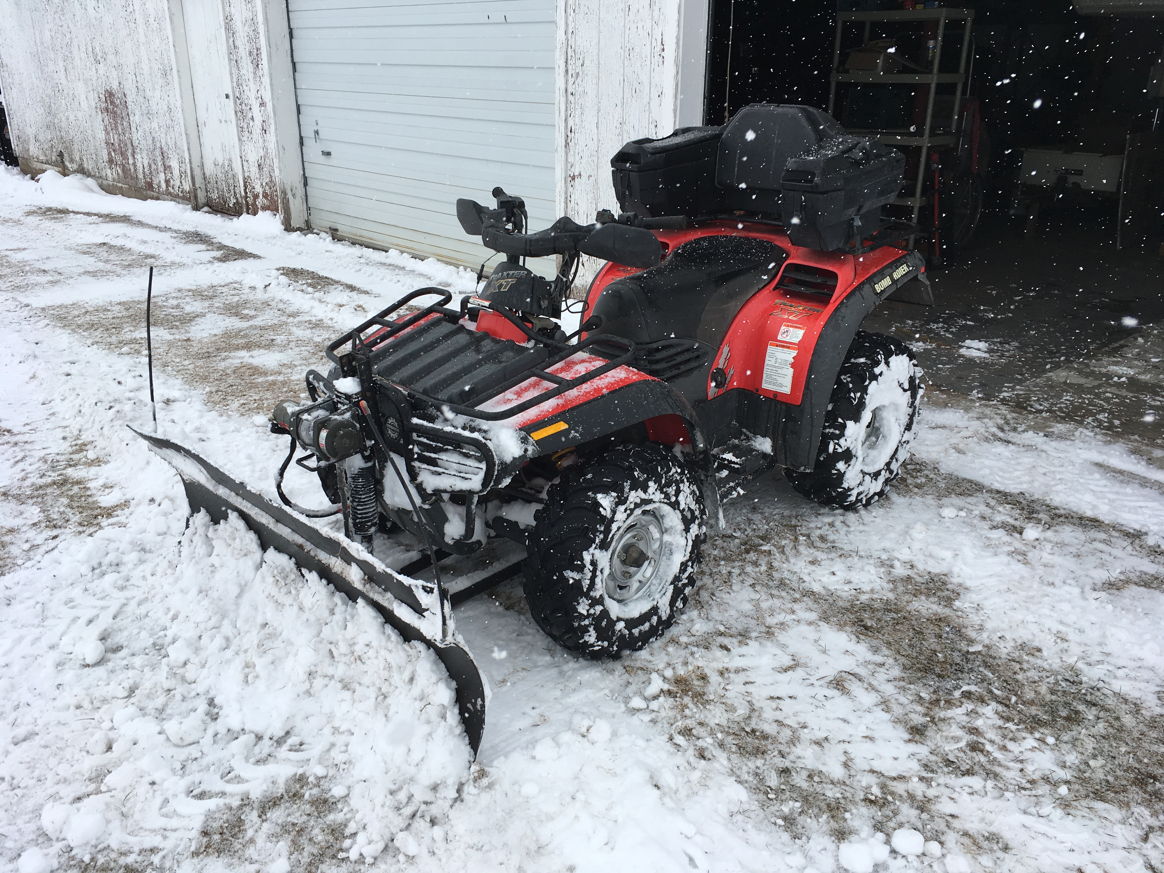

Today we got another 4" to 6" of snow but I just used the ATV to clean up around the house.
It has a down pressure system on the blade so it cuts and cleans really well. I use a Warn winch rigged with 4 lines of synthetic rope to operate the plow. The ATV also has the Warn Multi Mount system so I can have a winch on the back to pull out the ATV if I get stuck. I have had this system for 10 to 15 yrs, I couldn't even guess how much snow I have moved with it. The blade is even coated with pickup bed liner to reduce the amount of snow that sticks to it.

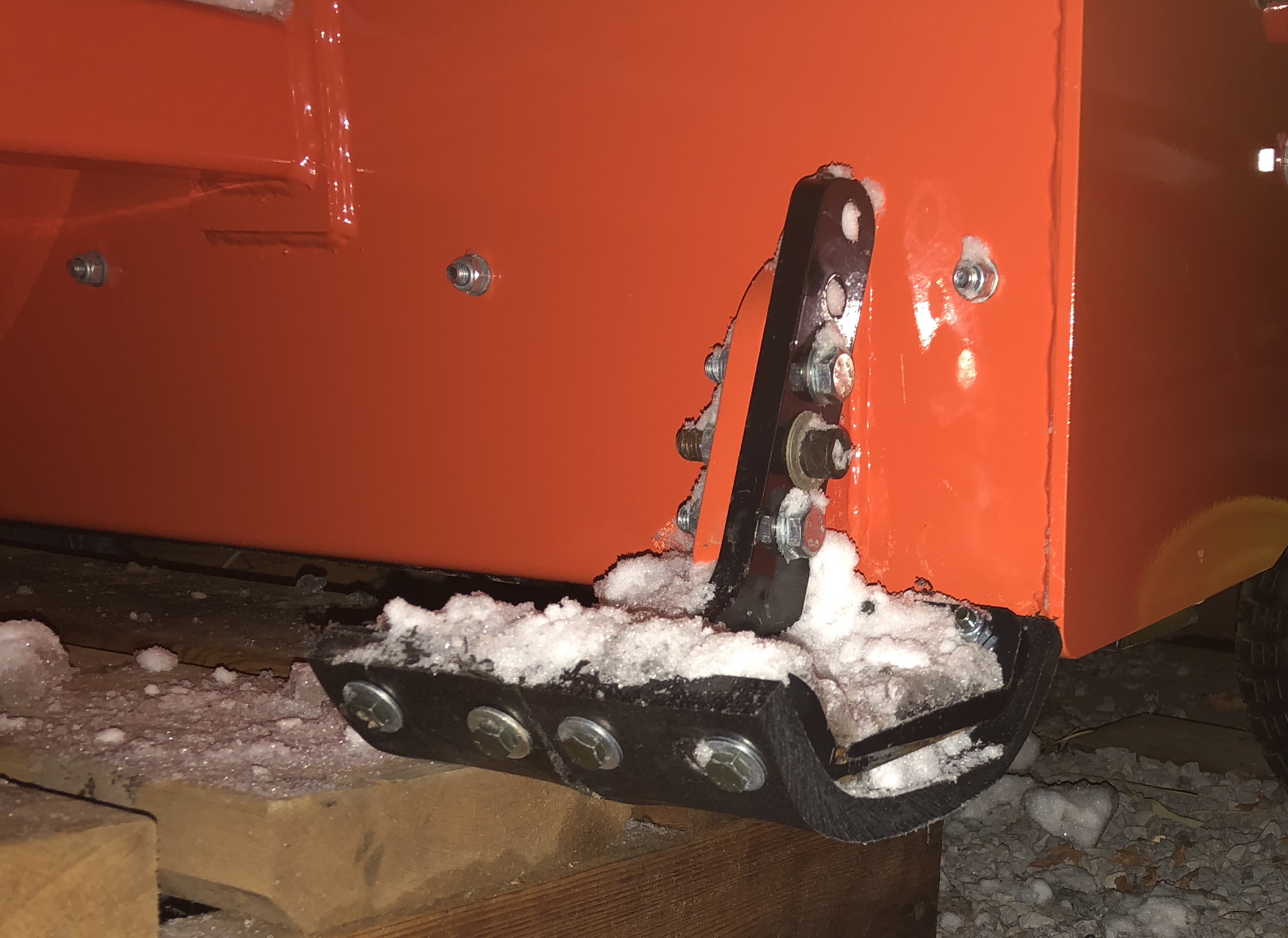

fullsizeoutput_3478.jpeg Woodmaxx new wider feet with my added 1/2" uhmw plastic added to bottom. Seems just right height for my imperfect paved / patched up driveway.
