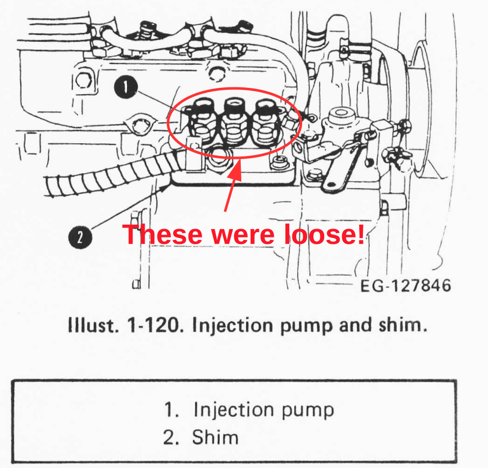

NOW, on page 1-87 of the Service Manual, it talks about adjusting the injection timing. I don't know if this has anything to do with it because I don't understand what the flywheel and shims have to do with injection timing, BUT, see the three outputs from the injection pump? These were quite LOOSE when I was disassembling the tractor -- like at least 1/2 a turn loose. Given that they are mounted on the shimmed up part, I wonder if this could be it?
If those were loose - and I am assuming that these things are the fittings that hard fuel lines to the injectors connect to (picture doesn't say) - possibly a lean condition ?
Haven't seen any pictures of the engine prior to cleaning ... any evidence of fuel leakage ?
IF, you want to get into injection timing we can help you with the understanding on how it works.
In short though, it's just when the fuel flows starts relation to the pistons travel.
What I think the man in the link was suggesting though was that the factory numbers are skewed for one reason or another.

Only if they were leaking fuel.
I don't think it was leaking fuel. Seems like I would have noticed that as much as I have had the hood open while it was running.
OK. Work with me for a sec:
So if you add shims to adjust the injection timing, then the whole Delivery Valve Holder (part 1) will move up because the Delivery Valve Holder screws into the shimmed up mounting plate. The shims are on the order of .005". If the Delivery Valve Holder were loose about half a turn, would that be like adding a few shims?
It sounds like there is a cam underneath there somewhere and the shim changes the position on the cam where the injector fires.

   / Anything else to do when changing a head gasket? #76
If there was enough fuel leaking to ****** the timing......believe me you'd know.
When everything is working what comes out of the pump to the injectors is actually a fairly large volume compared to the area it displaces. If that makes any sense.
The injectors open at a high psi, the pump provides that pressure with volume....not pressure per se.
Yes you have a handle on how the timing is set, with shimming of the pump.
Add shims you ****** the timing. Remove shims you advance the timing. OR if you'd rather phrase another way, move the pump away from the cam it pumps later. OR move the pump closer to the cam it pumps sooner.

Not necessarily gonna mess with timing at this point. I was mostly curious if part of the problem might have been those very loose delivery valve holders.

Stress cracks could be considered normal in the pre-combustion chambers which is likely what he was seeing.
Delivery valves being half a turn loose. I'm surpised it would run at all.
The injection timing is likely retarded Kubota cheats toward the retarded side in their spec. from the factory. I typically remove as much as .008" shim to put the snap back in the throttle response and to put it back into spec.
