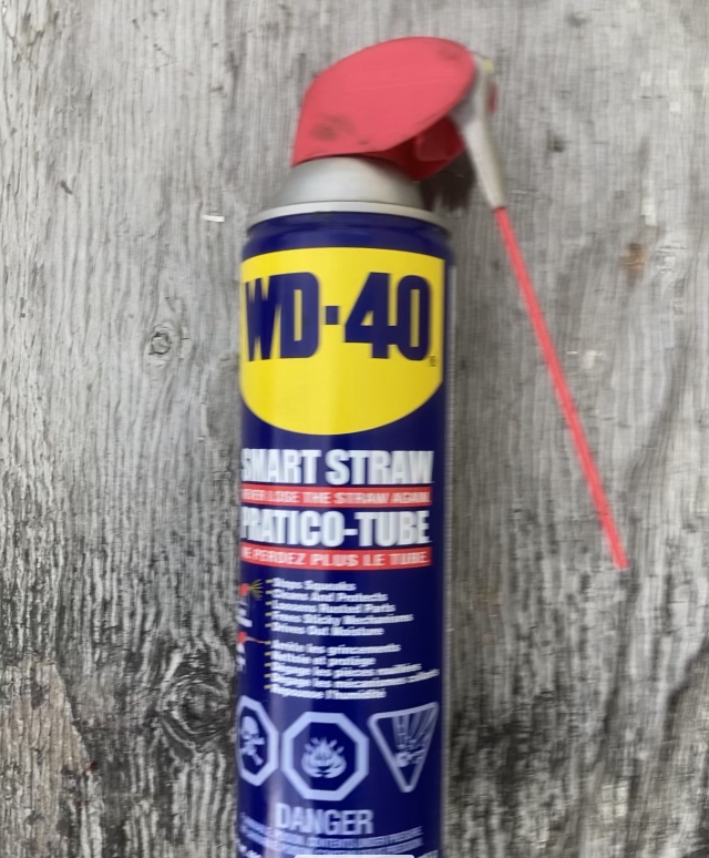

Frikkin' annoying when an aerosol can quits with a bunch of contents still in there. It happens with paint, lubricants, just about anything else. Not picking on WD-40 but there's still 2/3 left in this can. Any fixes?

That design nozzle has to be all the way up or down. With it all the way down the product bypasses the little tube and comes out at the head.
In the position you have it in the photo it blocks the product from coming out.
