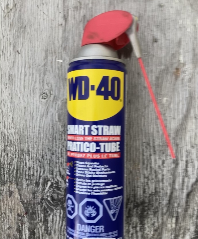

Frikkin' annoying when an aerosol can quits with a bunch of contents still in there. It happens with paint, lubricants, just about anything else. Not picking on WD-40 but there's still 2/3 left in this can. Any fixes?

I tried the method I saw on you tube, the one with tire valve stem, they said you could put 80 psi in the can. As I was holding air chuck, I was imagining this thing blowing up in my face.
As I was filling it I kept checking with gauge, chickened out at 60 psi, did get the rest of product out of can and have used this method on several cans, just needs the male end on can.
