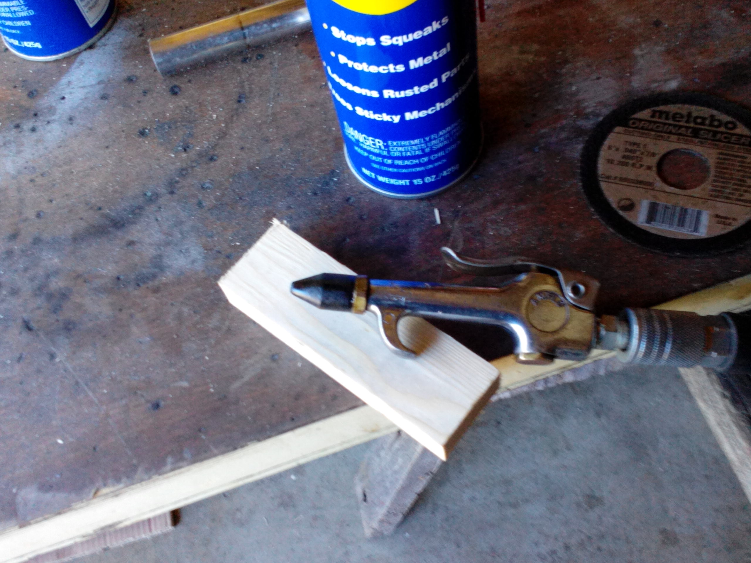

I had a new can of WD that did that, I fixed it by holding down the nozzle and blowing into it with a rubber tip nozzle. It works on some paint cans that have a clot in the pickup tube as well.
