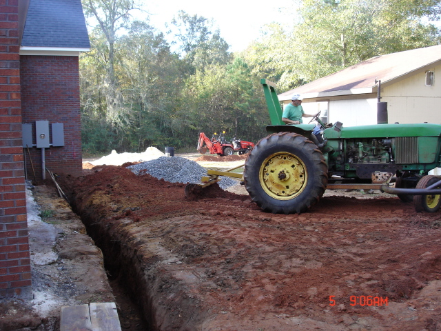

Here are the options from best to worst.
  • 1. Gravel with drain tile and drainage pipe away from house
  • 2. Backfill with clay
  • 3. Backfill with gravel without drain tile and drainage pipe
Additionally, I could apply a non-permeable membrane over the backfill to shed water away from the house. This membrane could be used with either of the 3 options above.
I don't think there's much question about which solution would do the best job. What I see as the question that needs to be answered is "How good is good enough?" Building a house is filled with decisions regarding money, time, effort, and trouble. If I chose the idealistic option for every issue, this house would cost a million dollars to build and would take forever to finish.
For me, Option 3 is out of the question because like Pops and Eddie mentioned, it will keep the footers wet. My guess is that it would be extremely rare in my area to find a house built by a GC that uses Option 1 around the main floor garage or the main floor of a house without a basement unless the grade of the lot runs toward that part of the house. And I'd be surprised if 1 out of 100 houses in this area have a membrane installed on grade around the house.
The question cannot be reasonably answered without considering the natural grade of the land where the house sits. The house sits along a ridge line. The natural grade steeply slopes away from the house in almost every direction. The house is naturally protected from water.
Obed
You're right. Building a house is full of decisions. Nearly all of those decisions will involve a compromise of some sort. Clay is "good enough" for backfilling around your garage given the lay of the land. If you were talking about a basement at the bottom of the slope then we'd be looking for a better solution.
Obed
Option 1, is the way to go. I have always tied the garage drain into the full basement drain tile.
How hard would it be to dig down to the footers, install a T and run the drain?
This is one of those things that doesn't cost much and is a lot harder to fix later.

I think having bricks below grade is just giving termites a path into the framing of the house. Motor is easy for them to get through, and how they get into homes every day. The concrete footings or brick ledge needs to come above grade.
Eddie
I respectfully disagree with this statement. Concrete cannot be relied upon as a termite barrier. We all know that concrete can and will crack and the slightest crack is all that the termites need to invade. Even homes with concrete slabs have had termite infestations develop in interior walls due to cracks.
Brick veneer cannot be considered a termite or any other bug barrier. It is quite common for brick veneer to start below grade and in some homes the brick is significantly below grade because the builder misjudged the final grade.
The preferred termite barrier is either a chemical barrier using a termiticide or the relatively new termite bait system.

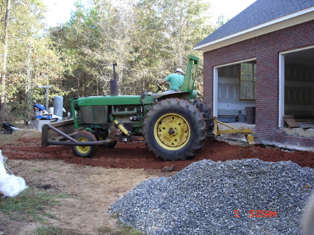

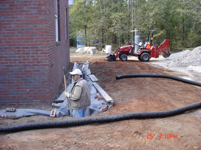

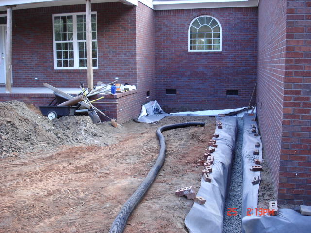

Since we all like pictures, I have attached a few to show my brother's solution to a moisture problem. Shortly after the hardwood floor was installed it started to swell and buckle. The final grade was yet to be done so some rain run off was going towards the house and if I remember correctly it was suspected that below grade moisture was migrating towards the house also. This is not the same situation as Obed's but there are some similarities; tractors, new house, garage, gravel, digging... :)
