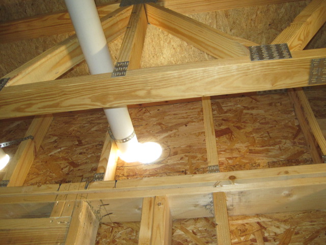

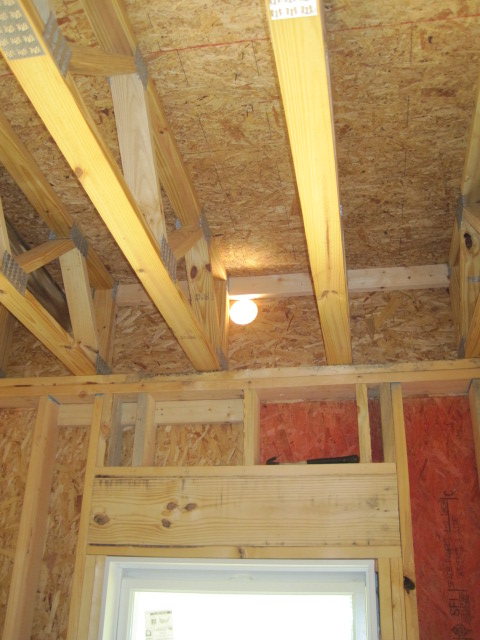

Yesterday I tinkered. It was nice to be able to do some stuff on the house without the pressure of a deadline. Brick laying may start later this week so I closed up some holes in the walls.
The first hole was intended for a master bedroom vent that we decided we didn't need. We will have a vent over the shower and one over the toilet. I decided we didn't need another vent over the claw-foot tub that will sit next to the window. We can crack that window or use the vent over the toilet.
The second hole was apparently caused by a miscalculation by the H&A guy for the gas furnace vent. I added some house wrap and window flashing tape around the white PVC vent pipes. We'll add some spray foam at some point to seal around the pipes.

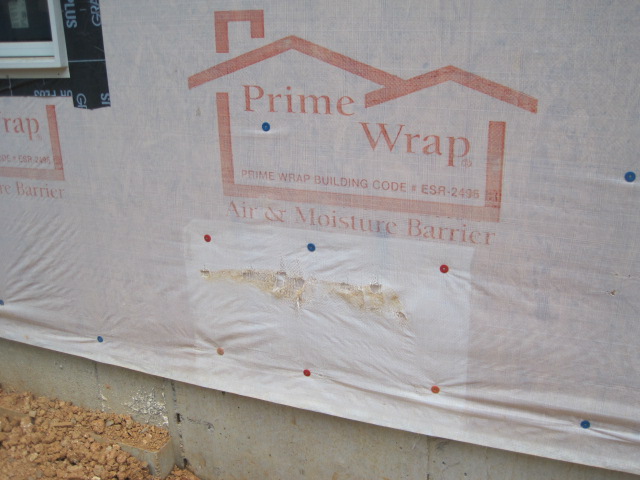

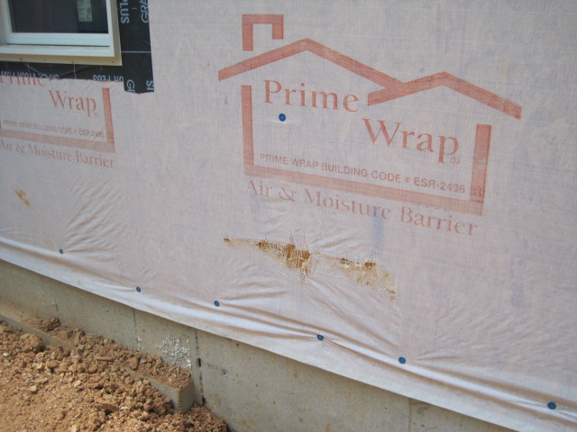

I messed up the house wrap on the front of the garage with my FEL while backfilling over the electrical conduits. It was just cosmetic, I barely touched the wall but it was enough to tear up the house wrap.
attachment.php
I found a spare piece of house wrap and patched the tear.

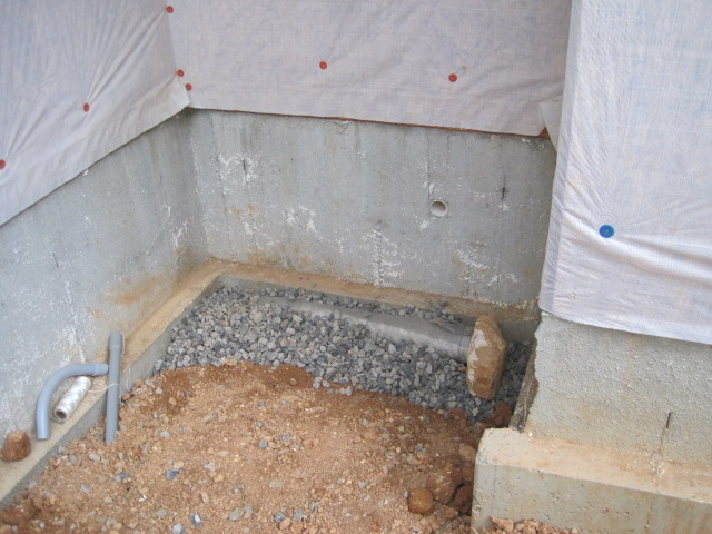

I finished backfilling the last of the area where the electrical conduits enter the house. I added some gravel under this drain tile. It will stay this way until after the phone line and gas meter are installed in this spot. Then I can finish backfilling for the final grade. I placed some scrap house wrap over this drain tile until I'm ready to cover it later.
Guess what happened while I was working on this area? Yes, it started raining again. There's just something about my working in this corner that causes rain. This time I was finishing up so it wasn't a major issue. I was ready to stop for the day anyway. I had a nice leisurely work day and was ready stop anyway.
