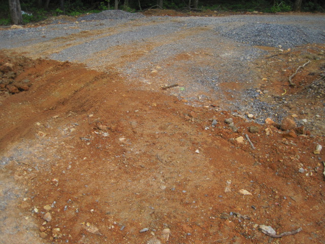

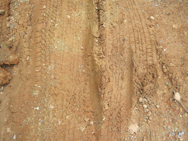

We got a soaking rain Memorial Day and Tuesday. The section of trench that crossed the driveway settled some and got real muddy causing a mess as red clay got tracked onto our parking area. I don't really want to put gravel over the trench until it finishes settling but I also don't want more red clay deposited on our parking area. Just one little clump of wet red clay sticking to your shoe soles is not much fun. Unless you've experienced what I'm describing, you can't really appreciate the situation.

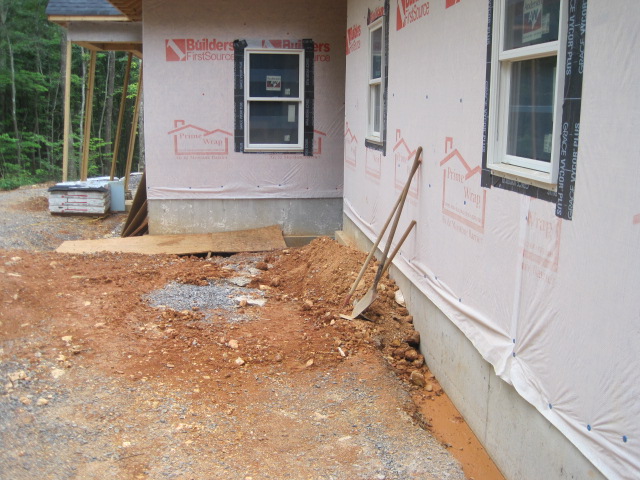

Wednesday evening I covered more of the trench. Like before, a lot of it had to be done by hand to prevent rocks from damaging the conduit.

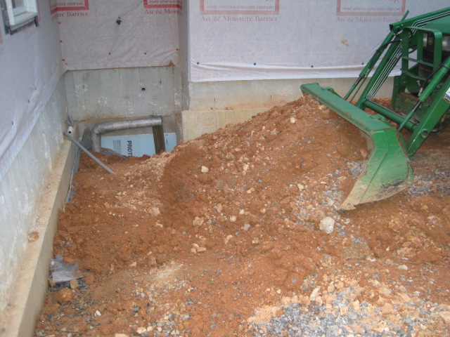

Thursday evening I filled with dirt the area where the conduit enters the house.

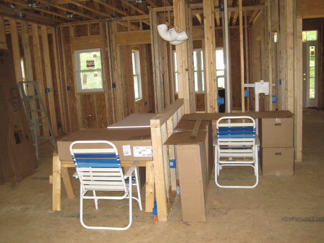

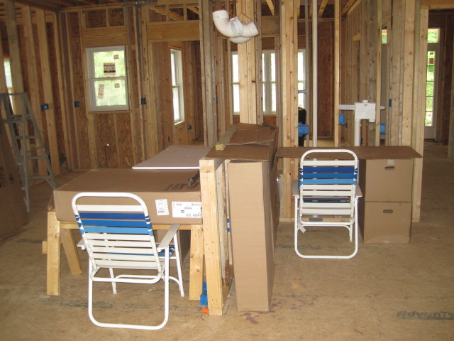

The wife is trying to figure out how to make a built-in desk in the great room that will look good.
attachment.php
She set up boxes to simulate the kitchen counter and bar at the end (left side of half height wall) and the desk on the right side.
attachment.php
The pvc 90 degree joints hanging up are supposed to be pendant lights.

I'm with you on the red clay blues ;).
I covered all the conduit in my trenches by hand, takes time but I had no problems.
I'd put a thin layer of gravel on the clay in the driveway. Otherwise, traffic will pump it up and you'll have a hard time getting it packed down again. Also keeps from muddying up the rest of the driveway.
When you get the conduit area covered, you could put some plastic down until gutters are up and final grade from the house is correct.
Good deal on trying the desk. We did that on our 1st house, and bumped out an eat in area after seeing it was too small. If you haven't already done so, it's a good time to make sure that beds and end tables will fit where you think they will. I also went around the house and with a line of spray paint on the floor marked where the door will swing. This helped me visualize the layout of the room and possible furniture placement. It also helps when it's time to place the door order by cutting down on communications problems.
Some of the furniture placement will affect where you put outlets, phone and ethernet.
