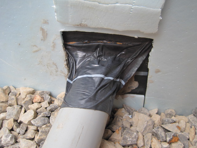

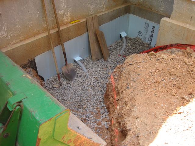

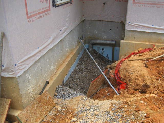

We worked on covering up the area where the conduit enters the basement wall. If you remember, there is a drain tile below where the conduit enters the wall. I used some hydraulic cement to fill the gap between the conduit the holes through the basement wall. The wife installed the styrofoam and put some window flashing above the conduit to help prevent water from entering the basement. We covered the gravel with landscape fabric. When I started putting dirt over the fabric, it started raining so I had to stop. We covered the area with scrap house wrap and sheathing to protect the area until I can finish filling in the area.

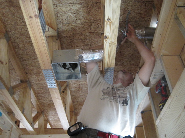

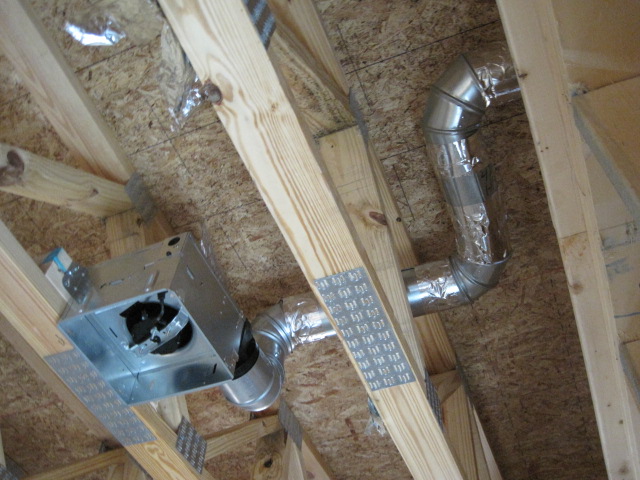

My wife didn't like how the hall bath fan was installed.
attachment.php
See how the duct work snakes around. Each 90 degree turn is equivalent to adding 15 ft of length to the duct work in terms of inhibiting air flow and movement of moisture through the ducting. This short run has 4 90 degree turns. That reduces the efficiency of the fan equal to adding an additional 60feet of ductingf! So the wife re-installed the fan. I cut and installed the blocking and installed one of the duct hangers that my wife had a tough time reaching.
attachment.php
Here's the result of my wife's efforts.

   / At Home In The Woods #1,298
Nice job on straightening out the duct work, but why didn't you just replace it with flex line? It's insulated and you can bend it to fit anywhere, or go as wide and gradual as you have the space for in your turns.
Eddie
   / At Home In The Woods #1,300
Fan looks a lot better, amazing what 'solutions' people who don't care will come up with. Not only will the first way be inefficient but each 90 costs a few bucks too.
I like the hard line when possible, it stays cleaner over the years and will hold up to construction hazards better.
