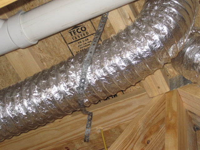

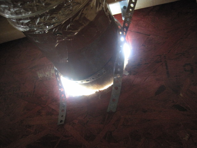

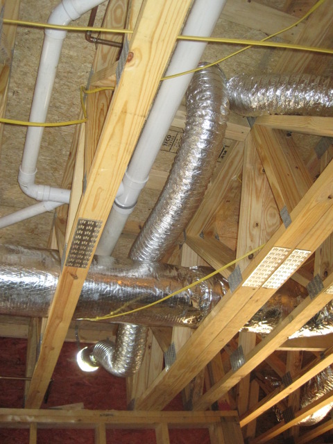

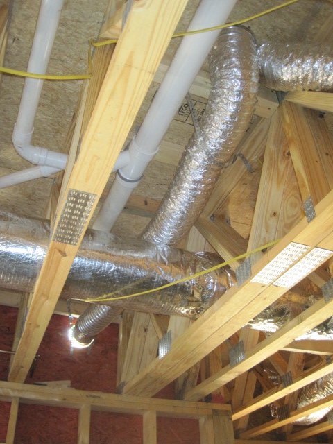

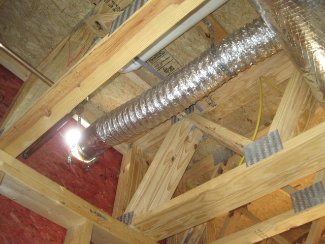

Yesterday I "improved" the duct run that supplies combustion air to the fireplace.
attachment.php
Before
attachment.php
After
The solid duct running to the outside was hanging loosely and was pointed upward toward the sky on the outside of the house. Water ran down it and collected in the low spot inside the duct.
I ran strapping above and below the solid duct where it exits the wall and screwed the duct to the strapping to help support it and give it a slope that drains to the outside. Hopefully, the brick layers will not mess up the slope to the outside when they lay the brick. I added some strapping here and here to help straighten the ductwork.

Make sure your duct extend sout far enough outside to allow the louvered downturnfitting with bug screen to be attached to it after the brickwork
