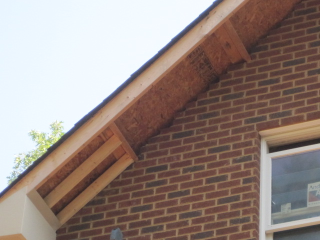

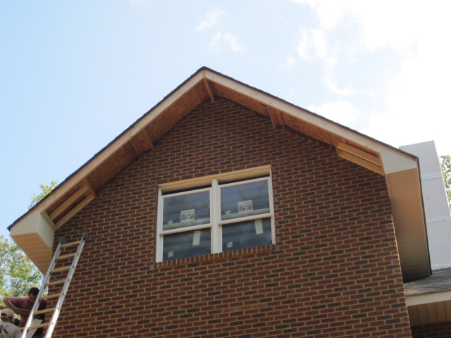

The triangle area above the beam at the end of the porch has been closed in with sheathing and vinyl siding like I described yesterday. Most of the soffits have been completed. One of the pictures shows the framing the vinyl installers added before attaching the soffits. The roof overhang is 2 feet. With the added framing for the soffits, each soffit can be nailed at each end and in the middle. Sagging should not be an issue. Also, no vinyl will be nailed into the brick. We believe vinyl will be completed tomorrow. Guttering will be installed tomorrow. Drywall installation is scheduled for next week.
