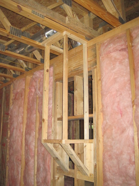

Here's a late change the wife made. If you look up in ceiling trusses, you can see the duct for the range hood that vents to the outside. Originally, it was planned that the vertical portion of the duct that runs from the range vent to the ceiling trusses would pass through the cabinets over the range hood. Well, the wife decided she wanted to reclaim for kitchen storage use the cabinet space above the range hood. So instead of running through the cabinets, the vertical portion of the duct will run through this newly framed duct space in the garage. This picture shows the same area from the kitchen side of the wall.

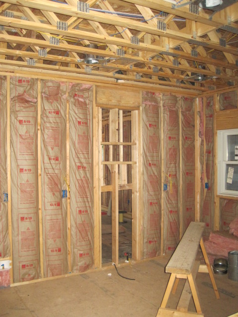

Drywall got delivered yesterday. Due to the corrosive Chinese drywall problems, we got a signed statement from our drywall supplier that the drywall was not made in China. The drywall came in 12 foot long sheets. The large flatbed truck that delivered the materials is pretty impressive with the attached crane they use to unload the drywall.
Today the drywall workers installed all the drywall. I'll have to post pictures later. Almost all the drywall pieces are attached using only screws; very few pieces have any nails in them. Tomorrow they start mudding. When I got home tonight, I picked up screws and then sprinkled sweeping compound on the floor in all the rooms and closets to help control the dust when the drywall guys start sanding the joints.

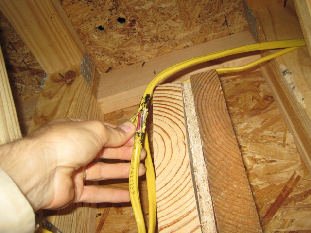

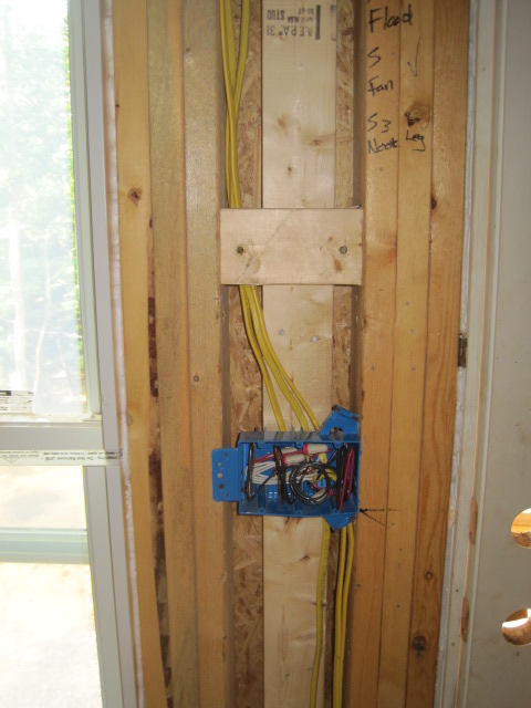

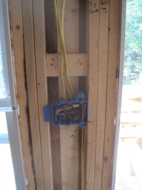

Electrical Snaffu
Last night we made last minute preparations for the drywall installation. I didn't like the way the wiring ran in front of the horizontal piece of blocking. The wire would be too close to the drywall and could be punctured if anything (picture frame, calendar, etc.) were to be nailed to that wall. Note: The blocking was added by the framer after the wiring had been run. So I re-routed the wiring behind the blocking.
While re-routing the wiring, I looked up in the ceiling and noticed a piece of electrical tape wrapped around a cable. I get suspicious anytime I see electrical tape on a piece of cable. So I thought I better have a look and find out why the cable had electrical tape on it. I removed the electrical tape and saw that the yellow outer sheathing had a gash in it.
attachment.php
I then observed that the insulation around the white wire was mangled for about an inch leaving the wire completely exposed. It also looked like the red wire's insulation had a nick in it. Apparently, the framers had saw-zawed the wire when they built the back porch. They covered the outer sheathing with electrical tape but did nothing to keep the damaged wires inside from shorting. This band-aid had the potential to burn down our house!
I fixed the cable by cutting it and rewiring it with wire nuts inside a junction box. Last night was the last chance I could have seen this problem because drywall covered it today. I've extremely thankful that I saw this issue.
