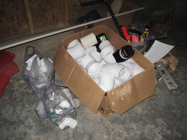

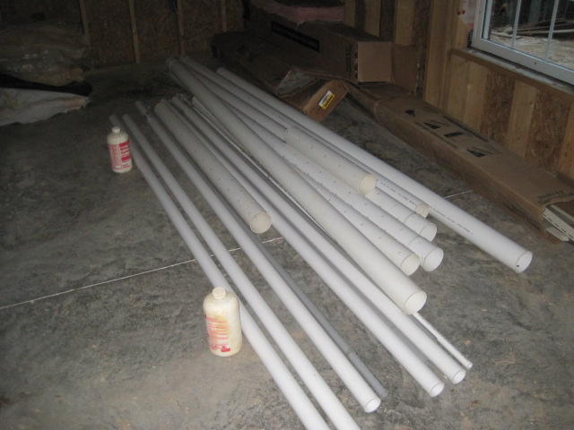

Monday evening I attached temporary drain pipes to all the new downspouts around the house in order to route away from the house the rainwater from the roof. This evening I took an inventory of the 4" drain pipe materials that I have and figured out the materials we still need to purchase. We will need 440 feet of drain pipes to run the water from the gutters and foundation drain tiles away from the house.
I'm using the solid piping instead of the black flexible piping. The solid piping is much harder to work with but I figure that the smooth pipes are less likely to clog up with leaf debris than the corrogated black flexible piping.
Tomorrow the wife is going to make a materials run so that I have plenty to do over Labor Day weekend. I live to dig.

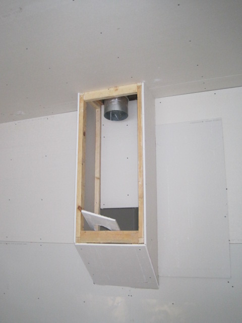

Here's the range hood duct "chimney" in the garage the wife wanted that I described here. The drywall has been left off of one side in order to enable the H&A guy to finish running the duct to the range hood. The opening will be closed up with drywall after the duct has been installed.

You are right. If you are just moving water along a pipe (especially straight lines), use solid stuff. In case you aren't aware of it, there are thinner/cheaper grade for this as it doesn't hold any pressure. But I suspect you already know this...
