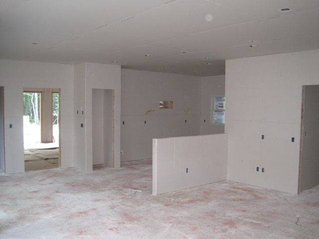

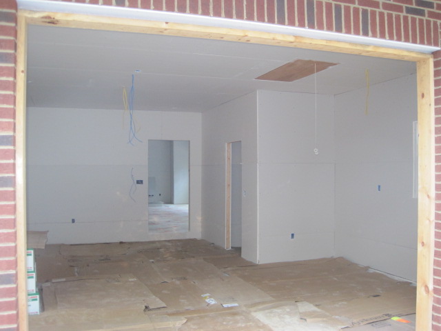

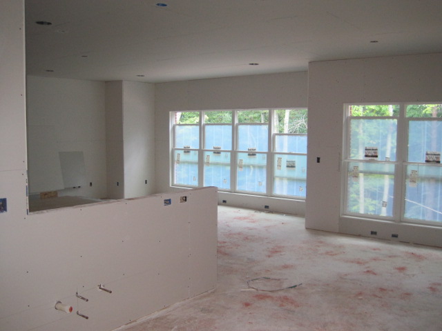

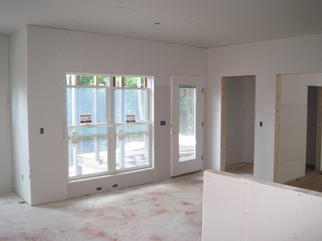

#1,818
All the drywall got hung yesterday (all in one day). There was a crew of 8 to 10 men hanging the drywall. The brownish red stuff on the floors is the sweeping compound that I sprinkled on the floor yesterday evening to control the dust. The sweeping compound is basically sawdust with an oily substance mixed. Dry dust will stick to the sweeping compound instead of floating in the air.

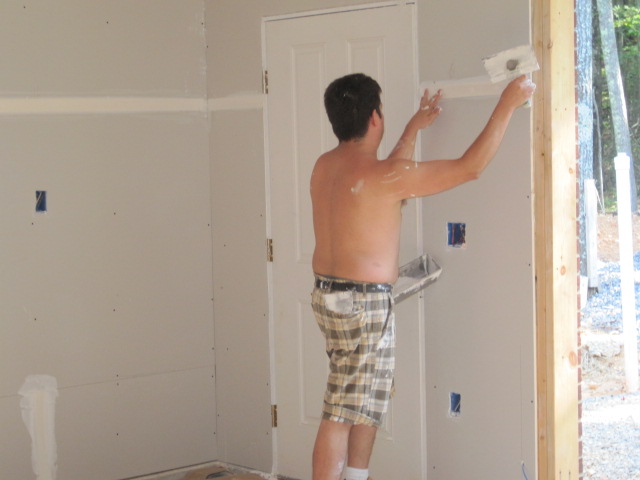

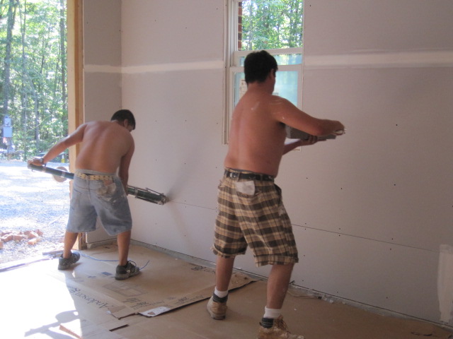

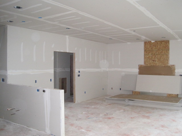

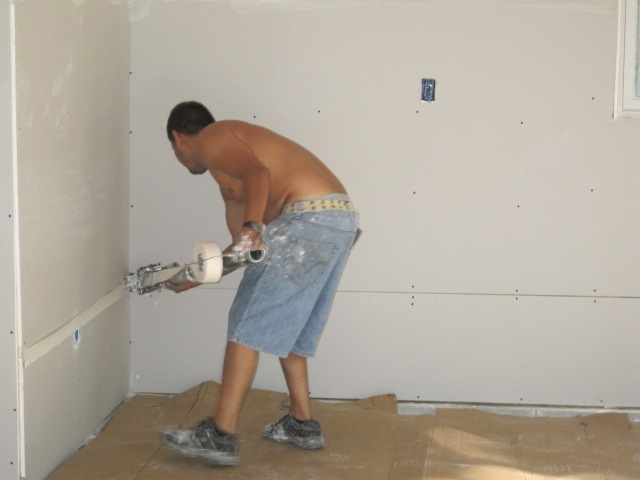

#1,819
Today, the drywall subcontractor and his brother taped and mudded all the seams between the drywall pieces. The corners and beads were not taped and mudded. To apply the drywall tape, they used an impressive piece of equipment that rolled the tape onto the wall with mud on both sides of the tape. One person applied the mud and tape and the other person smoothed the mud with a blade. It took them under 4 hours to mud all the seams (excuding corners) in our 2100 square foot house plus 750 SF garage.
