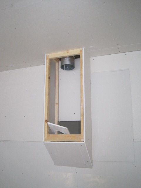

Here's the range hood duct "chimney" in the garage the wife wanted that I described here. The drywall has been left off of one side in order to enable the H&A guy to finish running the duct to the range hood. The opening will be closed up with drywall after the duct has been installed.

I think I would skip the drywall and make up a wood panel and have your trim guy finish it out. May come in handy down the road for access.
Chris
Tearing out drywall really isn't that bad - especially small areas like this. Too many people think of it as harder than it is. If you need access, rip out the piece and then patch it up. It isn't that hard or expensive to do. Also this seems like an area where you will rarely, if ever, need access. Removable panels are great for things you need to get to frequently. I doubt this is one of those places as it should be nothing more than a sealed air duct. Plus being a wall between the house and garage, the code guys may require 5/8 type X drywall anyway.
Chris
It will likely need to be fire rated -- easy to do with sheet rock, expensive if you want a fire rated access panel.
And as mentioned just rip the rock out if needed in the future

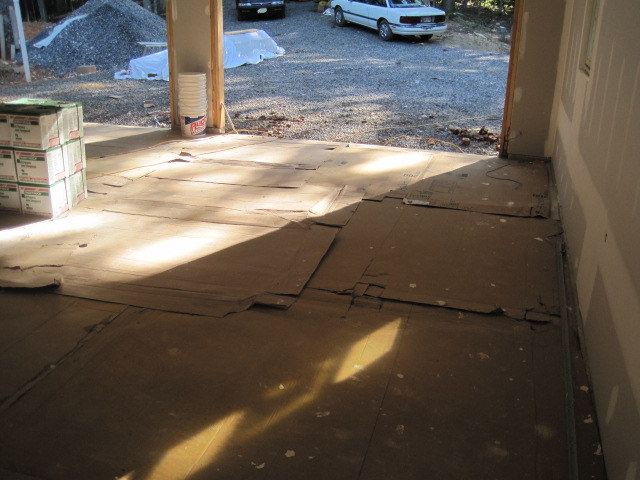

The wife covered the entire garage floor with cardboard to keep the drywall mud from landing on it.

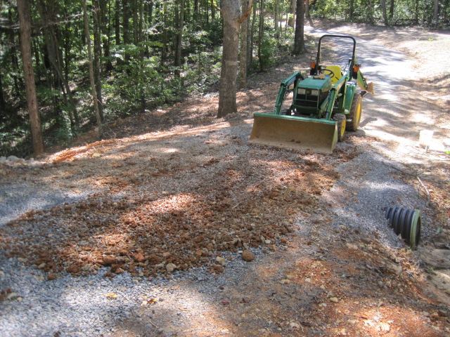

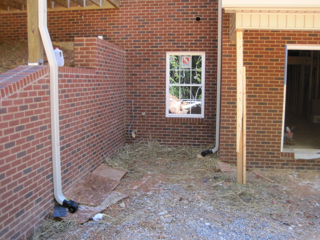

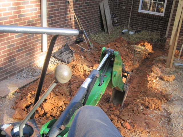

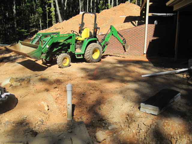

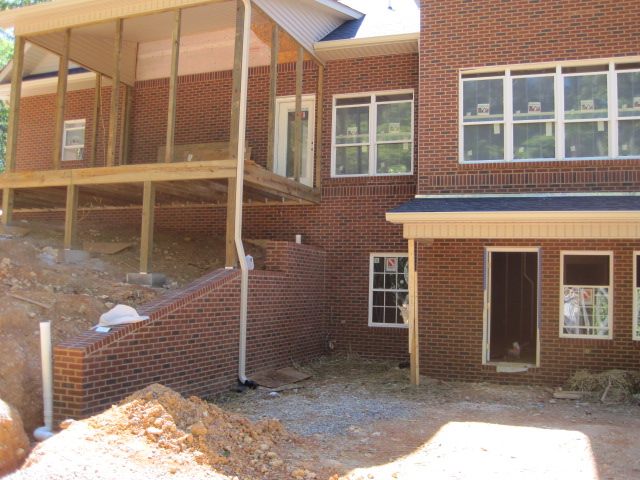

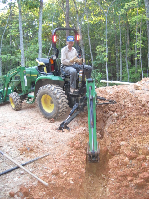

Today I worked on installing the drain pipes for the gutters in the area between the retaining wall and the basement porch.
I first removed the temporary pipes that run along the top of the ground. Then I removed 4 FEL loads of gravel from this spot and dumped them on the driveway over the culvert where the height of the gravel over the culvert has settled and gotten a little low.

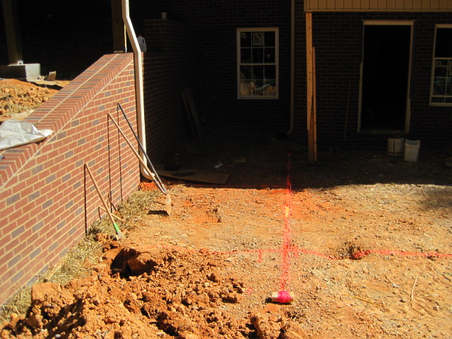

After removing the gravel, I painted lines on the ground to mark where to dig the trenches for the drain pipes.

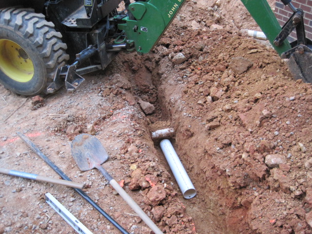

Running the drain pipes in this area is not entirely straight forward. The septic line for the camper runs between the retaining wall and the camper. You can see in this picture the septic line cleanout sticking up beside the septic tank. If you look closely, you can see the orange line that I painted that runs from the cleanout to the retaining wall and marks where the septic pipe runs. The gutter drain pipes that I am installing need to cross the septic pipe and will have to go underneath the septic pipe.
On of the drain pipes needed to 12 inches in 16 feet (.75 inches/foot) in order to cross below the septic pipe. So I used my level to approximate .75/inches per foot drop. However, I didn't do something right because when I reached the septic pipe, my trench for the drain pipe was too shallow. So I started digging the trench deeper so my drain pipes can cross below the septic pipe. The last picture shows a scrap piece of pipe in the trench that I was using to determine if my trench was deep enough. On Monday I'll finish digging the trench deeper, install and cover the drain pipes.
My wife looked up the drywall requirements in the code book. Oddly enough, the drywall between the garage and the kitchen doesn't need to be fire rated according to the code book. The drywall in the garage ceiling needs to be fire rated. However, we installed fire rated drywall between the garage and kitched even though the code book did not require it.
