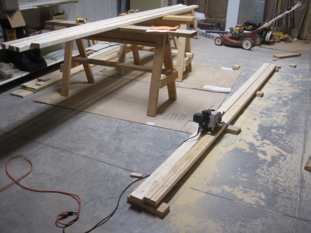

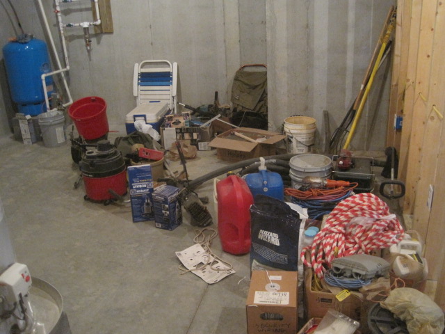

Today the weather was perfect for today's project; it was cold and rainy. We started our basement shelving project.
It was really nice to be able to have a place where we could work that was warm and dry. I've never owned a house with a basement or an attached garage before this one. I'm enjoying these new amenities.

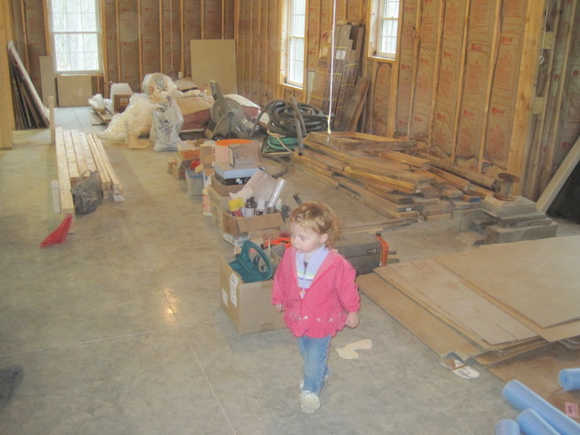

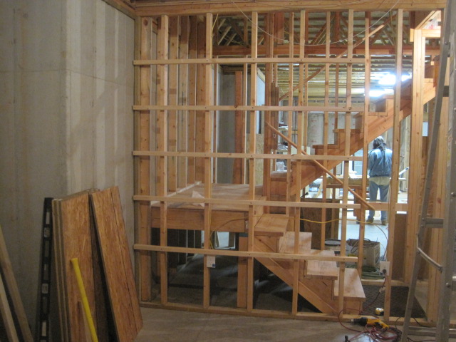

As you can see from the pictures, our basement is a mess. Shelves are needed badly. Yesterday my wife purchased supplies. We will be building two 2'x6'x7.5ft high and one 16"x4'x7.5' high shelving units. The shelving units will each have 5 shelves. We are building them using 2x4s, 2x2s, 5/8" OSB, and deck screws. Each shelf will sit on a rectangular frame made of 2x2's. Some additional 2x2s will be located under the OSB and be orientied from the back of the shelf to the front for additional support. The cost of the materials was around $150. Two of the shelving units will be located along bare studded walls so we decided to use the wall studs to frame the back sides of those units.
We will build one of the 2'x6' units first. We started by cutting the lumber to size. For the 6' wide shelves, I ripped five 12' 2x4s to be 1.75" wide and 6' long. Each shelf will sit on a box frame made of 7 2x2s (6 for the perimeter of the OSB and one in the middle running front to back). Thus I cut 35 2x2s for the five shelves. We will attach three vertical 2x4s along the front side of the shelves. Measuring and cutting all the boards took some time. An experienced carpenter would probably work 3 or 4 times as fast as I do. However, I don't mind. I'm not in a rush so I worked at my own pace and enjoyed myself (most of the time). I admit that I wasn't smiling when I cut one of the boards too short.

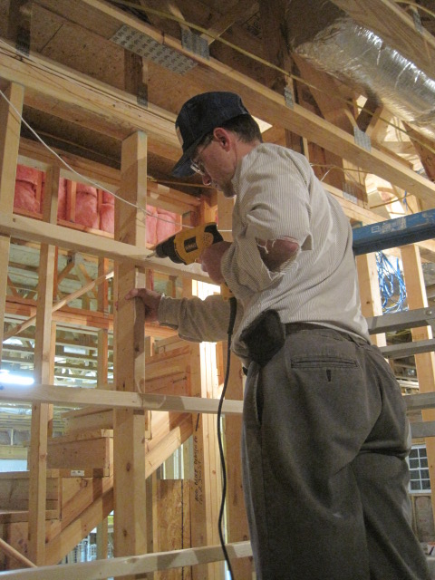

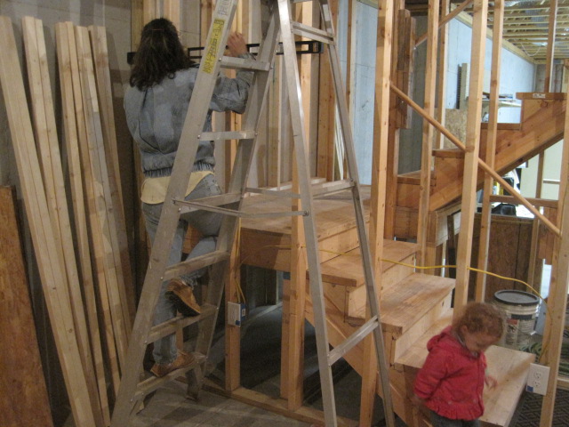

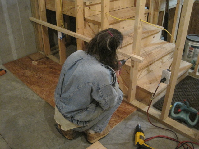

While I cut the lumber, my wife marked the wall studs where we would attach the horizontal 2x2s. After the lumber was cut, we screwed the horizontal 2x2s to the studs.
