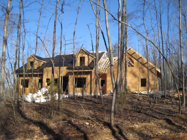

The wife has been meeting with subs. She gets me involved when there is a subject that needs my input. Yesterday the wife met with a plumber and got a bid. That's the 3rd plumbing bid we've gotten. We met with a roofer yesterday evening.
Today the wife met with the H&A company that we are leaning toward using. They found a way to run the hot water heater gas flue a way that we can live with. It requires a forced are venting hot water heater which is more expensive than the passive venting hot water heaters. This H&A sub seems to be very accommodating about where to run the ductwork and gas flues. That's important to us. We are trying to get as much stuff run inside the floor trusses as possible so we don't have to lower the basement ceiling. Ideally everything would get put inside the trusses but that is yet to be seen. The floor trusses are 9 ft above the basement floor so we have another foot available if needed and would still have an 8 ft high ceiling.
The wife also met with the brick and stone guys. The brick guy recommended that we install the back deck by bolting a ledger board on the outside of the brick and bolting it to the house framing similar to what was suggested in this thread.
We've gotten bids from 2 electricians and have one more to see.

Siding and roof would normally be the next steps. The other stuff can happen at the same time, but it's important to get the shell sealed as soon as possible.

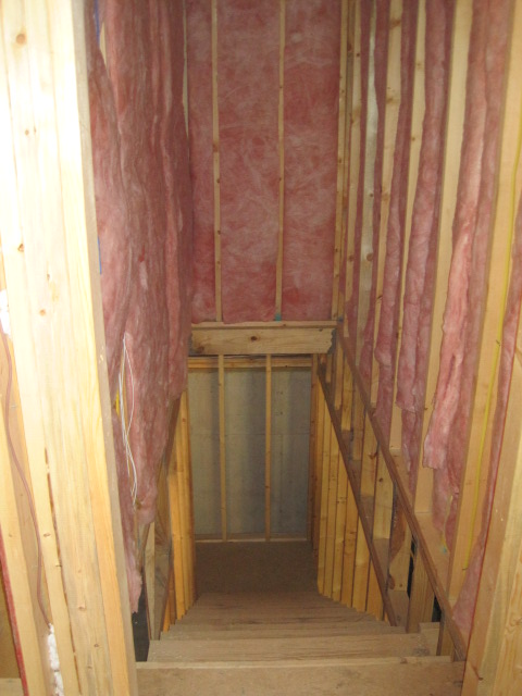

More pictures.
